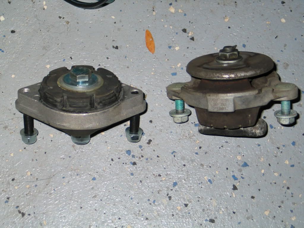

    who has installed an 034 street density transmission mount? plate or no plate?
    In the process of putting one in and noticed a height difference between the mount they sent and my OEM mount. Here are the two shown with the 034 street density mount on the left. I'm not sure if I should reuse the circular metal plate which sits between the mount and bracket.
    I found this DIY on AG which shows the install of a track density which already includes a plate to keep the overall heights the same. Of course this DIY says to not reuse the plate, however the track density already includes one.
    http://www.audigeeks.com/forums/index.php?topic=2785.0
    So I'm assuming for the street density mount you do reuse that plate? Or maybe I received a different mount?
    Thanks

    I did not swap the plate over, and I dont think it had one on there already, but its been a while since i did the install

    Its possible since there are at least three different transmissions for the B6 (early 6 speed, 5 speed, late 6 speed) that the mounts are setup a little different as well. Does the OEM setup look familiar to anyone else? I just realized I think I put the plate back on the OEM setup such that the contact surfaces are reversed, but the point is still the same. As shown the new 034 mount would cause the trans to sit a bit lower. Just trying to get some confirmation.

    I am pretty sure I did exactly what Jeff did. I recall buying new bolts per his recommendation.
    I have the street density engine and transmission mounts.
    I might be taking the trans out of my car this weekend so I can check then for you. If not, it'll be next weekend or later this month.
    -Doug

    Interesting, but the track density mount has an additional metal plate already (can be seen on the AG link) that my street mount did not come with. Looks like I should probably swap the plate over and will just try that tonight unless I hear back from someone else who remembers.

    Well, I was going by whatever I could remember. I installed it two years ago and with the work I have done to my car in those two years I can't remember a detail like the transmission mount. If I pull my trans this weekend I'll snap some photos and email them to you.
    sounds great, thanks

    I did not use the plate, I installed mine just like Jeff did in the AG writeup except that I used the studs and bolt that 034 included.
    Vibration is non-existent. I initially drove around for a few thousand miles with the 034 street density motor and trans mount, and APR snub and there was some depending on the temperature outside. Last weekend I had the front of the car on jackstands, loosened the trans, motor and snub mounts, had my housemate sit in the car and basically rev it to 2500 rpm while I tightened the trans, then motor, then snub. 100% vibration free, I honestly can't even tell the car is running when idling.
    Jon

    Alright, looks like I'll just install it as pictured and tighten the nuts while the engine is idling.

    My OEM mount did not have that metal plate FYI. 2003 1.8T quattro 5 speed.

    Ah, this might mean its specific for my early 6-speed trans (01E) and makes sense why other people haven't reported it as an issue. Thanks.
