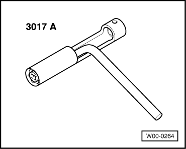

    You can make or use something similar to this:
    http://www.amazon.com/Schley-SCH8730.../dp/B002XMOVK8
    The actually factory tool is a very deep socket with an "access window" cut out to stick in a hex key wrench. Impact guns work the best imo.

    thing is i dont have the hex center threading. Mine is a weird little rectangle.
    I got the rears off, one side i got off by uncompressing the spring and ratcheting it off...had the thing blow up in me but i did it pretty safely. the other side i got it to the last couple threads but my friends air compressor was too small for my impact wrench so i just brought it to a little shop nearby where some guy spent a solid 10 minutes telling me i was gonna get hurt doing this on my own as he was struggling to figure out how those complicated auto struts come together ;).
    Found the tool im supposed to use...

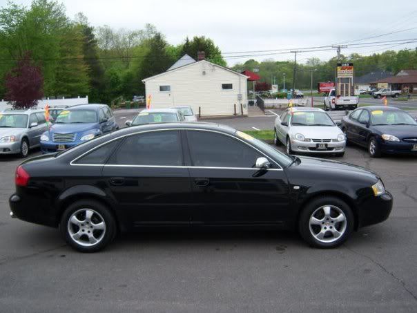

    heres a pic of the car before

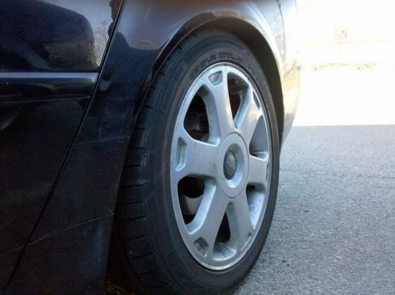

    and heres a pic of the rear after
