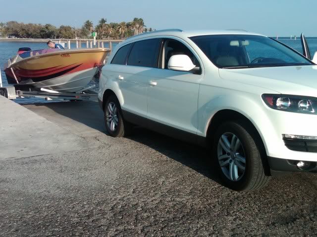

    Thanks for the reply. I was able to pull it off!!!!! Took me about 5 hours and a load of frustration but for under 25 bux I have fully functional trailer lights for brakes, indicators, and running lights. All I needed was a universal trailer light wiring kit that you can find at pep boys, autozone etc for about $12.00, a pair of relays about $6.00, and a pair of diodes for $2.00. Works 100% and I have been towing my 24' Twister Offshore to and from the ramp with NO issues at all :)
