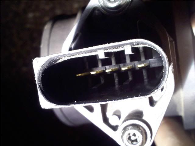

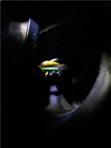

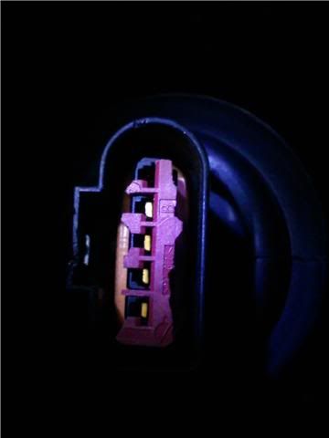

    I have been getting the the code 16487- Mass Air Flow (MAF): Signal too high. I replaced the MAF and had no luck. So I checked the wiring and it looks like this:
    only 4 connectors...
    black wire (ground?) is exposed
    5 prawns
    Is their a way to wire the black one back in there or will I have to buy a new end piece or is this normal??? Thanks for the help

    you need to reattach the broken wire. and only 4 wires is normal. the 5th wire is the non-existent intake temp sensor (because its a separate sensor).
    so your saying that black wire is supposed to be like that? I think I'm going to buy a new end piece from ecs and rewire it seeing as my clip is broken on it

    you do still need the terminal ends. the connectors come precrimped with wire. i would probably go with either the 000 979 133 or 133a. the 225 wires would be too thick.
    edit: most dealers should have them in stock. we had a whole tackle box full of wiring like that.

    So I could get the 5 Pin Flat Contact Housing and go to the dealer for the terminal ends? And the just rewire it from there right? Thanks for the help
    AWM
    GReedy Cat Back Exhaust|B&M Short Shifter|35% Tint|Forge Diverter Valve|K&N Intake|2 12" Kickers, 1000 Watt Kicker Amp|VDO Boost Gauge|GIAC Chip
    Quote Originally Posted by Fukenfast View Post
    right.

    its for 1 wire. but each wire has a pin at each end. so 1 wire makes 2 wires when you cut it in half. make sense? so if you need 5 wires total, you need quantity 3 of the part #.
    i might still have a few of them actually. ill have to check my drawer.

    Thanks Ian.
    I bought two wires (four connectors today).
    I was almost done carefully cutting my old connector apart (the bulk plastic) and my hands slipped last night. Cut right through a wire. I was SO close to not having to solder anything but just transfer the wires into the new connector (my old connector was busted but the wires were fine). Doh! Gonna be soldering tonight.
