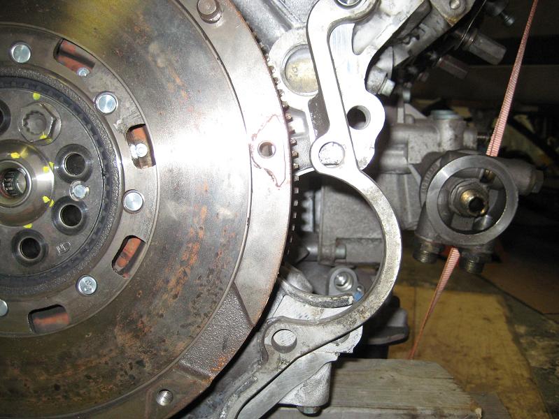

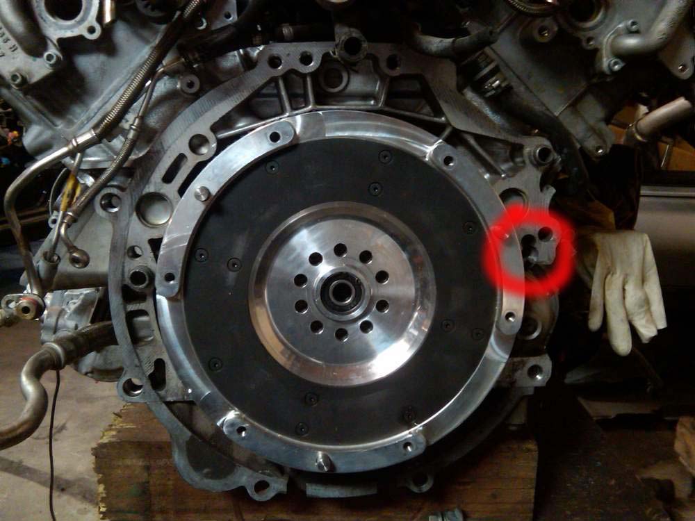

    It would appear the engine block was modified to fit the starter it is not a direct bolt up as an extra hole was drilled into the block.
    Compare the 2 images.

    Quote Originally Posted by Scotty@Advanced View Post
    As I replied on another Forum... I noted that i needed to make the hole to allow the upper part of the starter bolt to the tranny. This is not a Bad thing. or even going to affect the engine at all. When you take a car not design for manual Sometimes you have to make adjustments. this is not the first time Someone has to modified something to make is fit. when you buy Rs6 turbo for S4, you have to completely change the turbos to make them fit. No one ever says anything bad about that.
    May 16 2008
    28845
    South Texas
    Quote Originally Posted by Matt@RavenMS View Post
    As I replied on another Forum... I noted that i needed to make the hole to allow the upper part of the starter bolt to the tranny. This is not a Bad thing. or even going to affect the engine at all. No one ever says anything bad about that.
    I never said nor implied it was bad, just that term "Bolt On" was not correct.
    BTW How many bolt holes line up on the RS6 engine and S4 trans?
