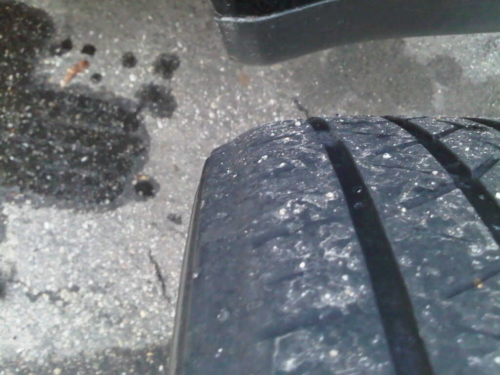

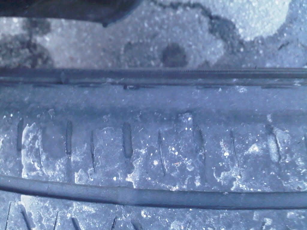

    i cant figure out what it is rubbing on. looked and i see no indication. please help. any idea would be useful at this point.

    Is this only on the fronts? How fast you take curves? Could it be the suspension? I have the same problem in my summer set.

    That does not look like rubbing to me, but more like your alignment is off or control arm bushings are worn out.

    sorry i should have explained it better. it is the front right tire. that is the ONLY tire that is wearing like that (why i think it is rubbing) sometimes when i stop i get some smoke (aka the tire burning) coming from the front right only. i looked and i couldnt see anything. i just barley replaced the upper control arms no less then 2 weeks ago.
    That's purely due to an alignment problem. My tires looked worse than that before I got my alignment done.

    sucks because i just got my damn alignment done when i lowered my car. i guess it is time for another one. good to know my spare isnt going to be rubbing or pop randomly when i head up to the mountain today. thanks man.
    EDIT: even if it is ONLY one tire, it can be an alignment issue?

    Yes.

    Yep, the alignment on that one corner is off. That's not what rubbing looks like.

    This is not rubbing, the exact same thing happened to me. One of my tires started losing air. Find a GOOD alignment specialist asap

    The tire is scrubbing on the road due to the toe setting is way off, that can overheat the tread too, thus the burned rubber smell after driving fast. Are both front ride heights the same?

    yes, they are both at the same ride height. i have not felt a lot of pulling either and since i have changed the front tire, i have not felt anything, but i still smell the rubber. i know the alignment is off so i will be getting it fixed asap.

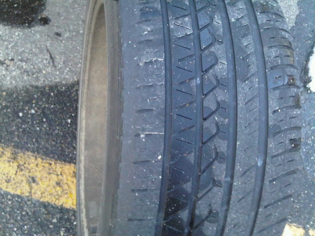

    i have been calling around trying to see where i can get an alignment done. i have found a place that will do it for 59.95 for all 4 tires. there is a catch though. they said that they will not do it if all the tires are not the same. well i have a spare on the is the same size as the rest of my tires (235/45r17) my question is, does that tire look safe to drive on or should i spend a mass amount of money to get all 4 new tires?

    i had the EXACT same problem with the EXACT same tire....it was the alignment

    ya it is annoying. i just want to know if i would be save to drive on the current tire i have (in the pic above) or if i should get all new 4 tires? the quoted price on the same tires is 680.00

    i hear only replacing one of the tires can mess up the tranny or something. is this true?

    That depends of how much wear there is on the set compared to the new tire.

    the tire in the pic is shot as you know, the other way is to replace two tires now, put the new ones on the front, and keep the two best of the three old tires and put then on the back. Use the third as a spare. As soon as possible, replace the two rear tires with the same make and model tires as the front.

    Severe wear on the front inner tire edges is a common result after lowering the ride height, and using factory toe settings. It has been demonstrated many times now, that using non OEM toe settings will stop this wear and still provide good handling, in fact it's often better than stock regarding tram-lining on highway ruts, etc. The front and rear non factory setting for toe is nominally 0.01 +0.01/-0.00 per side, or +0.02 cross total toe per axle. The camber on the front is not adjustable, except the existing cross camber can be evenly divided side to side by shifting the sub-frame. Conservative rear camber settings will be slightly less negative or the same as the front.

    thanks this helps a lot. i might be able to handle two
