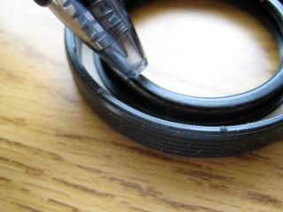

    Finally tackled this and its definitely a DIY. The hardest part was removing the snap ring from the flange, but other than its pretty straight forward.
    Aug 26 2005
    7741
    Not addressed in the AW DIY, the seal has an inner and an outer lip, The outer lip is the "dust seal", and protects the inner lip seal. The writer of the DIY on AW, put the grease in the wrong place. The grease is placed in the groove between the dust seal lip, and the inner main oil seal lip.
    This grease is to lubricate the seal lips during the run in period of the new seal.
