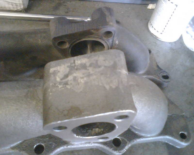

    does the high flow exhaust manifold really make a difference in power because for the price i was planning on getting the elim kit
    any pros and cons?

    i think you all got off topic here. he was wondering about a high flow exhaust manifold. it it work the extra $350 or so for it?
    OP: i'm sure you can run the elim turbo without the high flow exhaust mani, (thats why they were designed) but better performance will be made with one.

    Here ya go, two pics I took of my 034 and stock manifolds side by side while doing my BT build. Its worth the extra dough.
    I will be honest though, changing these out for the first time is definitely a pain in the ass even with the right tools and a lift.

    really? i figured it would be easy to do theres alot of room on my hot side since i got my CAI

    this mught be a dumb question but when if i bought the elim kit and then later down the line decided to get a high flow exhaust manni would i have to replace the turbo aswell?
    working around the intake isn't the problem. The problem is getting to those nuts that hold the mani to the block. The easiest way to do is to put the turbo, mani and test pipe together first and then bolt it in.
