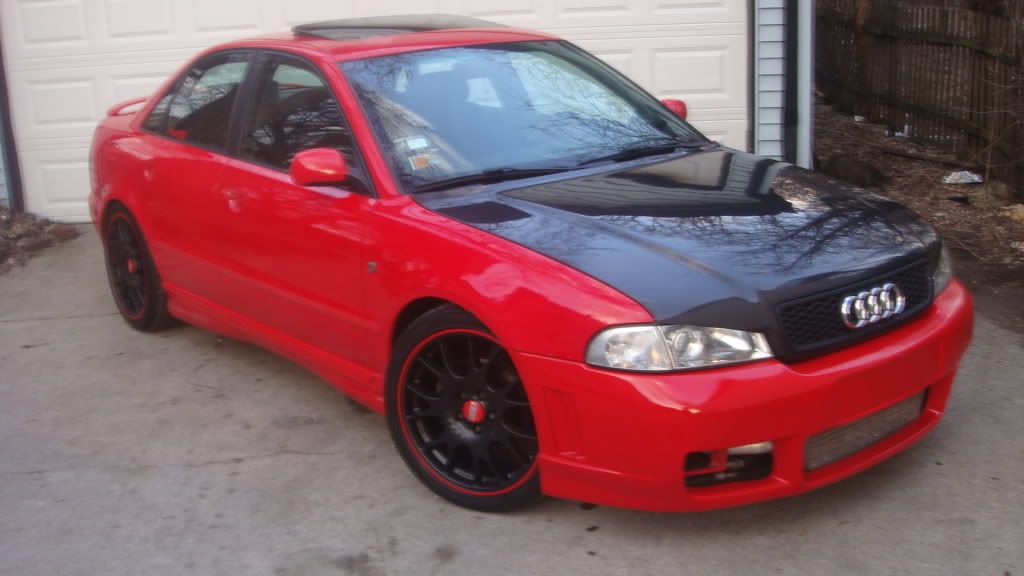

    I have to paint an RS4 bumper
    Change the lower part of the rear bumper
    Change the sideskits
    I'm also changing my carbon fiber hood to a Boser style carbon fiber hood
    Bought some new Black BBS Ch rims

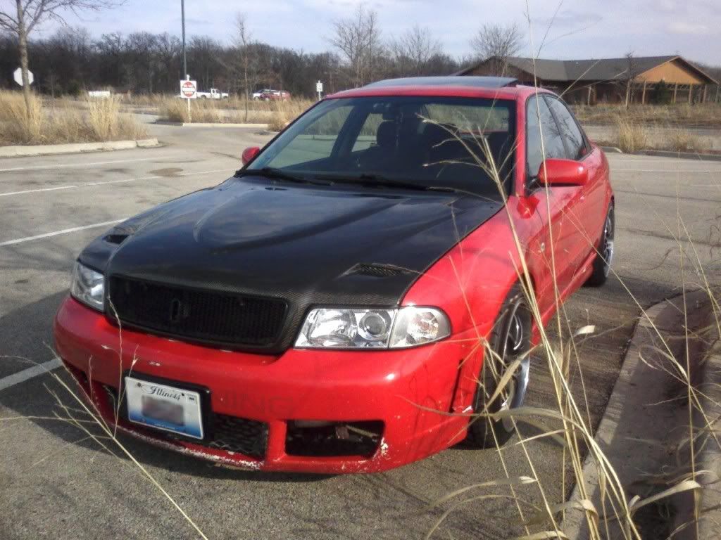

    What rear lip is that?!?!?! How did you get it to fit?!

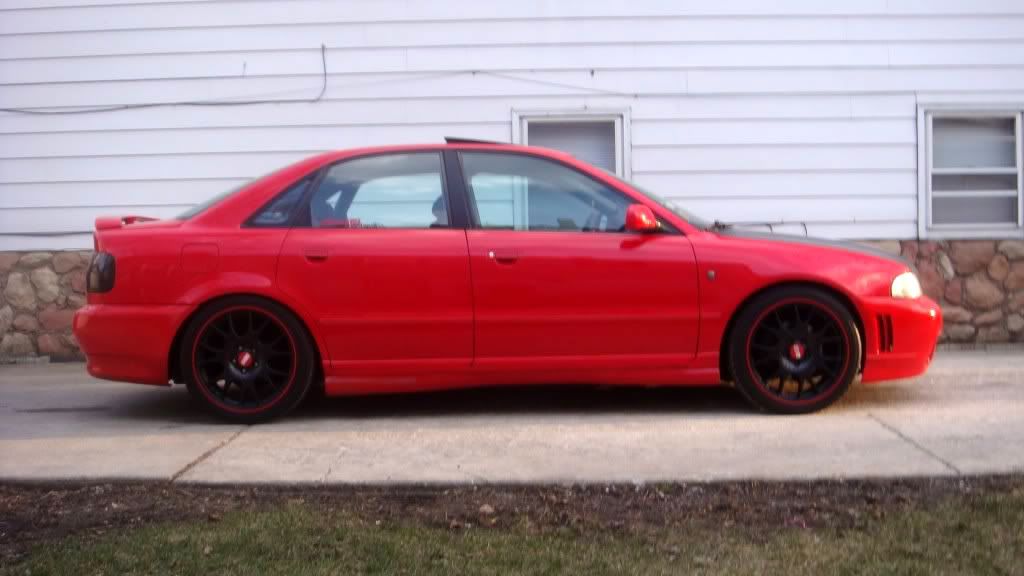

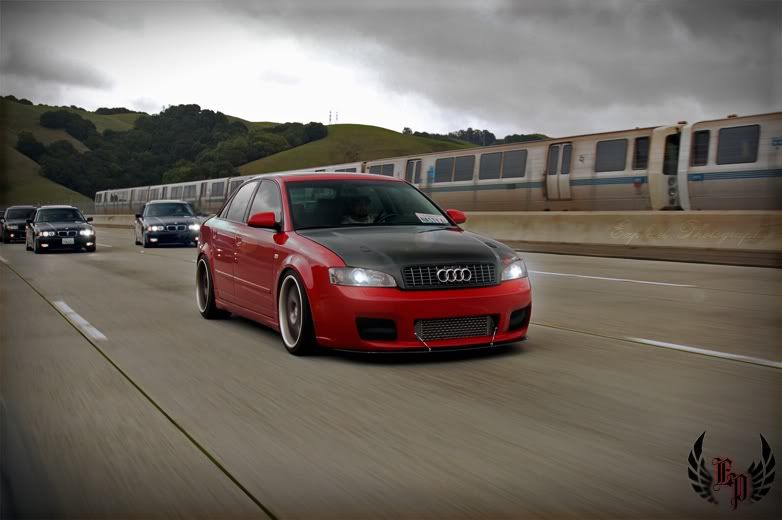

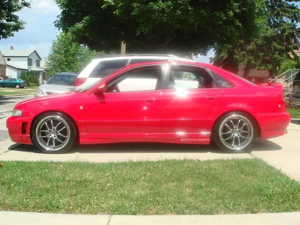

    what are the wheels in the first 3 pics.
    nice looking car. not a fan of the mirrors, but hey, its your car not mine
    have fun with the build and when it seems most frustrating, just drink a beer, take a break, and hang out with friends and loved ones. sometimes you just need to take a break and recharge if you know what i mean; but it all pays off in the end.
    by the way, welcome to the 'zine! happy tuning.

    I bought it on ebay a long time ago and I had a shop paint it and install it. Not to sure how they installed it.

    Quote Originally Posted by B5A4Kevin View Post
    Thanks!!! The rims are Stern ST1 and by the way I already prepared myself, I got a 12 pk of Red Strip, 12 pk of Miller Light and a 12 pk of Blue Moon. So I got several choices, depending on the mood

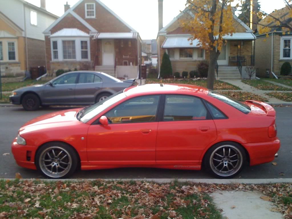

    Jun 22 2009
    44077
    Dundalk, MD
    The 06 wheels are nicer but sounds lke an awesome project

    Quote Originally Posted by [email protected]. View Post
    Thanks!! The problem I had with those rims was that one was a little bent and in order to get a new one I had to order it from Europe and it was to expensive. I can't remember the brand of the rims

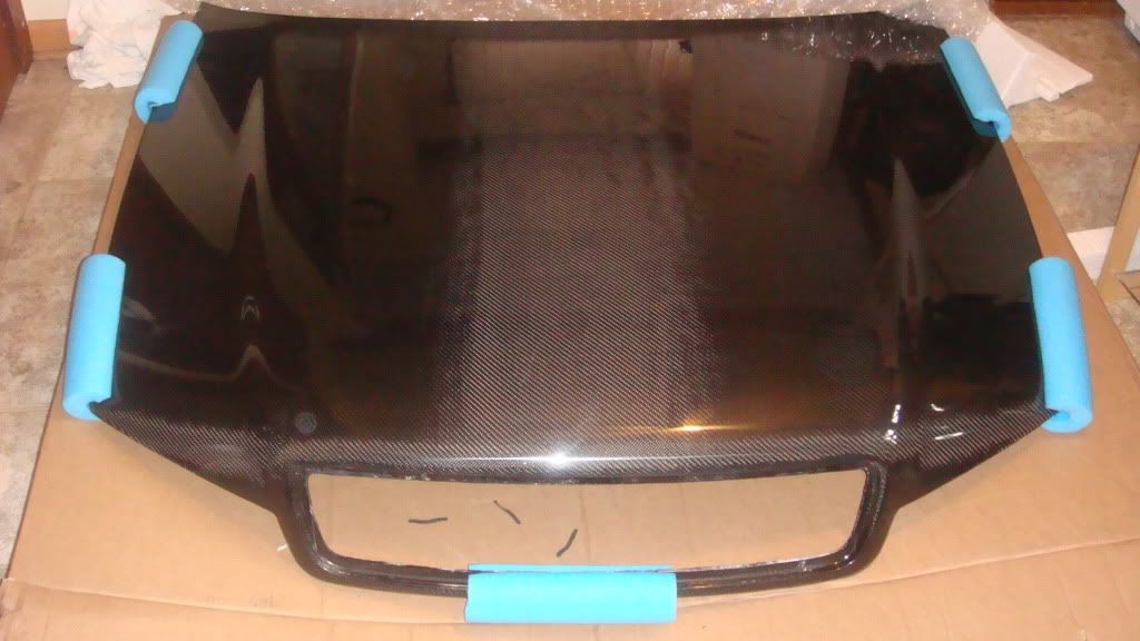

    No big updates, I'm still waiting for the Billet Main Caps. I guess they were out of stock.
    Here's my new Boser cf hood though

    Are you going to paint it?

    I would like to, but first I have to finish the stroker engine and after that I'll see.

    Would be cool if you flipped the colors:
    http://www.audizine.com/forum/showth...hood-shanigans
    Red in the center and CF on either side.

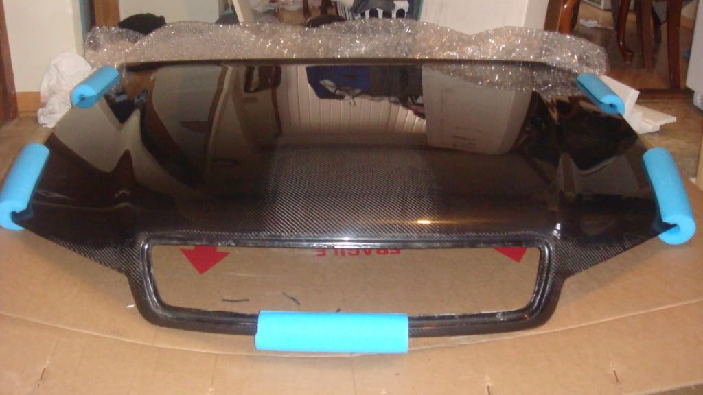

    In regards of painting the hood or not. I'm going to wait towards the end of my project, just because of funds. There's lots of money envolved with this project, but once I have the bumpers painted, the hood on and my new Black BBS on. I'll see how it looks.
    Here's where I'm getting part of my ideas from. The difference between my car with the first picture is that my rims have a red strip instead of the chrome and also my center caps are red, not black. Not counting that my hood is still cf.
    Here an idea how my car could look with the Boser cf.
    My goal is to have my car ready so I can take it to the 2010 Eurowerks. So based on that and funds, I'll see if I can paint it or not. I think both of these cars look good, so if I end up not being able to paint the hood by that time I think I should be ok. I know both of these A4s are not B5s, so my car will look different, but I think overall I'm going to be happy with the result.

    Quick update! It's not fully complete, but here's the new look! I still have to add the black mesh on the bumper, paint the FMIC black, install the black FMIC pipes, etc... But I'm going to do that once I'm ready to swap my engine.

    Needs more lower! At least your front does.. Is your rear sitting lower? Gonna put hood latches on your cf hood?

    Not a fan of the Boser hood for some reason, I never liked the look too much. Loose the trunk spoiler. Loose the ATP sticker on the sideskirt, this isn't a Civic and stickers don't add any power.

    Sexy as hell, but IMO paint that hood!

    wow nice done bro I have the hood and wheels also engine upgrade. let me know when u done, i got come to check it out haha
