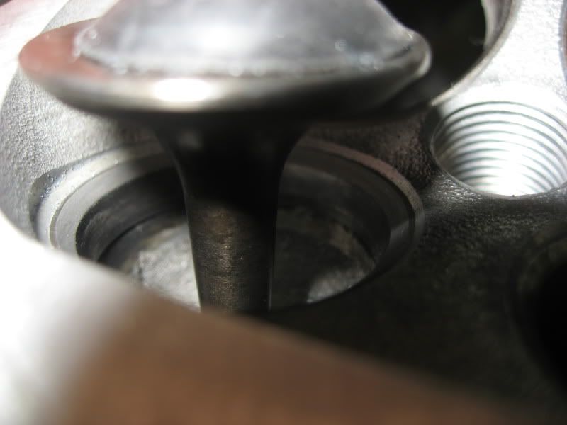

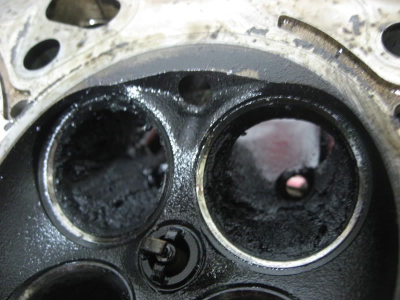

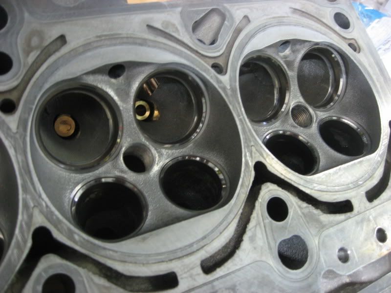

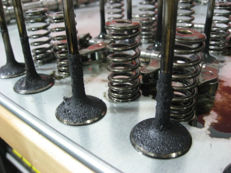

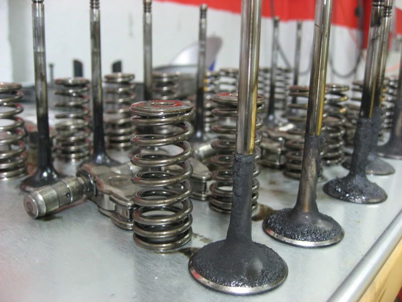

    Redline Speed Worx: Cylinder Head Carbon Build Up Sea Foam Service Limitations

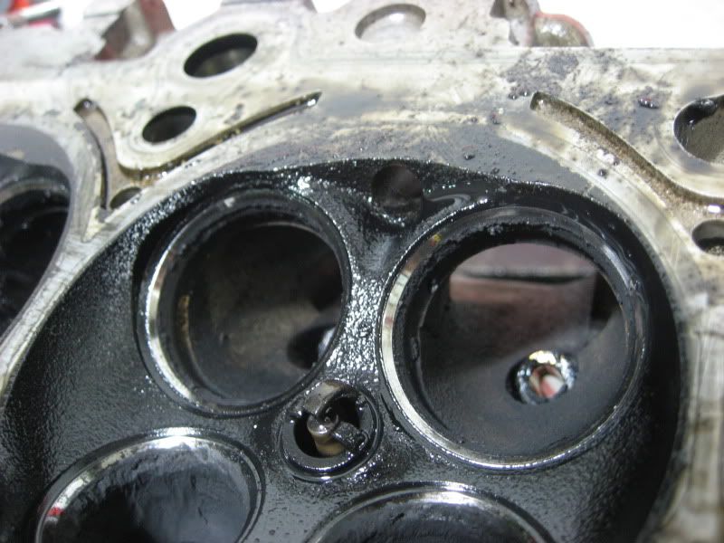

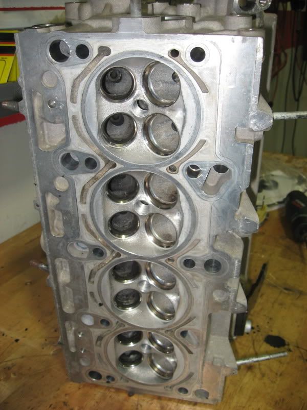

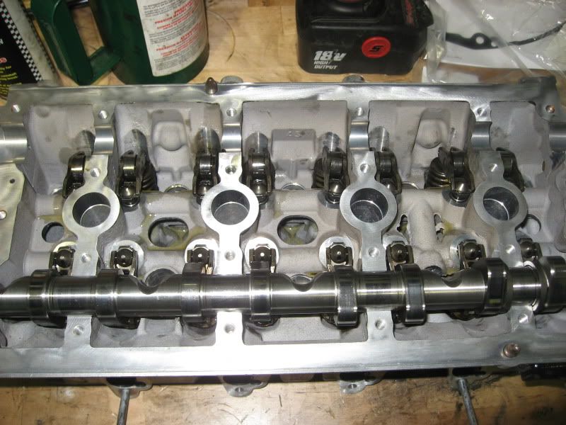

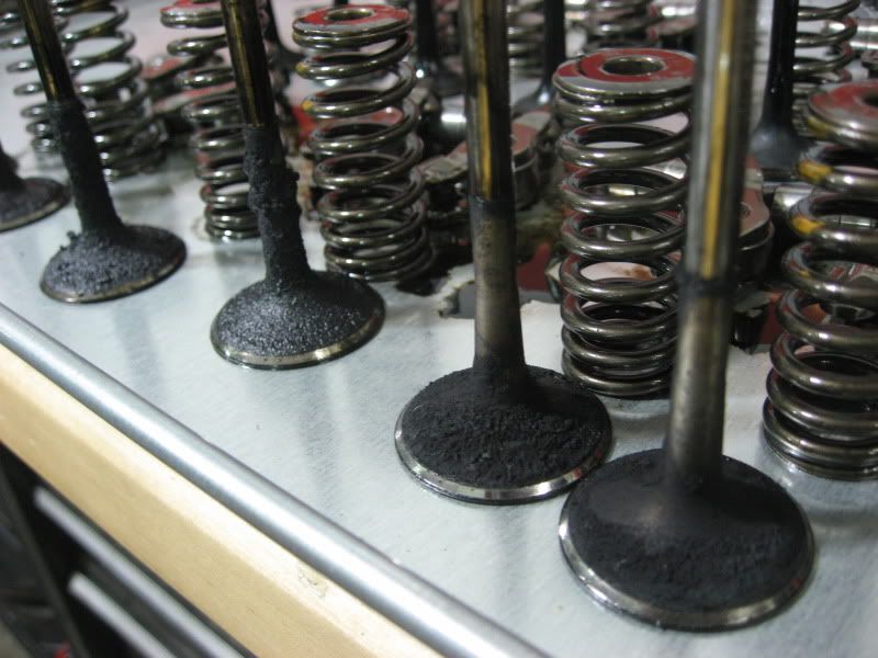

    FSI CARBON BUILD UP from a vehicle with under 60k and Upgraded Turbo System, this cylinder head showed "Mild" Build up compared to other vehicles we have serviced
    Un-Cleaned Valves Removed from Cylinder Head

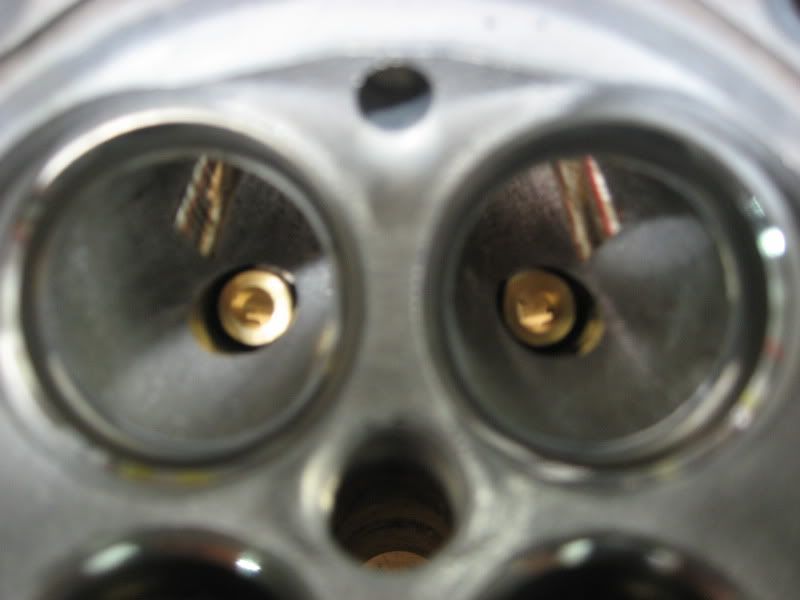

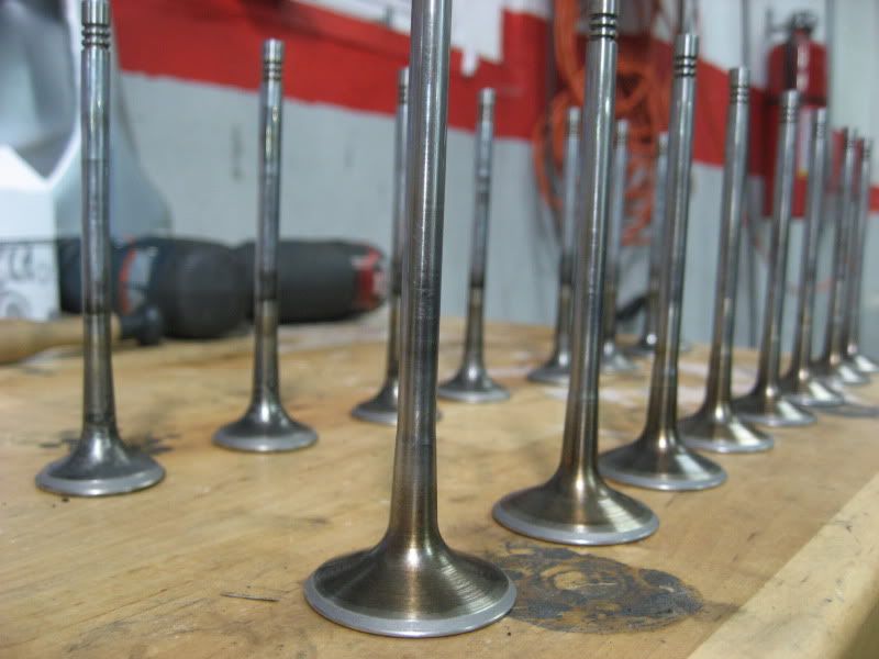

    Sea Foam Cleaning on Two Valves while they were still in the Cylinder Head VS. Un-cleaned
    These Two Valves were Sea Foamed while still in the head, as you can see its still difficult to clean the back sides
    Sea Foam Clean Ports while head was still fully assembled VS. Un Cleaned Ports
    As you can see from the pictures a Sea Foam Treatment Service to clean the cylinder head / valves only works to an extent ! Cylinder head is currently being steam cleaned, all the valves will be fully cleaned and re installed with new Valve Guide Seals.

    sorry but what exactly are you offering, sea foam obviously doesnt work. so you have a 2 step process of sea foam and steam cleaning? any before and after pics of the steam cleaning step to compare?

    I'm not offering any service here, just looking to share information with the community that by only using a Sea Foam Treatment with the cylinder head completely assembled can only help "to a point". The cylinder head will be ready to be re-assembled this afternoon, just waiting on valve guide seals !
    I will post more pictures so everyone can see the before and after !

    I see they aren't perfect squeaky clean... but SeaFoam did a darn good job taking good amount of gunk off, no? Do you think another Sea Foam treatment might do the trick? Now I wonder how well the BG Fuel Induction service works.
    So wait... how does Sea Foaming work while a couple valves were out? Did you just treat them with sea foam or did you let the engine suck in the seafoam while the car was running?

    not a bad job for some seafoam. Not perfect but way better off then what they use to be. nice job. Ill take that any day!

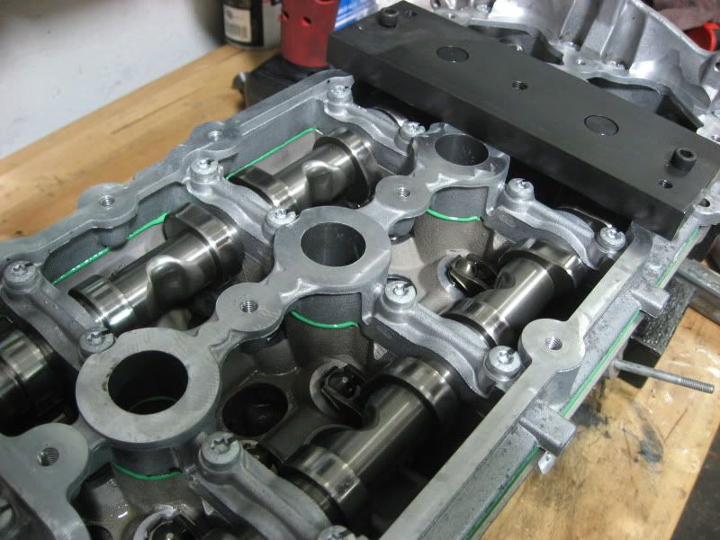

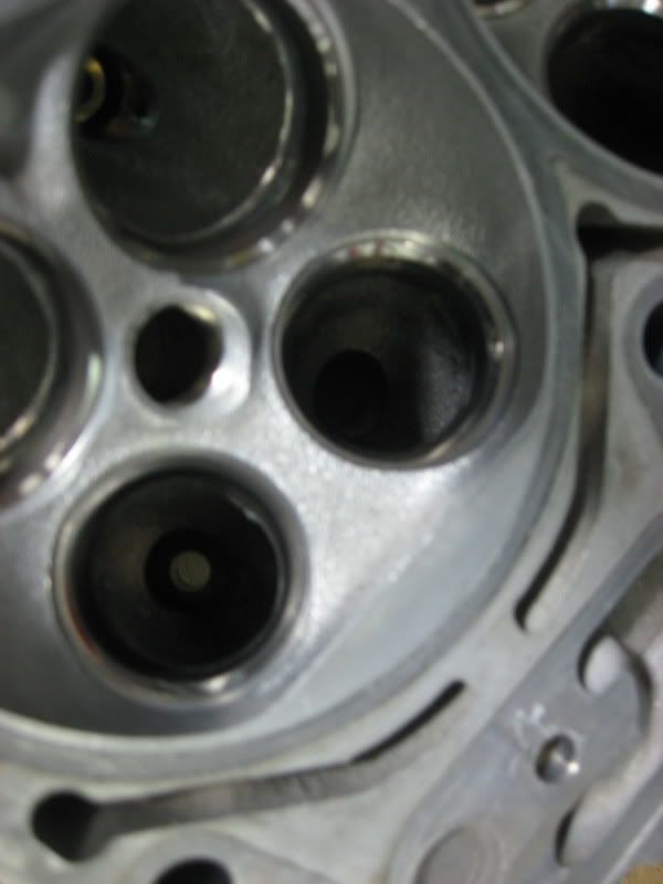

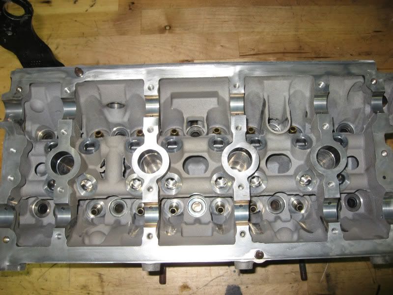

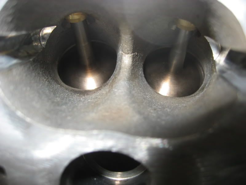

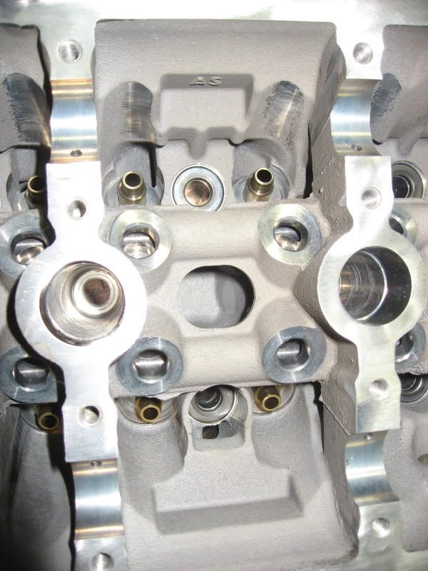

    MMMM so fresh and so clean
    Valves all lapped to the fresh cylinder head

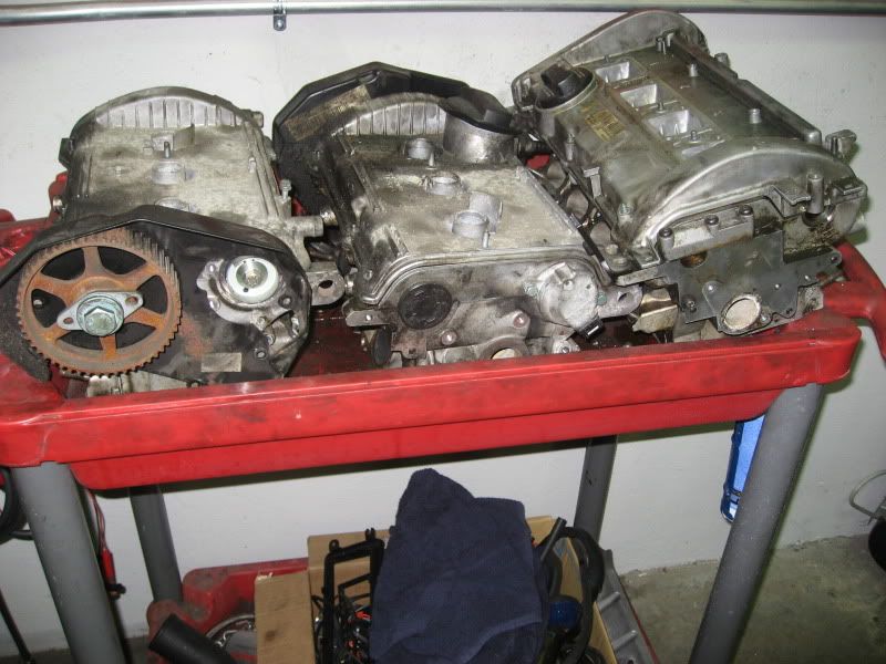

    A few more ready for rebuilds !
