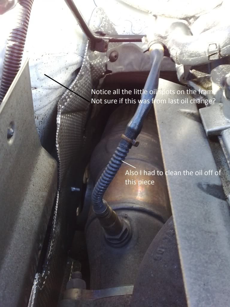

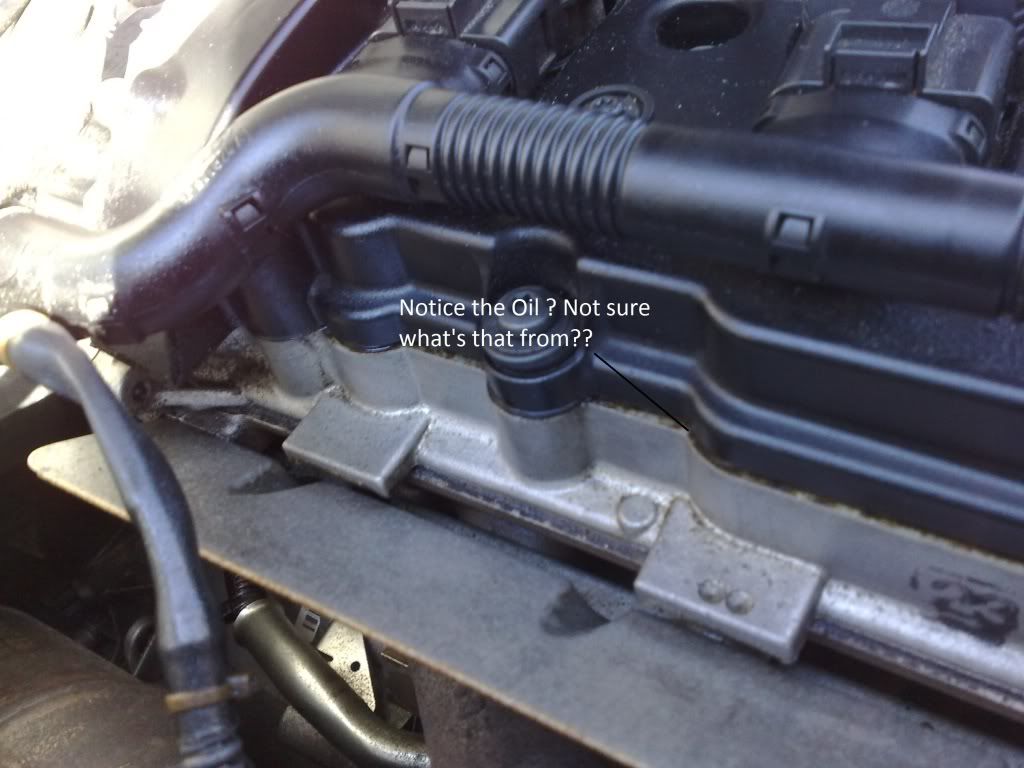

    Ok so I had to check the bay again and this is what I noticed
    Please see pics below. Sorry if they're to big.

    Valve cover gasket? Had to have mine replaced at about 39k.

    Sounds like PCV - if idles rough but sounds okay under revs, and you see oil outside the filler cap, it's a PCV failure. No big deal to fix; if you're under warranty, take to dealer ASAP and they'll turn you around pretty quick. There is a TSB on the PCV failure.

    So here's the update people,
    Went into Audi of Willow Grove yesterday explaining the problem... had an appointment car went in and took about 45 minutes not to bad. Found out that it was the crank case breather valve being bad, so they replaced that with gasket.
    gasket # 06F-103-483-E
    breather valve part # 06F-129-101-E
    The mechanic explained that the bad valve caused symptoms similar to a bad coilpack or something like that. So far so good drove it yesterday and it seems fine now

    I think my PCV is going bad now. I am getting the same issue you have in your pictures (oil near intake + oil from the side of the engine). I believe it is my PCV because I have never replaced mine. I am going to the audi dealership after work to pick up the parts. Which parts do I buy? the entire assembly or just the hoses or what?
    Dec 31 2008
    36936
    Selden, NY
    oil on engine
    This is what my engine looks like

    My engine bay looked like all those 2 weeks ago... Bsh block off plate fix my problem!!! No more pcv

    Picked up the PCV on my way home from work at the dealership and that fixed the issue I was having. I wanted to go with the BSH but I didnt want to wait for shipping (BSH actually cost only $1 more too and it is a more perminant fix). The car runs great now however
