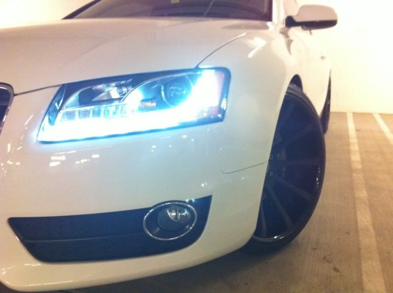

    Quote Originally Posted by peterish View Post
    This is the coding instructions I gave them, I'm not sure exactly which codes they used but it's one of these:
    1) Change the first byte to 26 (Xenons will turn on properly after this)
    (Or instead try 23 or 20)
    2) Check Byte 02 Bit 4 (LED strip as DRL)
    3) Change byte 14 and 15 to 5D (For the hi-beam to work)
    (Or instead try: byte 14 = 1D byte 15 = 0D
    New code should look like this:
    2601D0154030AF010005000000005D5D0F1C02880000010100 0000
    or
    26001031063C00010000080000001D0D0F1452080000000100 0000
    Peter, do you know for certain which long code it was? I got EPC/ESP/TPMS/ENGINE fault lights :/

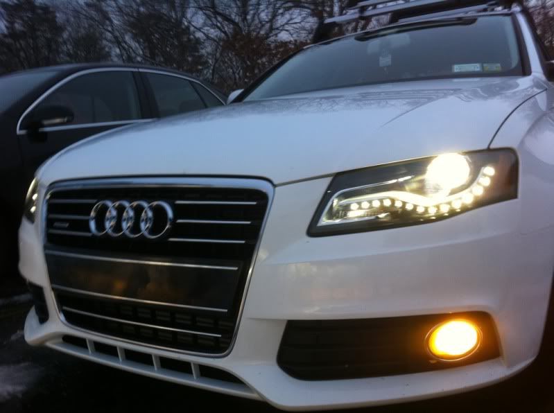

    FINALLY completed! Big thanks to Jens (lowestA4) for the parts, and Kai at Elite Motorsports in Medford, NY for the install.

    Quote Originally Posted by joeyo View Post
    Congrats! Looking Good!

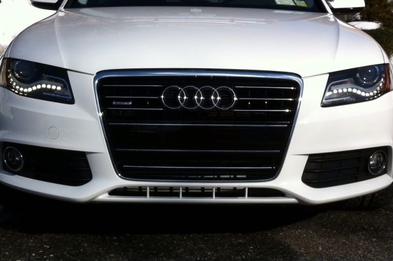

    Here's mine

    Let There Be Light! finally
    From an iPhone camera...but you get the gist
    '10 Ibis White A5-20x10 DPE SP-SC R10 Super Concaves('Reventon' matte/glossy black lips), Caractere Front Bumper, RS5 'type' Black Grill, Caractere rear spoiler, Black Roof, Reiger Roof Spoiler, Smoked Tails, H&R Sport Springs, Retrofit Euro Spec Bixenon
    Previous Rides-'01 MODDED OUT cclass show car, modded '03 A4 Cab, slightly modded '06 RR Sport and countless other Euros
