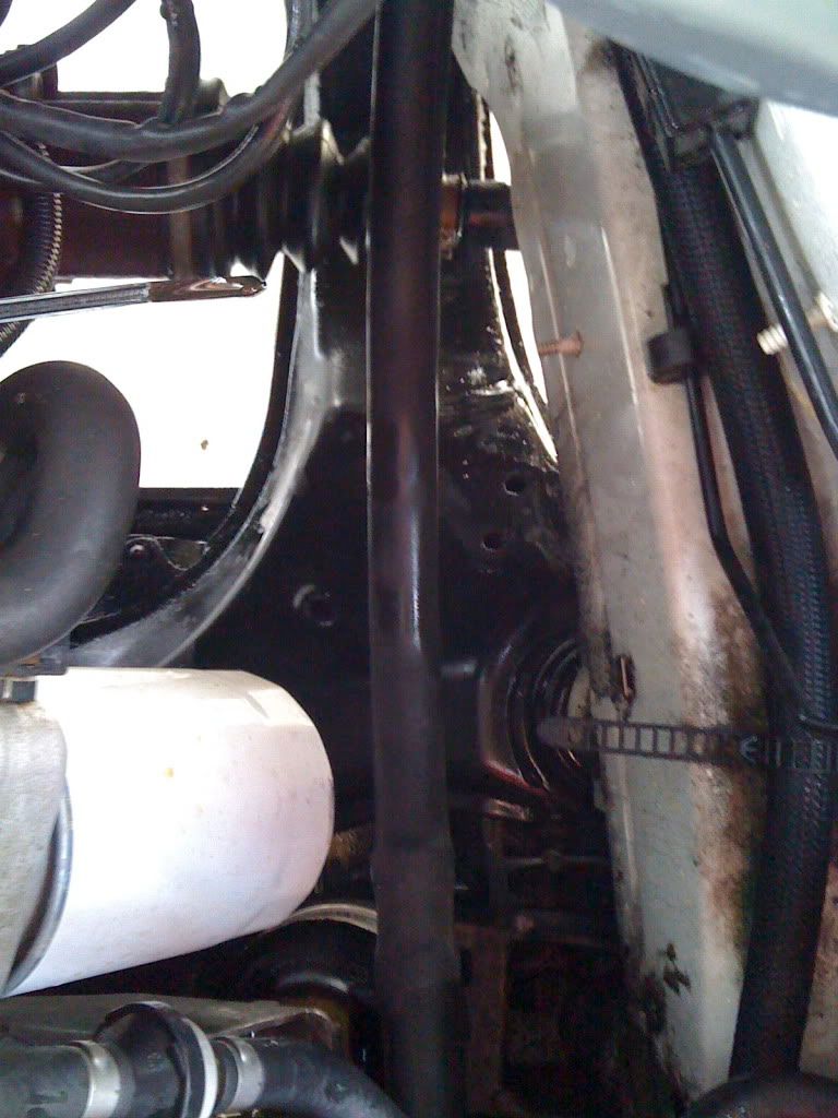

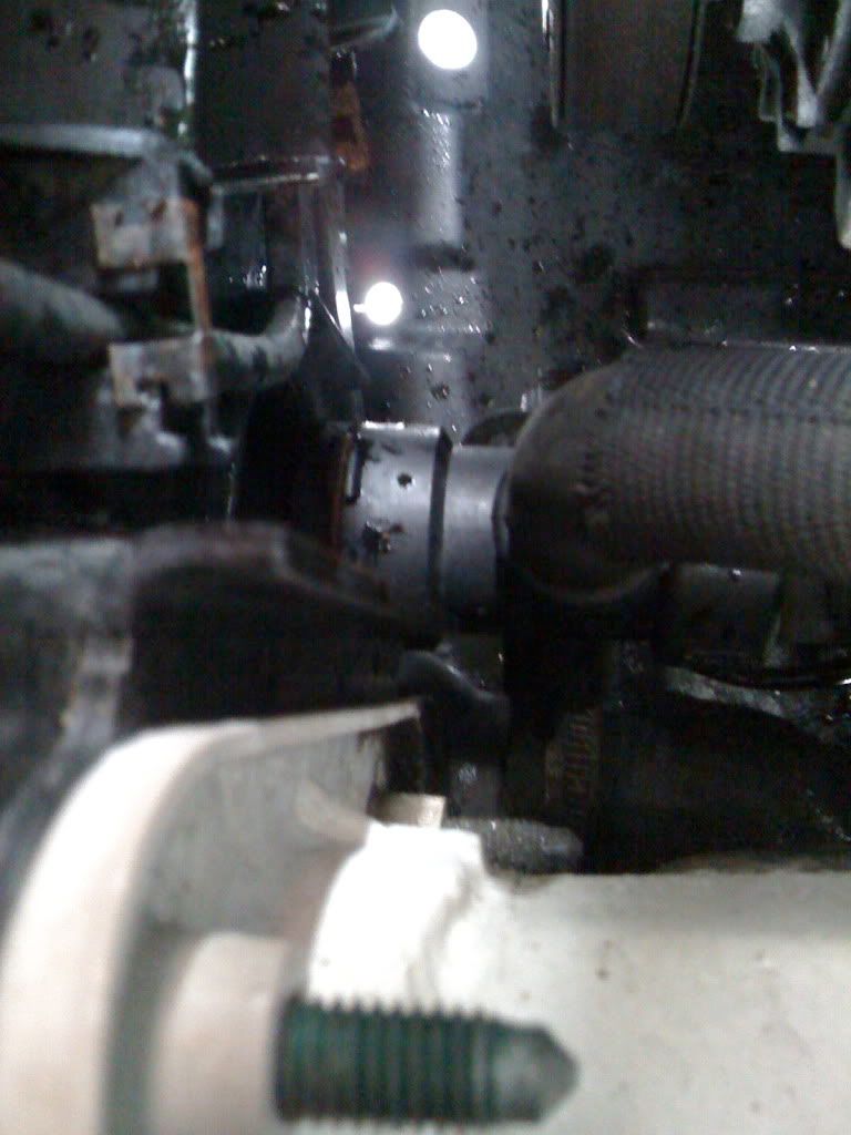

    I did check the reservoir, and it didn't appear to have any cracks. I was looking at the engine for about 30 minutes listening and looking for drips.

    Is your car still under warranty? Hate to say it, maybe the water pump took a shit.
