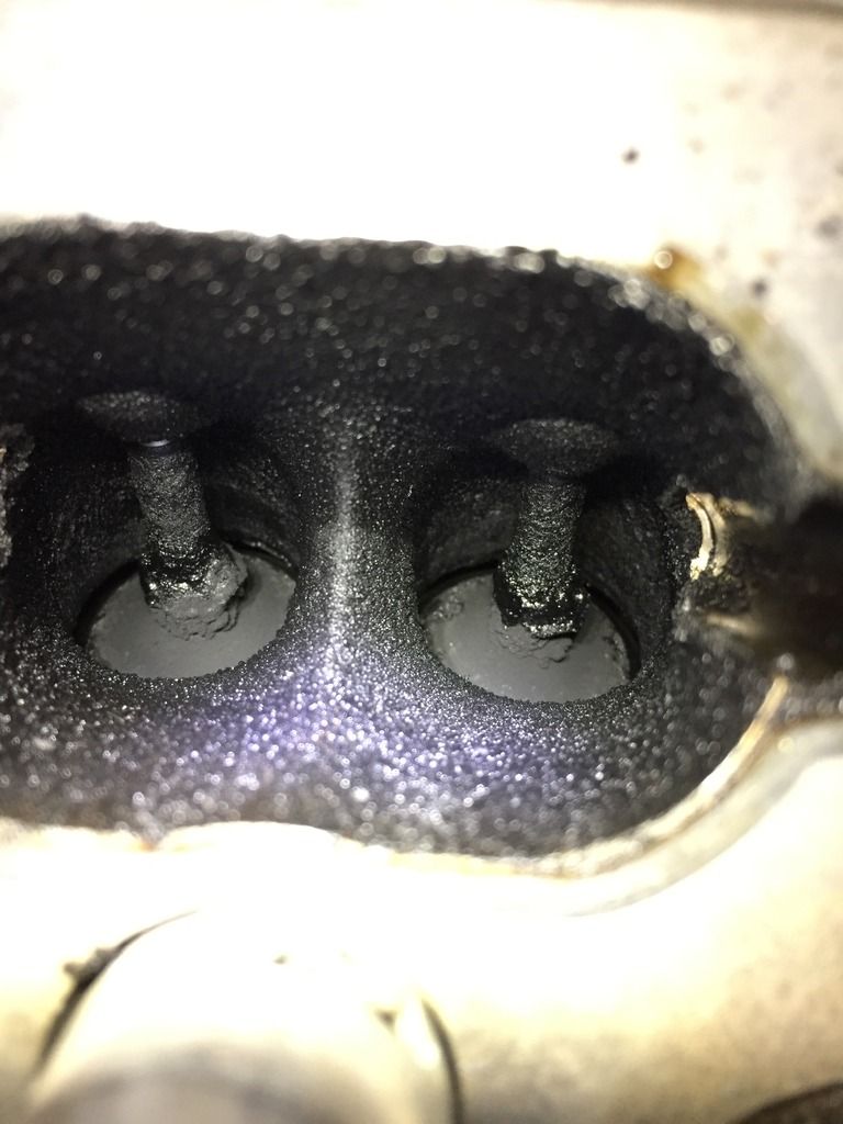

    I just dove into my 3.2 with 192,000 miles on the ODO. Slightly longer start times in the morning than I'd expect, fuel mileage has been getting worse over the past year, and it blows a little black smoke out the exhaust when 4000RPM and above at WOT.
    The valve covers are pouring out oil as well as flooding the spark plug bores, so while i have it apart to replace those I decided to do the valve cleaning (assuming it would need it knowing how bad the issue has been for Audi).
    Yeah, its bad:
    So far carb/choke cleaner sprayed on the closed valves has broken up all the hard carbon, but getting the massive amount of carbon out is an ongoing task.

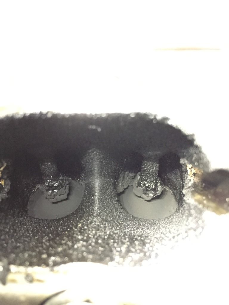

    And after:

    ^ which method did you use? I would like to do this to my 3.2 too. I am getting black smoke on WOT also.

    I used a set of Matco picks and a small wire brush, scraping out as much carbon as a I could and then vacuuming out the dry dust/pieces. Then I used throttle clean to spray down what was left, and forced small pieces of Scott blue shop towels around the back side of the valve to push what was left around. Finally, I used brake clean with the blue towels to get any smudges.
    This is a VERY precise and time intensive job. I highly recommend only people that are very confident in their mechanical skills do this. Not only can you ruin your engine if you do something wrong, I would guess I'll have 10 hours in it when I'm all said and done.

    Frankford, Ontario, Canada
    Well I'm completely floored. The tech calls me into the shop from the waiting room. That usually means bad news but not this time. The tech shows me the intake valve train and he says their perfectly clean. Like almost brand new. I wasn't expecting this at all.
    Since everything was removed, they just did a quick tertiary cleaning by hand with cleaners.
    These pics were before the cleaning.
    That check up was done last month at ~ 98k kms. I've only had the car for a year. Previous owner of 4 years was an elderly lady in Ottawa who only drove it in the summer months and stored the other 6 months while she was in Florida during the cold months. (Granny driving at it's best, lol) My main concern was that it may have seen a lot of very short and very slow speed use during those 4 years which is a prime catalyst for carbon build-up.
    My driving however is 100% opposite. For the last year it only gets driven a few times a week. When it does get used, it's usually for drives of over 2 hours duration at highway speeds. I live in the country so even shorter commutes are at 80kph + on the rural roads.
    I've been using PetroCan 94 octane this past year as it's been my gas of preference for the last 25+ years. Atilla at www.techmax.ca enlightened me to the fact that that gas has over 30% ethanol in it. His shop actually has testing apparatus to determine this. His advice was to use another gas without any ethanol for the sake of the injectors. The injectors and combustion burn process is better in a naturally aspirated Audi (like my 3.2) without the ethanol content unless the car has been specifically tuned for it. I have now switched to Shell 91 octane as it apparently has zero ethanol. I even downloaded a free App to my phone so that I can find non ethanol 91 octane gas stations wherever I go.
    I believe oil type has a small part to play in the carbon build up process. IE: Not using one of the Audi prescribed/recognised oil types can possibly contribute to greater PCV blow-by which of course coats the inside of the intake manifold resulting in build-up on the valves. I've been using Motul oil since I got the car and change it roughly every 6k kms.

    My recent RS4 carbon cleaning (third pic is partially completed cleaning - my phone died and I lost everything that hadn't been backed up to iCloud):
    Would guess I'm making 40+ whp more. There is a significant difference in smoothness, power delivery, and top end power.
