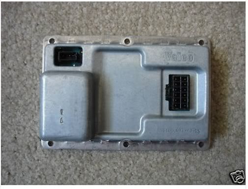

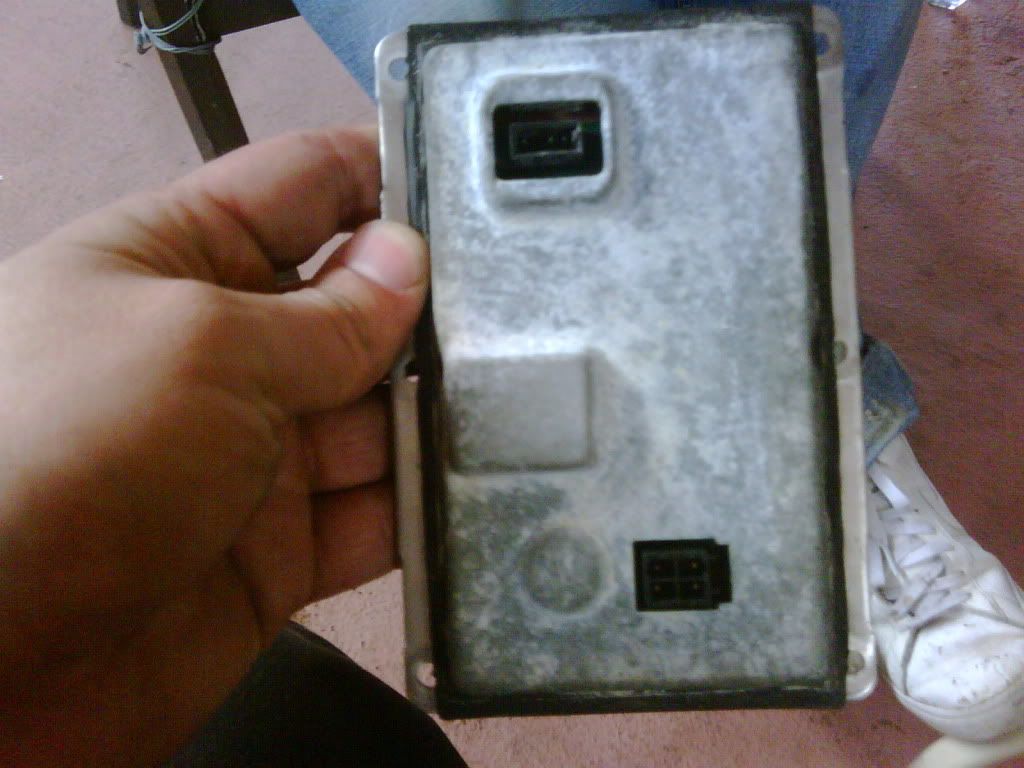

    Okay. I already know my ballast is bad. I have read all the threads on 3 different forums. I have a possible solution I'd like feedback on.
    Doing my due diligence, it seems to me that the Valeo LAD5GL is also the stock ballast for many Jaguars, Volvos, VWs, Cadillacs and the Chrysler 300C. My Audi dealer wants $400+ for it. Chrysler wants $190. Mopar wants $110. If the part is the same OEM ballast, I'd rather give $110 to Mopar and stay OEM/street legal, etc. than give Audi $400 or use a kit. The Chrysler/Mopar part number is: 5139061AA. I would like your input. Can anyone confirm my conclusions? I'll pull the trigger today if possible. These are front and back pics of the OEM from Valeo.

    question is, are the connectors the same?

    Right now, I'm guessing they are. The 300C that uses this ballast also uses the HID D1S bulb. I'm hoping someone here has access to that info for sure. A friend is waiting for his contacts at Chrysler to confirm, unless someone here can first.

    Do you have any pictures of the Chrysler/Mopar ones? Not sure if the pictures you provided were from Audi or not.

    The pics are from my Audi. If I had the Chrysler pics, I wouldn't have started the post! The DDM and VVME sites both have disclaimers stating that their kits are only approved for 'off road' use. They themselves suggest checking with local law enforcement or DMVs to see if you can use their stuff where you live. Since I don't only drive where I live, I'd rather avoid the issue. Yes the odds of getting caught are slim. But why open myself up to tickets or civil suits if some attorney breaks my balls about questionable lights after an accident?
    So, my original question still stands. Can anyone CONFIRM for me that the Chrysler ballast is the same?

    Chrysler pic
    Veteran Member Three Rings S4King's Avatar
    Aug 01 2009
    45791
    Houston, TX
    Re: new twist on ballast replacement
    Quote Originally Posted by 400HPA4 View Post
    Chrysler pic
    They seem the same to me.

    just to compare the two better. everyone should rep this kid for the info he has brought to the forum.

    I know this is a prehistoric post, but I need one of those instead of the Audi or cheap aftermarket versions. What is the Chrysler or Mopar part number for it?
    Veteran Member Four Rings Ozone510's Avatar
    Feb 15 2016
    368805
    Audi A4 B8 Avant 2.0T, Audi A4 B7 2.0T SOLD, Audi TT 8J Cabriolet VR6 DSG
    Hayward, California, USA
    Quote Originally Posted by Garf View Post
    LAD5GL

    Just so you guys know, for anyone with a 12-port connector who needs to swap to a 4-port, but can't find a 4-port, you can cut the 12-port down into a 4-port and make it work.
    Take the wires out of your 12-port using a pin or just destroy the plastic around them:
    You can re-use the 4 ports where the wires were originally IF they're still intact. (mine weren't so I chose the other side of the connector):
    Cut the switch in two, making sure you do not damage the 4 ports you want to use:
    Now place the wires into the now-4-port connector making sure the wires go into the ballast in this pattern:
    Plug everything back in and:
    Hope this helps anyone who can't get a hold of a 4-port connector in time. I was on a very tight schedule and had no other way of doing it.

    Newbee here but lets see if I can explain myself.
    I have an
    but I purchased
    Can I just connect the wires into the 12 slot since only 2 are used
    basically do the reverse of what was done up top?

    your half right.. you need to switch the wires like this.....
    Quote Originally Posted by JeffM03 View Post
    Did this^^^^^ works great thanks a lot...saved big $$$$$$$$$!!!!!!!!!!!!

    I just picked it up. It's the exact same ballast! It didn't come with a gasket, but I'll reuse the old one. The label is identical. I can't upload pics, but there is no need to. As soon as I get home I'm putting this puppy in.
