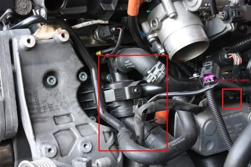

    Just finished my TB job yesterday and OMG, Murphy's Law f'd with me through the entire job!!!
    All I gotta say is make sure you have these 2 tools: 4mm triple square socket (to remove the metal hose going into the thermostat):
    And an IRWIN bolt out kit, you'll most likely need the 1/2 socket to remove the crank pulley sockets that will round out (3 out 6 in my case). The only other thing I could think of is maybe it would be better to use an impact screw driver with the allen socket first. But if you do round out the bolts, you will have to hammer on the 1/2 IRWIN bolt remover socket and I do mean hammer because the space between the center crank bolt and the 6 allen head bolts is very small so you'll have to force it on there!!!
    Other tools you'll need is Torx t20 and t30 and then after that a different sockets 10mm, 11mm, and 13mm mostly with different long extensions.
    Also with me having a CVT tranny I had to remove the 2 transmission cooler lines from the radiator on the passenger side, didn't lose too much fluid and within the next hundred miles I'm due for a tranny flush anyway. But because of all the hurdles I encountered my TB job took 3 bloody days on and off between trying to find the triple square 4mm socket and the 3 stupid crank pulley bolts.

    Just wanted to add a tip here. It seems there is a lot of trouble with those M6 crank pulley bolts stripping on people. This is a very common problem on all modern Audi's. Cleaning the allen hole out and hammering the tool into is a great tip. Another tip I would add is to use a chisel and hammer. You want to give each bolt a really good hit on the *side* of the bolt head. Your chisel edge would be perpendicular to the bolt's shaft, not parallel (else it would easily slip when you go to hit it). You want to try and contact the bolt head as near to the base as possible. Giving it several hits is not a bad idea either. Don't be afraid if you are denting the bolt a bit, you are replacing it anyway. Getting it out in 1 piece is the name of the game here. This percussive shock to the bolt will help to break it free. In reality, you are applying a very minor stretch to the top of the bolt, which serves to loosen it in its hole. This works extremely well at reducing the amount of torque you must apply with your allen tool to extract the bolt, thus reducing the chance of it stripping.
    I realize the clearance may be more of an issue on the 2.0T due to the use of 6 bolts instead of 4 (like a 1.8T). But whatever contact you can get on the bolt will be helpful.
    In the event the bolt begins to strip...STOP...and hit it a few more times, and continue. In the event that the bolt is already stripped and your tools are having a hard time applying much loosening torque to the bolt, you can actually have a helper chisel/tap the bolt head *while* you attempt to turn the bolt. Work up the best solution you have to get some torque on it (maybe a torx socket, or a bolt-out socket, or pound in a larger allen), and then apply as much twist as you can without stripping while somebody taps on it with the chisel+hammer. This percussive shock while turning is very effective, basically a very controlled impact driver type action.
    This is a method I use on every Audi/VW crank pulley bolt I remove, and I've never had to drill one out or use bolt-out type tools, even on very rusty, over-torqued, re-used bolts. It works every time.

    Had my car for less than a week and successfully did the timing belt job, thermostat, accessory belt tensioner and idler pulley, diverter valve, and snub mount. Got my kit from Europa parts. Some notes:
    -I followed "walky_talky20"'s advice above and had zero issues getting out the crank pulley bolts (98k miles, I expected some problems)
    -The trickiest part for me was the thermostat. Installed the first time and had a bad leak from a damaged Thermostat-to-Engine seal. Replaced that and had the common leak at the hard-line going into the thermostat. After loosening the 2 oil cooler bolts and adjusting the hardline this seems to have gone away. I did not have any problems bleeding the system or with overheating, but had to add a little coolant over the next 2 days so there was definitely some air left in the system.
