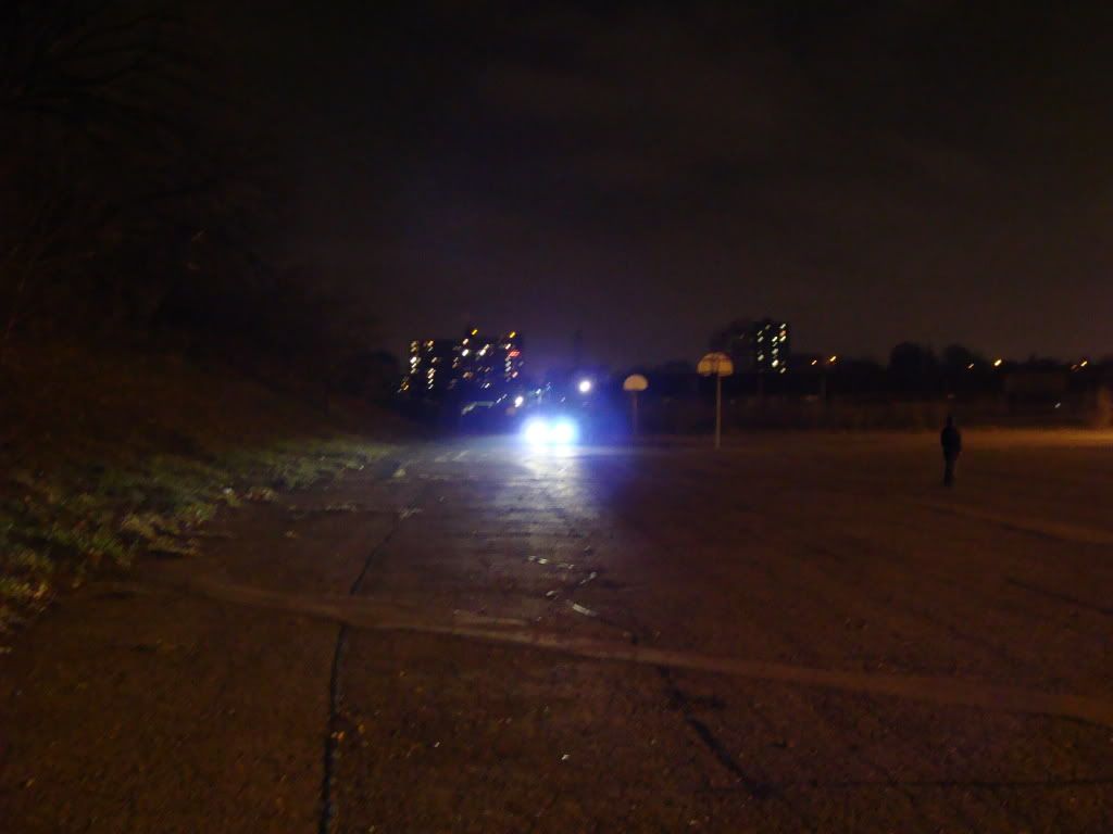

    [QUOTE=WayzataAudi;4392175
    as for the bulb issue, im saving up money to buy new bulbs to see if that is the issue...what color would you guys recommend? i want something a little more blue, like the color of range rover headlights...[/QUOTE]
    If you want more color go with a higher K bulb but be warned about potential riceness and the higher the K the lower the brightness.
    If you want more color from you OEM Bi-xenon without loosing brightness or looking like a rice rocket, you have to change your dot spec projector lens to a clear or ece lens. That will give you more color flicker and enhance your brightness from OEM setup.
    Check out my thread:http://www.audizine.com/forum/showthread.php?t=243770
