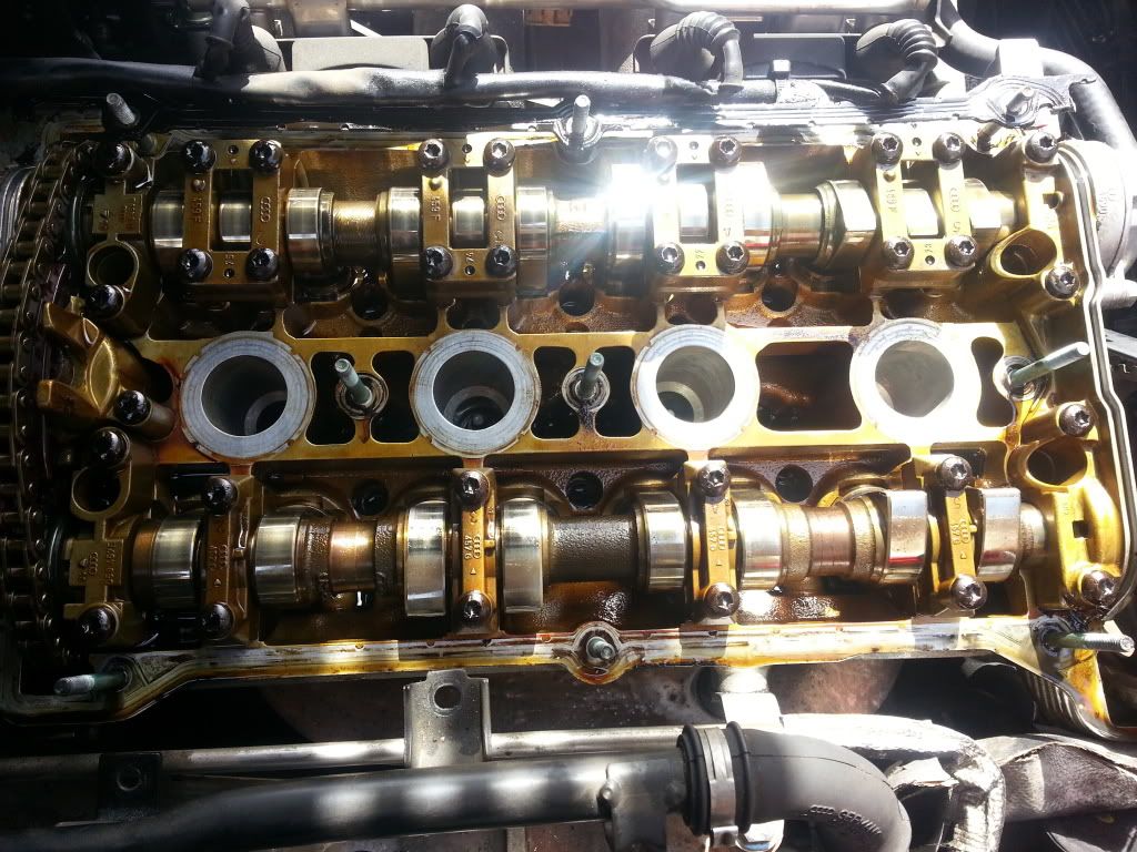

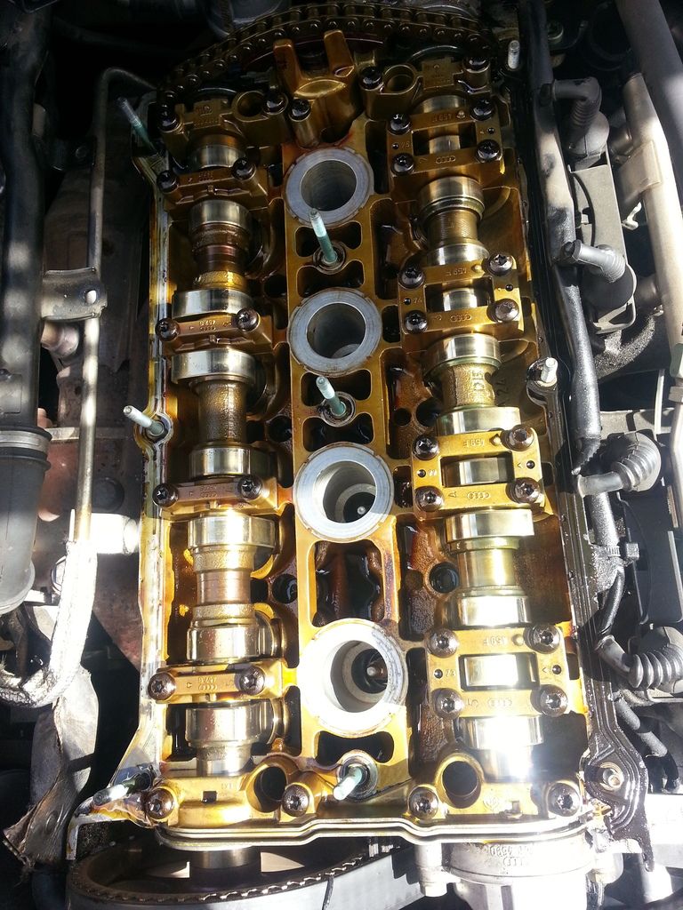

    Pics of when I did valve cover gasket and chain tensioner seal around 40k miles ago (186k miles now). I remember there was a little bit of oil on cylinder #4 because of the leaky valve cover gasket.

    I doubt it’s the lower CTS causing an overheat condition. The ECM utilizes the rear CTS reading along with engine load requirements to determine the thermostat heater duty cycle. The lower temperature sensor is simply used to determine if the thermostat is reacting properly to the ECM input. If something gets out of whack the default is to apply full power to the heater. When that happens you will get a DTC for the mapped cooling system.
    Since you aren’t getting any DTC’s for an open circuit or a mapped cooling system error you really need to look elsewhere. I believe you have a mechanical issue and not a controls issue. That leads back to a slipping impeller or a cracked head. A cracked head probably won't exhibit a mix of oil and coolant nor will it necessarily put out white smoke or smell sweet.
    You can either replace the water pump or remove the thermostat and reach your fingers in to see if the impeller is slipping. You can also check block gasses for a possible cracked head. Are you losing any coolant at all?
