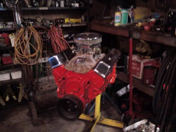

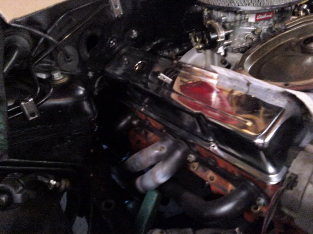

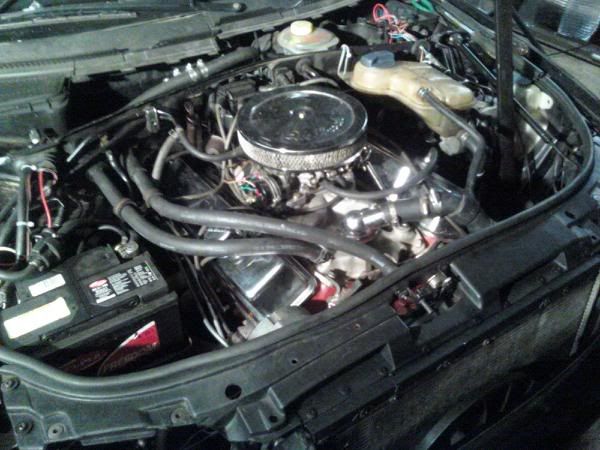

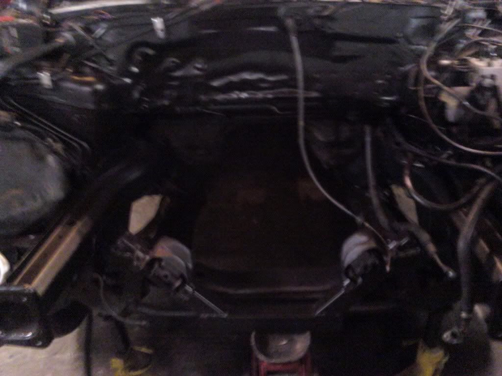

    well i finally got some pics idk how the quality is my camera was broke so i used my phone. right now its running and drivable(used a 5 gal gas can to take it around the block had to remove the fuel tank and am building a custom fuel cell ) still has some minor kinks to get worked out, like the radiator and cooling fan its not stayin cool enough. i took out the 1.8 and put in a 5.7, its a 1979 350 with a 4 bolt main bottem end is stock, has worked heads, edelbrock cam, edelbrock torker II intake mani, edelbrock 650 4 barrel carb, comp cams roller rocker arms, custom made headers and modified oil pan. had to make a custom crossmember and tranny mount, driveshaft, relocated battery to fit distributor, pushed the firewall in a little, custom gauge cluster, and a whole bunch of other stuff ill post some more pics probly tomarrow.

    I like it. Are you just RWD or are you using the AWD. I remember awhile back seeing an adapter to use the AWD. Good luck.

    lol, holy crap! awesome swap!!!! please keep us updated on the progress!

    i converted it to rear im using a chevy turbo 350 transmission

    What rear end/axles are you using?

    right now im using the stock one, lol, idk if it will hold up, personally i dought it but ill find out.
