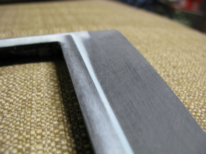

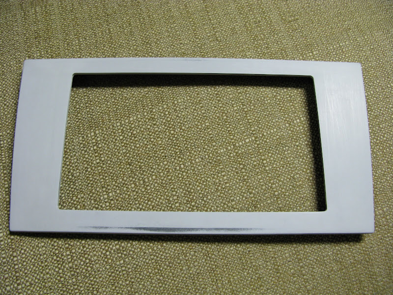

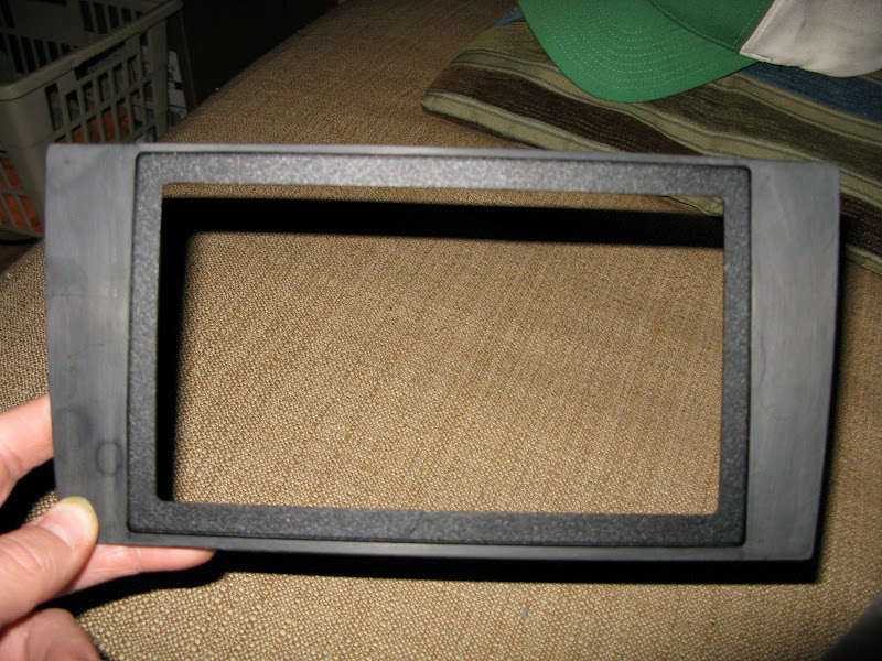

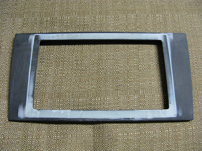

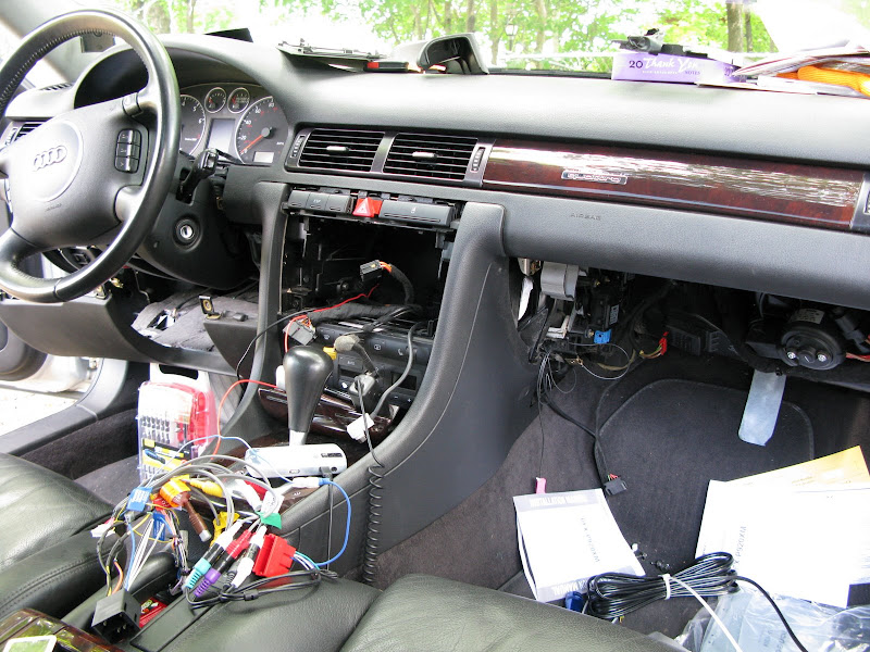

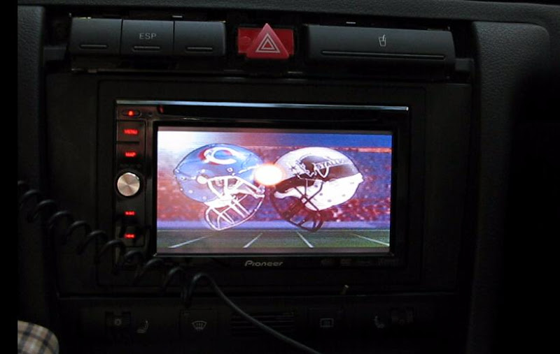

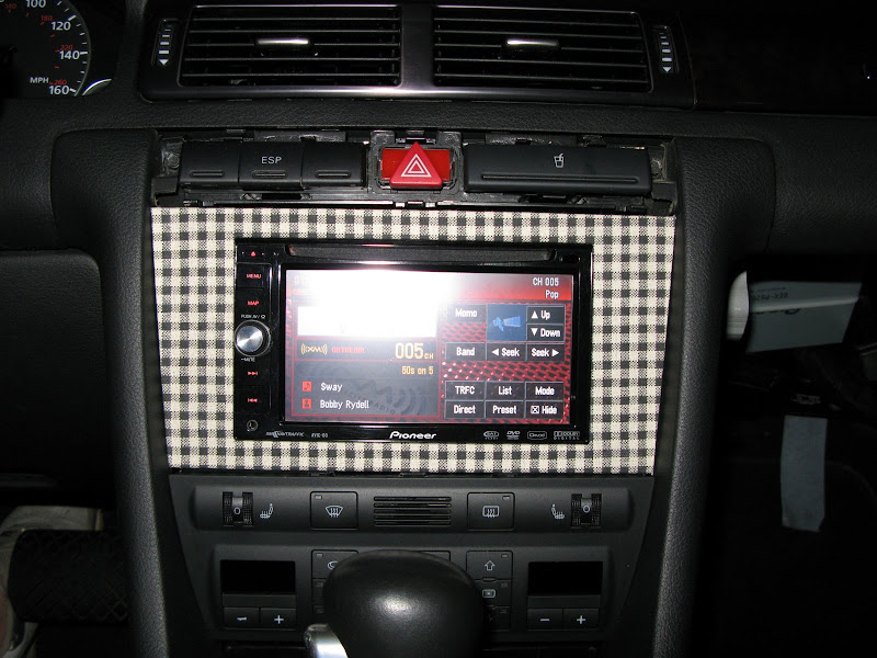

    I have been interested in an upgraded HU for quite some time and tossed around weather to go with the RNSE for the more factory look (that I prefer) and straight forward install or the feature rich Pioneer Avic D3 with touch screen, IPod integration, and more. Based on cost and features I choose the Avic and decided I could fab a factory look.
    One of the BIGGEST disadvantages is the fitment of these units and the dash kits. They are a 2 piece design and the finish is far from a factory look. This shows the outer piece sanded and the separate inner piece still stock.
    I missed a few pics because my hands had glue and body filler on them but the first thing I did was JB Weld the majority (for a long hold) and superglue (for a quick hold) the corners because they stuck out far from flush. This is after the first coat of body filler.

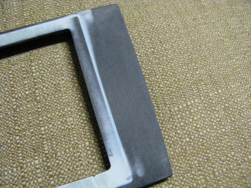

    Although it looks pretty good here its nowhere near ready for paint. The final product would look worse than it did before I started.

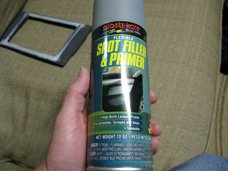

    I went with a buildable primer because last time I worked with plastic and body filler everything looked good but when I layed the final coat of paint you could see the lines where the body filler was because it was not 100% level.
    I put down a light coat as a guide that was mostly sanded down then 2 heavier coats to cover the places where it was hard to get enough filler coverage due to working space. All said and done its probably about 1 - 1.5 coats after sanding. You can see there are some places where you can see through which is ok.
    I now have a smooth surface to lay my final finish.
    *** I will update with more pics as I proceed. I am working on a fitted mounting bracket that will attach to the unit and the car so there is NO play in the HU once its installed.

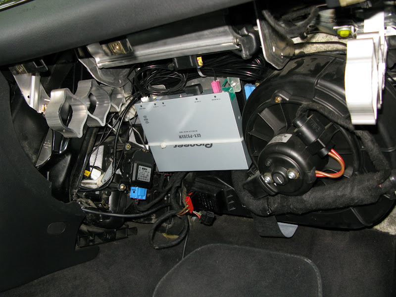

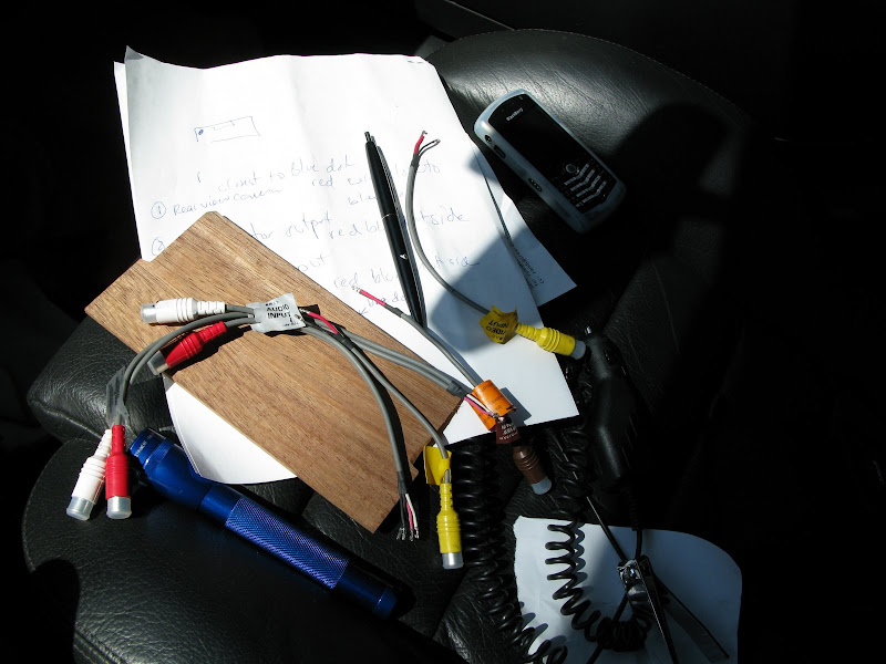

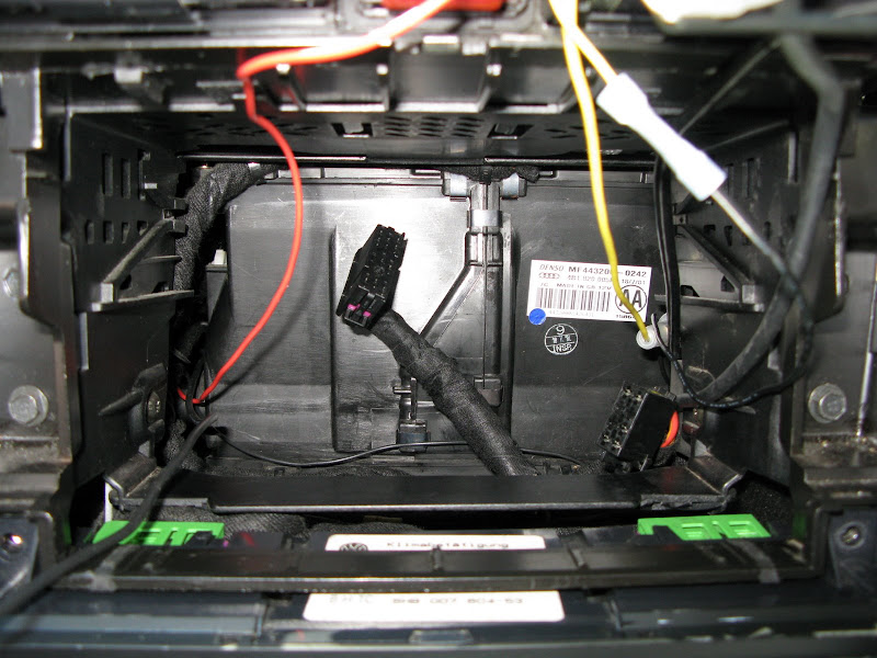

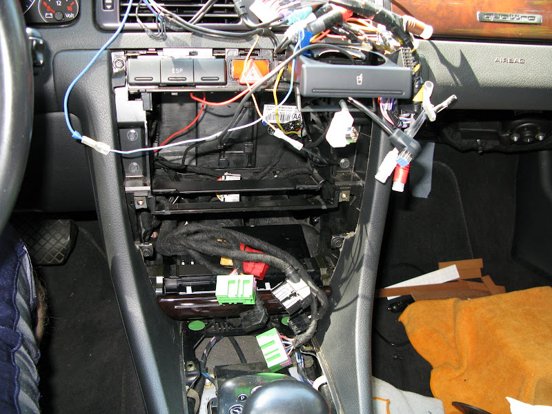

    The other huge challange is to cram all the extra wire you now have behind the unit. You can see in the photo I had to hold the face plate in with a twig. Yes... a twig, found it on the gound.
    Here it is with everything pulled out and you can see ALL the harness draped over the cup holder that is supposed to fit behind the Avic
    Yup, that big mess of wires by the ebrake.
    I had to start from the gound up remove both the climate control and ashtray. Then worked with the factory wires and moved around then replaced both units to get to here.

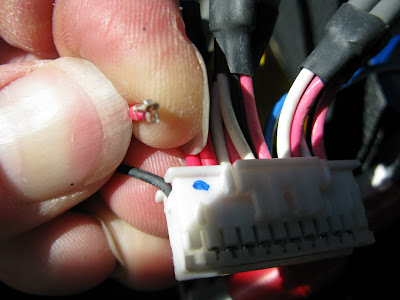

    First wire removed from harness. Ues a tiny prick. (Yes I said prick and yes my nails are long. Dont worry I cut the nails. BUT they were used for this project ;D)
    These are some of the extra RCA wires that I was trying to cram behind the unit.
    After all the extra RCA wires are removed and the factory wires below are moved into a good place then this is what remains... Plenty of room for the AVIC D3, no stuffing needed. And this makes me a happy Man. One step closer, now I just need to find the finish for the front of the faceplate.
    I mounted the XM tuner behind the glove box.
    And one antenna is still in this location the other is up on the dash, wires hidden, with the antena pushed against the glass.

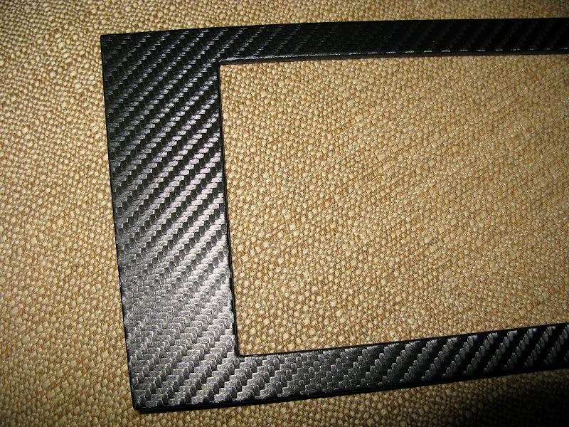

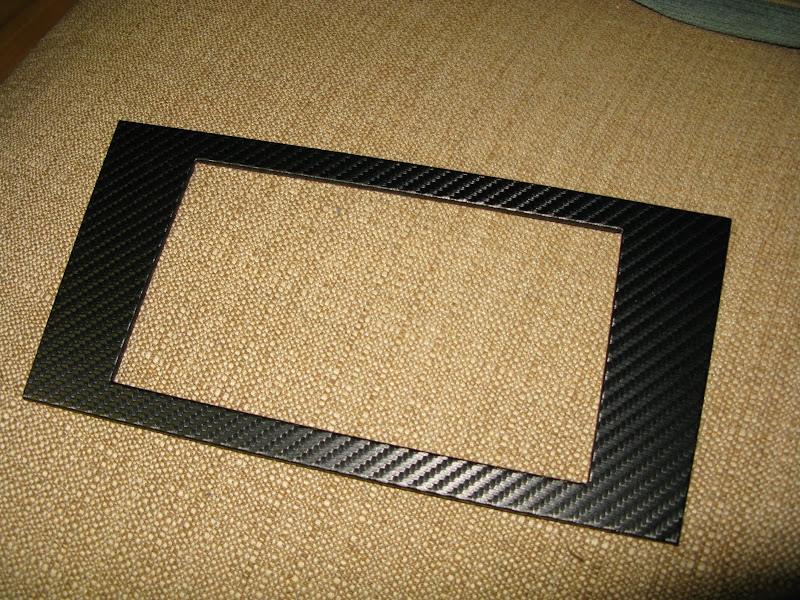

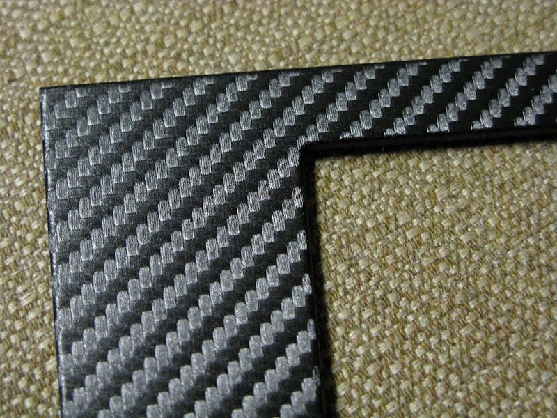

    I 1st tried plasti dip but that did not come out good at all. Cool thing is that it peals off.
    2nd try with fabric this time. It looks better in person but still not what Im looking for. Its a houndstooth material but it has too much pop.
    Round 3 on the trim.

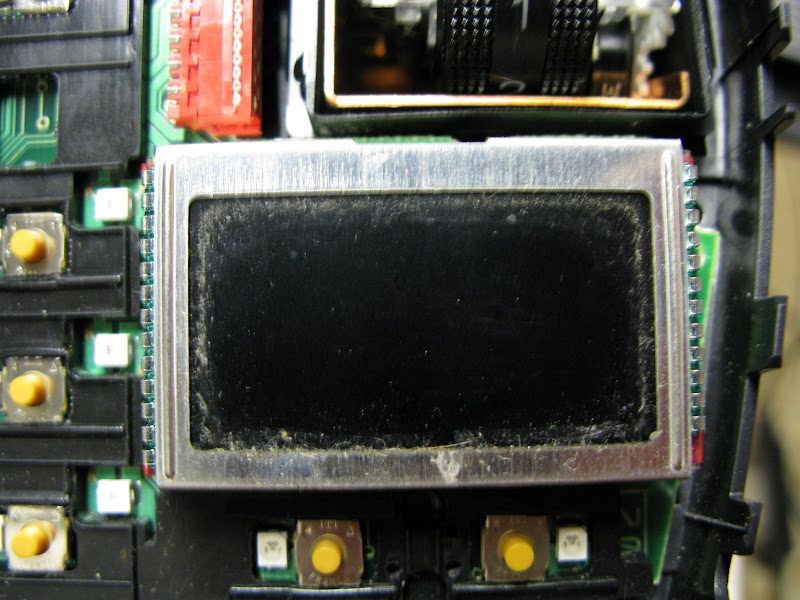

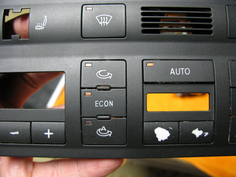

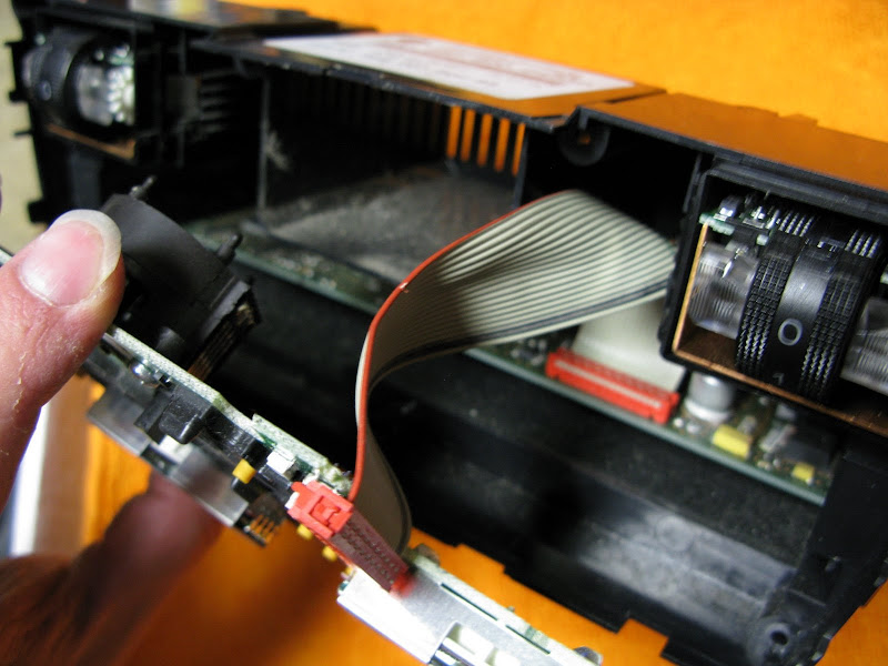

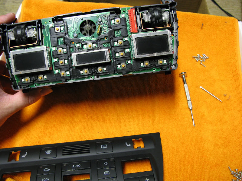

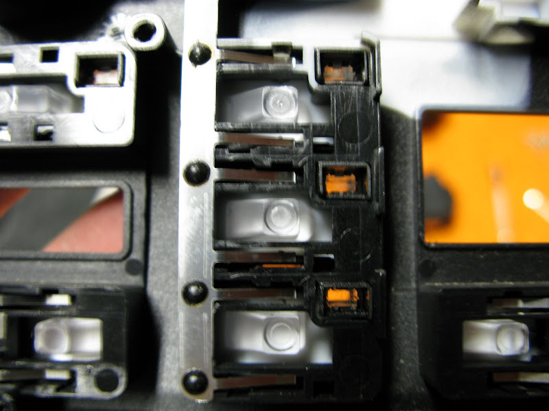

    Tearing Apart the Climate Control

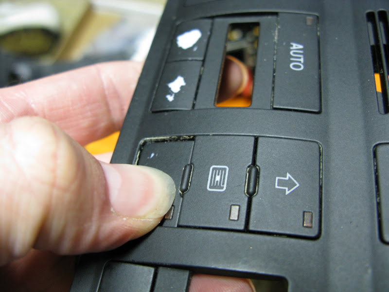

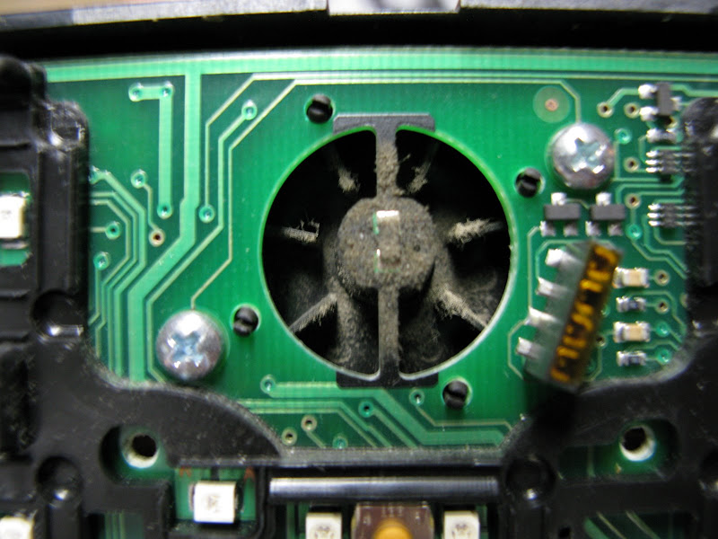

    I started this project 1. becasue everything is out of my center cousel 2. I wanted to clean up the system and LCD's and also try and replace some buttons.
    It was not like the radio I took apart so I could not figure out how to get the buttons out but I cleaned it up nice. I will put it all back together and have a pic tomorrow.
    Here is what it looks like.
    This is the sensor I think. It was caked with fuz and dirt even worse in front of it where the slats in the front part are.
    Filth that you could not get to with the face on.
    After you take the dozen screws out of the back you can pull it apart.
    I missed a step but after you take off the housing you will find another dozen screws on the back of the board to release the face
    Whoever owned the car before me did not take very good care of the car. There was coffee or something sticky spilled all over the dash area and it was in all the nooks and crannies. That and when they had the car detailed they used some wax or something that was everywhere the sticky stuff was not.
    This is that back of the face. There is a metal strip used to hold the buttons in. The radio also has this but ALL the key are removable on the radio.
    That sums it up for now. I will take a pick once its back together and in the car.

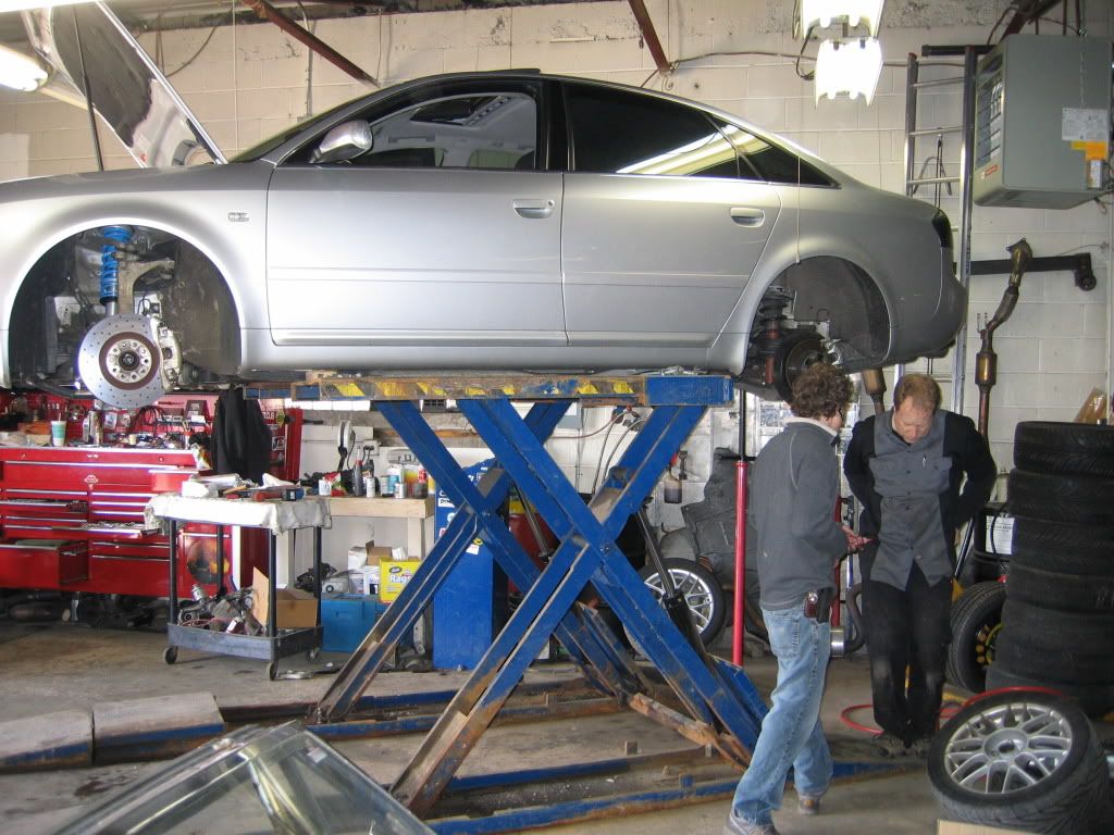

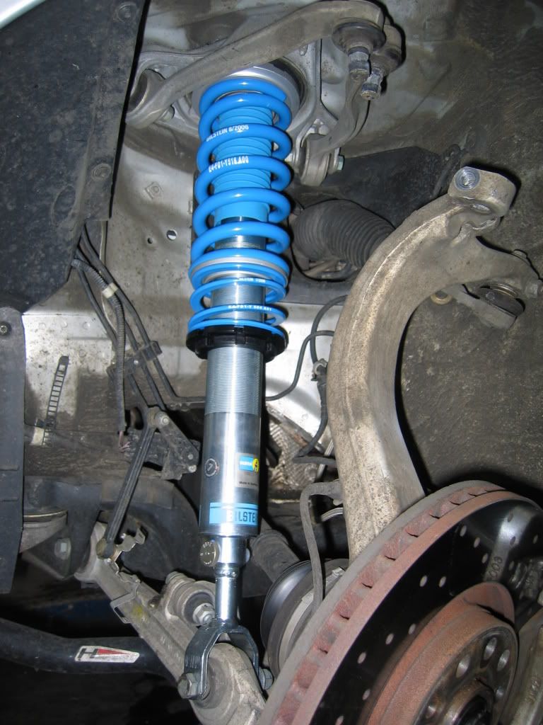

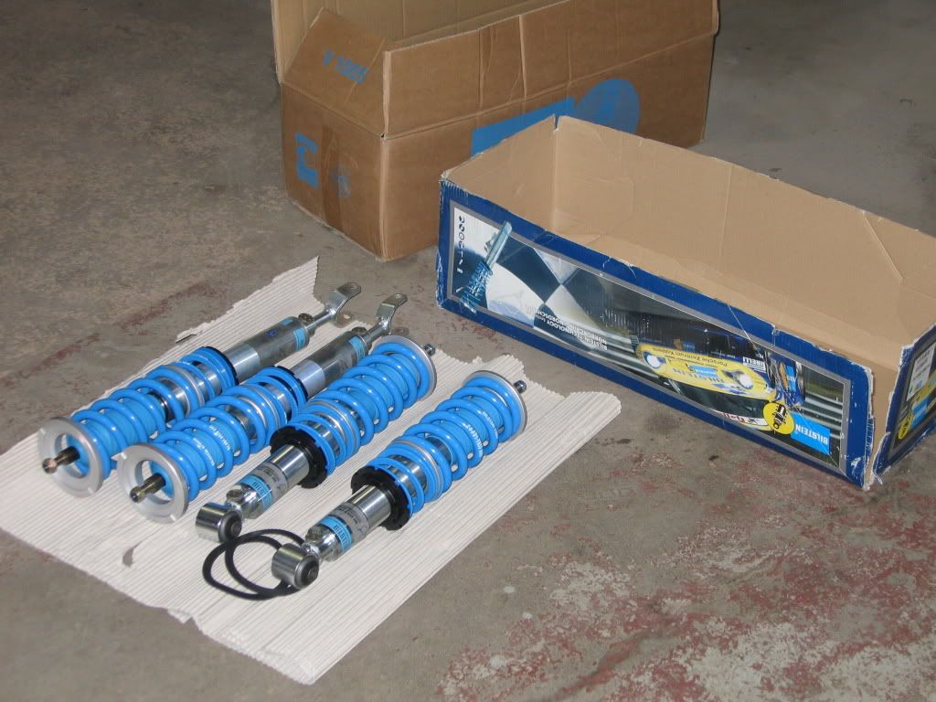

    Blistein PSS9's install in April 2009.
    Before
    Front Installed
    A big THANKS to Peter and Tristan at Further Performance !!!
    It may not look like it in some of the pics but its sitting pretty low already. I may go slightly lower but wanted to let things settle over the next week or so and also get used to the ride height. After the 19's are installed I will be looking at less than a finger gap. ;D

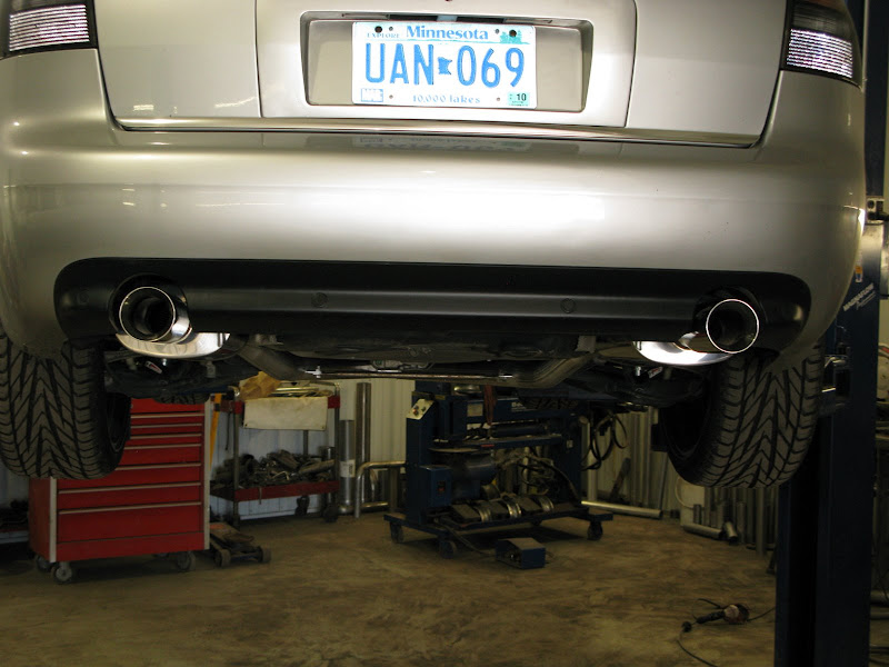

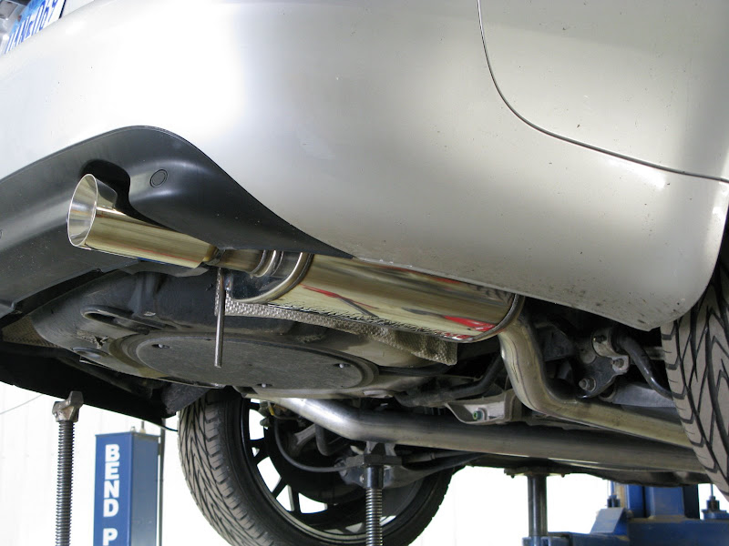

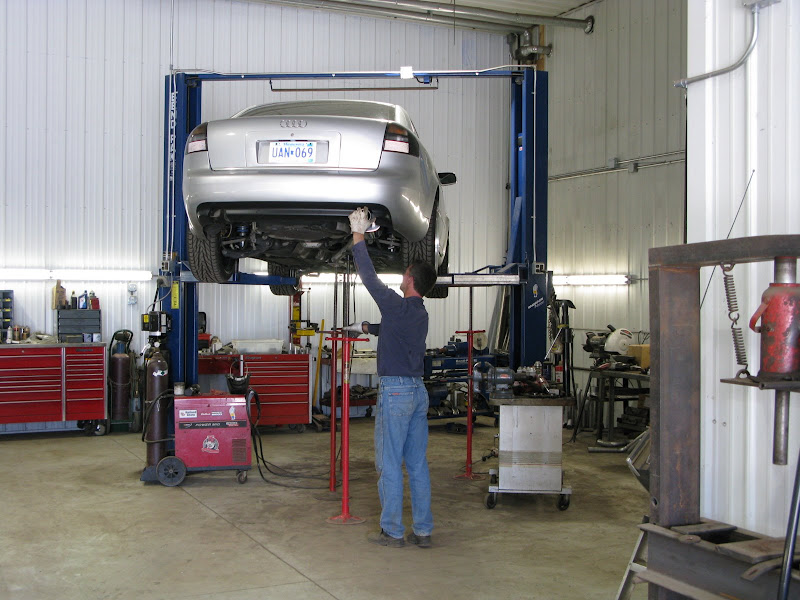

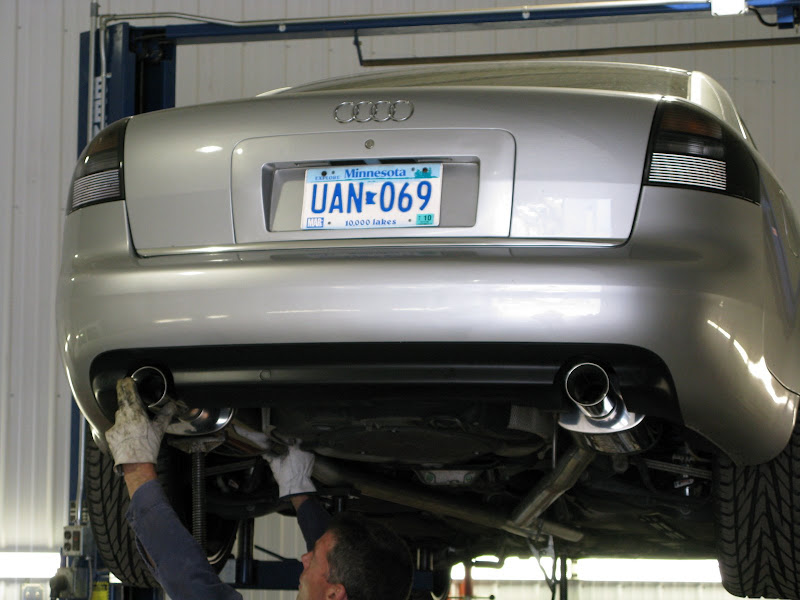

    ** This is way out of order but I will fix it later.

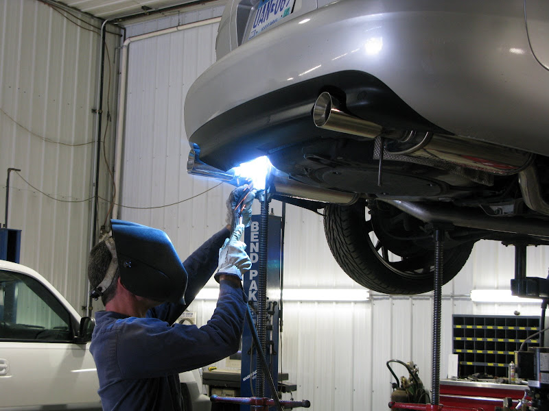

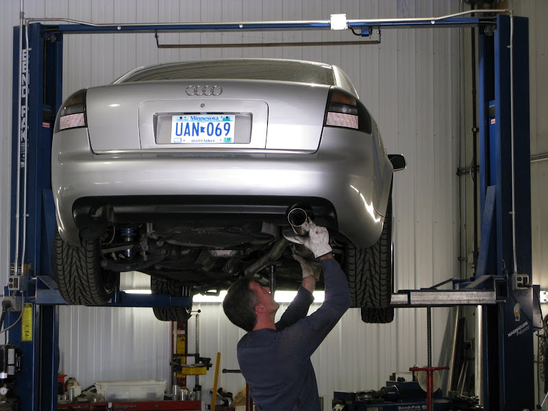

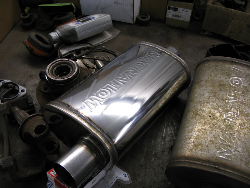

    Gutted precats (main cats in tact) - 2.5" piping - XPipe - Mufflers 5x7ovals
    Sound Clips
    ***turn down speakers because the first part has alot of wind noise***
    http://www.youtube.com/watch?v=adzWK2Gd0Eg
    http://www.youtube.com/watch?v=i-vSwuOglVU
    Bring some reading material. Not much there :D
    Video did not turn out very good.

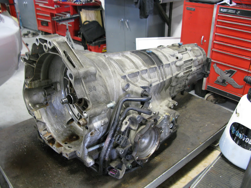

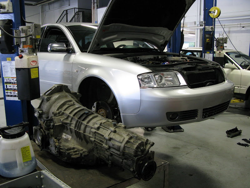

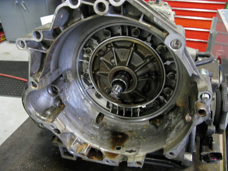

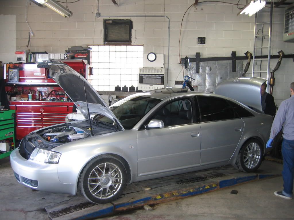

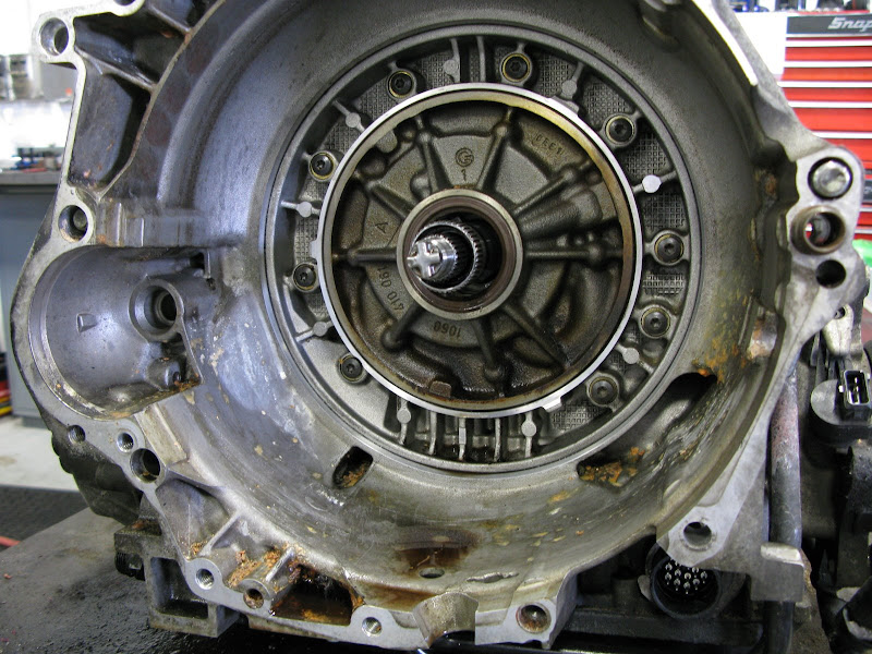

    So I decided to take the plunge and finally have the torque converter (P0741) issue address. Unfortunately this plagues a lot of the C5 & B5 Tip guys.
    After countless hours of research on multiple forums I chose to go with www.517trans.com (Sam) and Imola for the install. I will update with reviews after I have put a few miles on.
    Here is some cross post information that I put on AZ in hopes of helping anyone with the same problem and research. If you have questions I will try and point you in the right direction.
    ___________________
    Here is a list of companies that you can get a TC from not in any particular order. I did my own research and I'm very anal and choose 517, Sam. You should do your own research because I don't have personal experience with any of these companies besides 517.
    1. Level 10 (this is where Sam was when Level 10 had good reviews)
    2. 517 Transmission www.517trans.com
    3. 2 Bennet
    3. 3zero3 (last I checked they put a hold on rebuild and were trying different materials; Kevlar)
    4. JHM
    5. ITP (they also make tip chip and vb, I believe)
    6. Vast (seems to get them from Level 10 but maybe they have changed) (they also have tip chip)
    Under the knife
    Sans torque converter

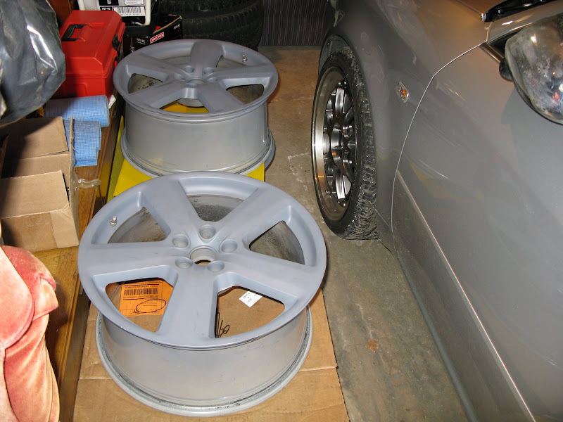

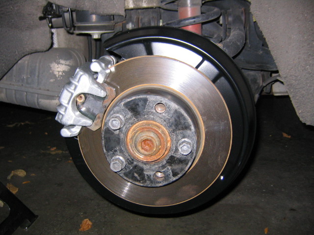

    Brake Upgrade & G2 Caliper Paint
    Rotors - Zimmerman
    Pads - Hawk HPS
    Fluid - Motul
    Lines - Goodridge
    Here is some before during and after (with more to come)
    Left one after sandblasting, look how clean.
    Shows how rusty, normal compared to just the sandblast above.
    Looking a little crusty
    Sandblasted
    Not no mo
    Ready to paint
    Front Done
    Rear dust shield painted
