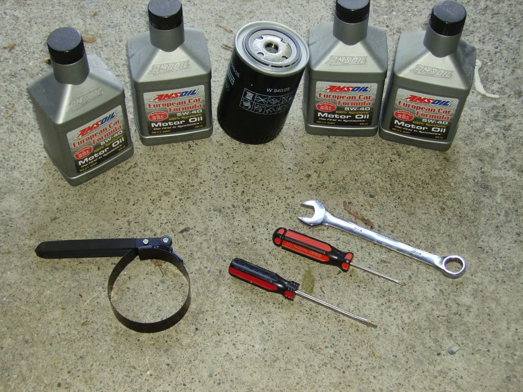

    This is something that should be learned by any car owner. It is fairly simple and takes no more than 30 min to do. My advice for anybody doing their own oil changes is to use Full Synthetic Motor Oil (Group IV) and a relaible filter. Also, you should make it a habit to change the motor oil no longer than every 5,000 miles.
    On a scale from 1-5 with 5 being the hardest, this is a 1
    Tools Required
    4.3 Quarts of Motor Oil (my car takes 4 exact)
    1 Oil Filter
    Filter Tool
    Flathead Screwdriver
    Phillips Head Screwdriver
    3/4" wrench (AWM; not sure if the AEB bottom end uses a different size)
    New Drain Plug Washer
    Something to Catch the Oil
    Jack Stands and Hydraulic Jack/Rhino Ramps
    First, you will need to raise the front end. You will also need to have the car level with the ground to get out as much oil as possible. After you do this, take off your belly pan (you will need the flat head screw driver for this).
    Get all your stuff ready

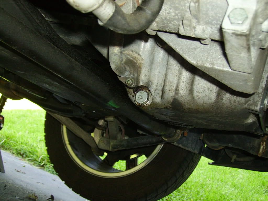

    Locate the drain plug on the oil pan (on passenger's side of oil pan)
    I forgot to take a picture of this step, but you will need to do the following (I will replace this step with a pic upon my next oil change): Remove the crankcase cap (make sure nothing enters the crank case), place whatever you will use to catch the oil with underneath the drain plug (note that it will intitially shoot out maybe 6 inches from the pressure then slow down), remove drain plug (3/4" wrench) and drain oil. Let it sit for maybe 10 min to get out as much as possible.

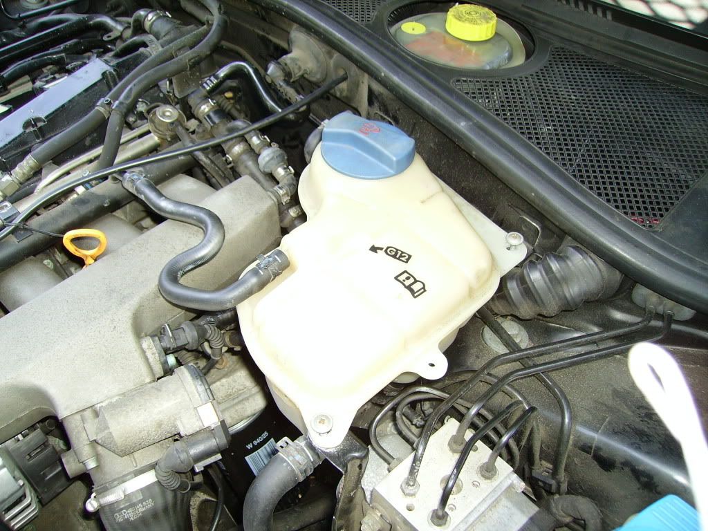

    Locate your coolant resevoir and the 3 phillip's screws that hold it in place. You will want to unscrew those, gently move the resevoir to the right side (make sure not to rip any hoses) and unclip the coolant level sensor from underneath the resevoir.

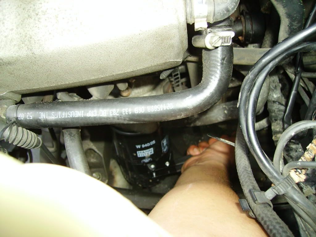

    Removing the filter from the top is the easiest way to do it, but you need to move the coolant resevoir to make room to get to it. Take your filter tool and remove the oil filter. Use the tool to loosen it, then undo the rest by hand (I place a couple rags under the filter to absorb any spilliage which may occur). This can be done while the oil is draining.

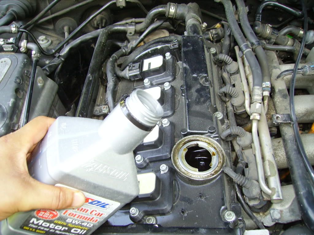

    Place new washer on the drain plug and tightly place the drain plug back. Replace the oil filter (prime the oil filter by filling it 3/4 way full before installing and lubricate the top portion on the threads and around the rubber seal). Place the filter on by hand till you can't turn it anymore, tighten it fully with the filter tool, then loosen it 3/4 turn. Then fill the crank case with 4 quarts of motor oil. Then add more as necessary to reach the desired oil level (mine takes 4 exact). Make sure that you have the crank case cap on before cranking the car
    Place bellypan back on and you're done. Oh yeah, I know my engine bay can use a nice cleaning.

    Re: DIY: B5 A4 1.8T Oil Change
    i find it impossible to get the filter off without spilling. ive tried from the top and bottom and wrap it in bags but it always spills out

    Quote Originally Posted by Bic-Ball View Post
    Jack up the passenger side of the car (only) to get the top of the filter at a better angle. Jack the other side up or lower the car and use an oil extractor to drain/remove your oil once the old filter is removed.
    Me too, especially when you use those giant OEM filters.

    Quote Originally Posted by D's Avant View Post
    youre saying lift the passenger side and then remove it or remove it after both sides are lifted? use the oil extractor where? down the dipstick tube? how would that empty the filter?

    This is what I do when I change my oil. First jack up the passenger side of the car only. Remove the old filter. Then I lower the car and use my oil extractor through the dip stick tube to remove the oil. This takes around 10-15 minutes or so and during that time I install the new filter and check/clean up the engine bay.
    If I didn't have the oil extractor I would jack up the drivers side as well once the old filter was removed and take off the skid plate and drain the oil.

    To access the oil filter, I loosen the hose clamp on the intake pipe at the throttle body and pull it out of the way. Works well too.

    Here's a little tip for a clean filter removal.
    I take an empty 1gal milk jug and cut the top off so the filter drops into the jug. Since the container is plastic, you can push and get it into the engine bay without any issues.
    You can sit the milk jug in the engine as you take the filter off. Then removal just requires you to slowly pull the jug out. Even draining the oil is easier!
