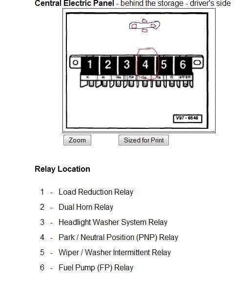

    Hey Chris. I got somthing I want u to test. I was looking at te clutch switch online and it looks like the 2nd switch on the brake pedal, if u still have the relay. Plug it back in and move the Black switch I think it's the upper one on the brake pedal, move it to the clutch and try starting the car without steping on the clutch and then again with steping on it. I'm curious to see if I even need to buy the switch, cause I want it hooked up, I know my parents will move my car when they need too and I will always leave it
    in gear.
    JC | 2002 Denim Blue TT Coupe 1.8TQm
    Past: 1999.5 Brilliant Black A4 1.8TQ

    im interested in this clutch switch idea too

    I sure have tried to start it, I hear a clicking noise of a relay or solenoid but no crank out of the starter. No power at all. Ill take a pic of the relay box tomorrow night and send it to you. Plus I'm going to pull the starter tomorrow night and bench test it. Then if it works, test the hot wires to the starter. But The relay thing has had me on my head for days. Do you think I could push start it? Thanks for looking in to it for me.
    Rob
  31. #151
    Veteran Member Four Rings biketsai's Avatar
    Jun 04 2007
    18558
    01' A4 1.8TQM;15' Wrangler
    Austin/DFW, TX
    Re: Biketsai's DIY Auto-to-Manual Conversion
    Quote Originally Posted by robertjame View Post
    Rob
    Usually you should hear a clicking noise when you turn the key on. If I were you I would just try starting the car using a thick piece of wire and manually powering the starter, I did this to rule out my starter being the issue. I think you could push start it however thats wierd that you do not have anything in that spot.

    Quote Originally Posted by biketsai View Post
    Robertjame, do this before anything else. This will pretty much narrow down your issue to the relay needing to be jumped. You don't really have to use a thick wire either, I used a 16awg wire. Just attach one end to the spade connector on your starter and tap the other end to the positive battery terminal and it should start right up. Its just a 12v signal wire.
    I'm looking now for where your park relay is located on your 97 FWD.

    Yeah that's what I just did, it starts right up, my clutch grabs, shifter is all there, everything is good just cant key start it. I took pictures of my relay panel, Ill up load them in like and hour, I'm filthy. BTW you guys are great for all the help your write up has giving me plus all the tec support, couldn't have done it with out you guys.

    Good to hear, just gotta find that relay position now. Do you happen to see any relays with the number 53 on it?

    opps forgot to put a memory card in my cam lol. no pictures till tomorrow. No #53 relay. There are two relays behind the relay panel, 213 and 214, I unpluged 213 and is shot an auto trans relay code fault in the ecm. but no start. I put it back. but my relay box looks just like yours with out anything in #13.

    Here ya go man. This is where your park relay is. Remove the circles relay and jump the 2 pins circled in my crude MSpaint drawing.
    EDIT: To answer your question about the 2nd sensor on the trans. Like Chris said, the sensor right next the the driver side hub is for the VSS, the other sensor is for the reverse lights. I have yet to be able to to find the right wires to connect to the reverse light sensor. Im currently running with no reverse lights, no biggie, just have to ride the brakes a little when reversing so I can behind me at night.
