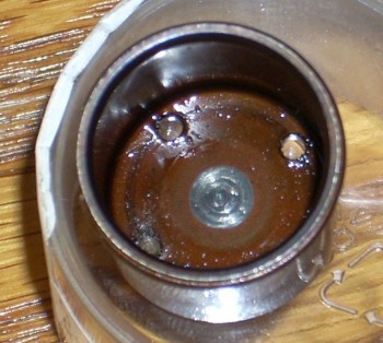

    replaced at a little over 113,000 miles. Worn through the coating and some pitting starting to occur. Stg 1 tune was put on car around 50,000 mile mark.

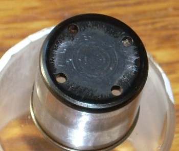

    Did mine today. Just bought this 06 2.0T 2 weeks ago so assume the follower is the original. Here's what I pulled out. Put a new one in but was too lazy to turn the motor to see the cam lobe. You think it was OK based on this wear?

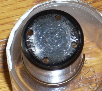

    Mine at 95k :-(
    Indy shop said the lobe looked ok, though I am still within the warranty, so maybe I should be getting the HPFP and camshaft replaced, I'll check with them I guess.

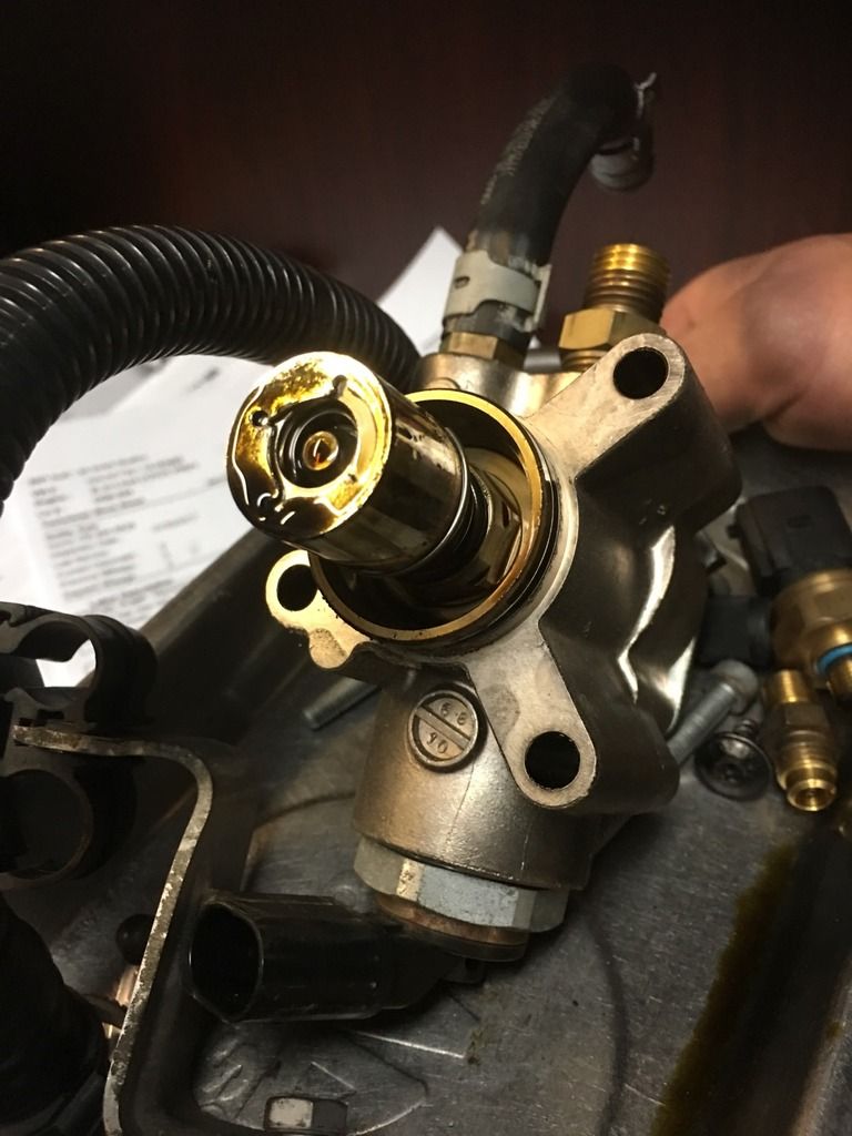

    141k. Bought my car with very little maintenance history because ibis. avant. 6mt.
    Didnt get a picture of the cam lobe, but they said it looks worn. Along with a new cam, installing new JHM fuel pump internals, rear cam chain tensioner, all new gaskets, and the rear coolant flange. Oh, and a JHM HFC to boot!
