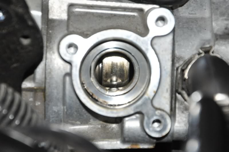

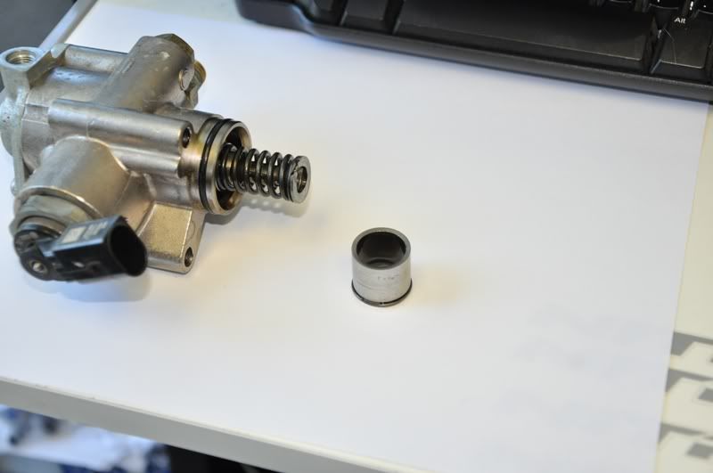

    Ok, so i have my car back now, running my Autotech pump and everything seems fine. Had to replace my MAF sensor as well. Ill have to give APR a call and see if they can do anything about the pump. Im thinking it was something internally so ill see whats up. When i got my fuel pump from them it was nice and clean. I mean everything cant be perfect must have had a defective part or something. Im not too worried about it, Im just glad that i had a spare one to use, i would be on stock mode right now and i would have not been a happy camper. lol
    So yeah lessons learned, if you have a BT definately keep an extra follower around, think ill go ahead and order KMD's follower since its like crazy big and just have it as a stand by. Hope this doesnt scare anyone away from getting a BT, this just happend to me cause i didnt keep a close eye on my follower. Especially with the HPFP it wears out quickly!

    I had mine checked at my 55k serving last week and I fell prey to it also like Sal B7 did out of warranty...
    My follower completely was gone also. Chipped at 20k for past 35k miles....
    My car actually went in 034 Motorsports today to get the revised oem camshaft and hpfp because of damage caused
    hopefully should be all good by this afternoon

    Veteran Member Three Rings WayzataAudi's Avatar
    Feb 18 2009
    38886
    911SC Targa
    Colorado
    Re: Followaar:Official Thread for your Cam Follower(s).
    YAAAY, just pulled the FP today. whew, only had a bad follower, no lobe issues or FP wear. but the follower did have a gaping hole in it.
    old follower-
    new follower-
    FP-
    I <3 Whatever
