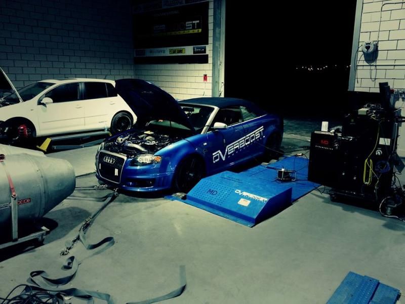

    Well...after a lot of troubleshooting and a lot of help from forum member here ( julex , bobsaver, ilyafil, jibberjive,especialy Andy from Adaptronic and others that helped thank you so much for your help),I was able to solve the weird misfire issue. it turned out to be, lick most similar cases, a silly little think.The map sensor was placed on the runner .It was picking up the intake pulse,screwing up the readings,causing a sudden enrichment and change in ignition timing , that cause the issue...
    I was able to push the car after that .
    Were is Dyno run of a 500whp run...
    http://s76.photobucket.com/user/Pani...e343c.mp4.html
    I had Vp Motorsport 109 and Q16 racing fuel to play with. I used only the q16. I added +2 deg of ignition (added a fuel trim value because the q16 was a lamda of 13.35) and the car gain instantly gain 80whp on the same boost.... Q16 rocks.......
    I has able to take it to 750whp before the clutch broke...... Funny think is that I didnt even had the chance to take on the road to test it (2 friends took it to test the lunch of the car since we wanted to enter it to a drag event on Sunday....)

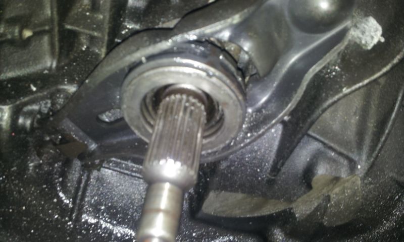

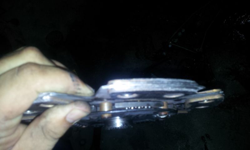

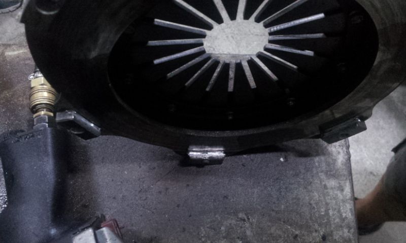

    Engine is out again to check the clutch issue.
    The clutch plate rubbed on the inside of the pressure plate!!. I dont know why it did that....Eurospec doesnt know ether.
    I also found the fitting of bearing bend and damaged. There is some minor damage to the input shaft too....
    Any ideas of what the hell happen?

    Yeap....the fault was due to a missing bearing inside the flywheel. It was not send (or maybe misplaced) .That was the reason of all the clutch issues I had so far...
    I am ordering a fx850 kit this time around.. Hope this solves the ongoing clutch issues for ever...

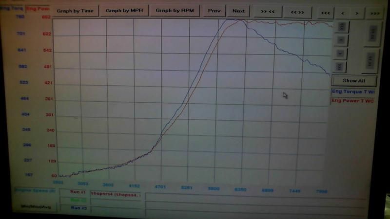

    time for an update on the topic.
    As i said before i put the engine in a b5 a4 quattro. It was way to powerful for the b7 cabrio. the cabrio is still getting a v6 but with stock size twin turbos.
    b5 Car is light and i am doing more to get it to be lighter. now its on the 1240kg mark with a 80kg driver.
    we initially tune the engine in a hurry because we wanted to enter a drag event. car made close to 800 whp with 800 wheel nm. We had issues with the new custom catcams. the cam to lifter was way to big (1.2mm bigger), so both duration and lift were smaller. even the timing was wrong by 1 tooth so we did not have vvt to help spool up the turbo.we also have an exhaust leak from the 2 vbands of the exhaust manifolds. this made the car more laggy than normal. Car is reving up to 8500rpm (solid lifter). here is a video of one of the runs.
    http://vid76.photobucket.com/albums/...psx6lw6end.mp4
    I am posting a dyno graf of a 660whp and not the 800 whp one. we had misfires issues with the rs4 b7 coils.
    as you can see power remains constant at the top end. this shows a restriction somewhere.
    i know for a fact that the rs4 b7 intake manifold is small, but i can not find a bigger one. a custom intake will be nice but who will flowbench it to see if the flow is even in each cylinder?
    i also know that the overprice exhaust manifold i got are all wrong and too small for the type of power. i installed a backpressure sensor and together with the egt it will give me an idea of what is going on.
    I also have a really small turbine housing (.84 ar) . i will change this together with a bigger compressor wheel after the February drag event.

    We stopped at 2.1 bars ,no nos. Power remained constant from 5500rpm to redline. Looks like we have a big restriction somewhere.
    The ported Rs4 intake manifold is a obvious candidate (read somewhere about a flow of 700cfm at 28) .i still didnt find any flow data about the 2.8 heads (mine is ported)
    I am also changing the fmic to a bigger one today.
    I will have to boost the engine a lot since the flow is restrictive.
    Next dyno (this week) will be at 2.8-3bars with nos.

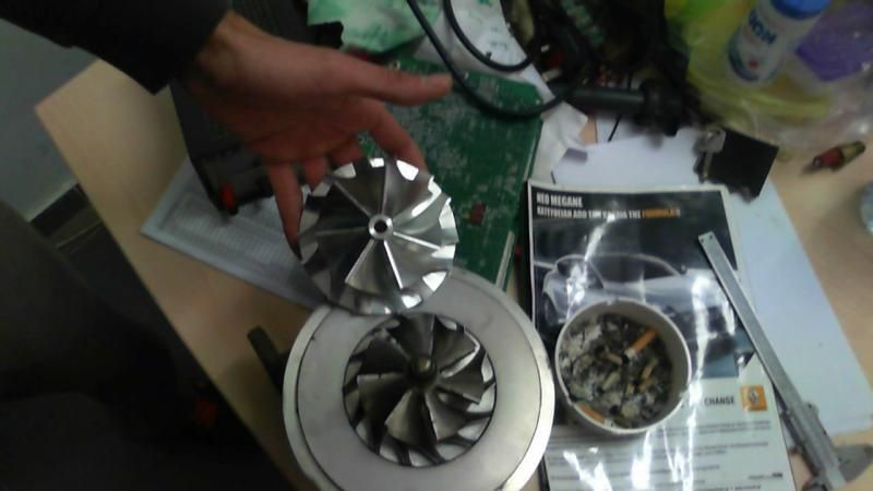

    I am relocating the turbo and changing my efr9180 to something a lot bigger.

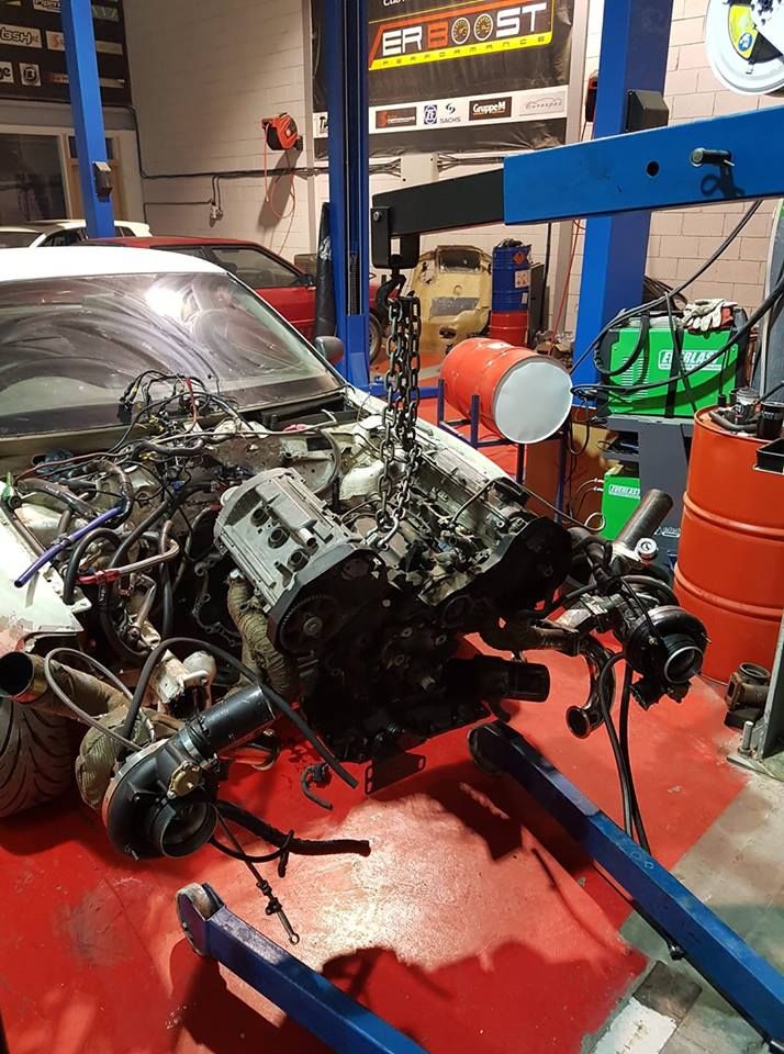

    Car is twin turbo now with twin gtx3071 front facing. Also I am using a 4speed dog box . I am currently installing a Nissan rear diff in hopes that it would solve my on going diff issues.
    Pics are when i was doing mokeup with twin 9180 efr. It was too laggy so I when to gtx3071r. Power is at 950 awhp Mustang Dyno. Trying to push pass 1150 whp now...
