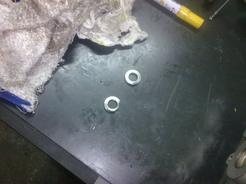

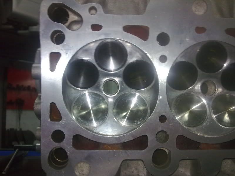

    Well… Thinks are getting from bad to worse…..
    All of you who have supertech valve springs kit (from 034 ) please read this…

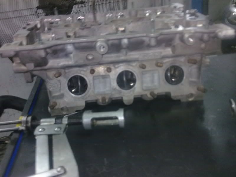

    I had a professional do the head work but he did not clean the heads…. So I had to dissemble the valves and springs ,clean the heads and reinstall everything.

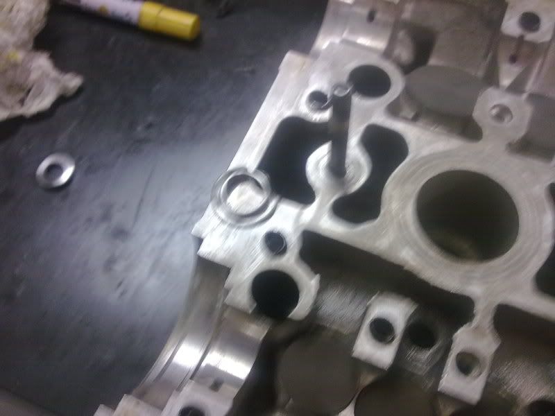

    Imagine my surprise when I saw this…
    This is completely new and unused spring kit. 6 spacer are crack , 2 of them have a lot of material missing… I doubt that it was cause from a bad installation.
    Thank god I dissemble the head and saw it……I cant think of what would happen if I installed it as it was on the engine.
    So now I can work on the heads until I receive new replacement spacers….
    On top of that I realize I was send the wrong rod bearings. The ones they send me where 1.5mm oversized. So I have to wait again to get the correct rod bearings….
    So I can not even work on the block..

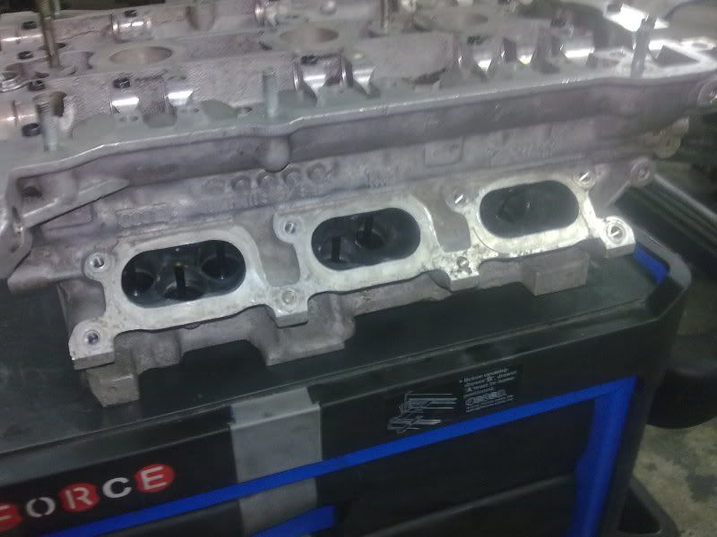

    Pictures of the heads...Port &polished 2.8 heads

    so what did 034 have to say??? Wow, I can't believe you caught that... Lucky guy

    I am stunt myself.....I can believe no one notice it before. I don't even know if anyone ever look after they install them .Maybe is an isolated event.
    The machine shop I used for the head work is called DRAKOS. It the best machine shop in Greece and I live in Cyprus...I send the heads all the way to Greece just to have them work on them. I dont think it was the machine shop fault
    I did not email the pistures to 034 ...I just got back from the shop...
    I ordered new spacers from a third party supertech vendor which responded faster.

    Good luck with the heads. Other than the spacer issue they are looking great.

    good catch with the bad hardware

    Good thing you decide to clean your heads.

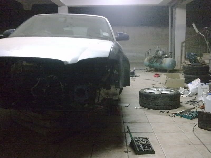

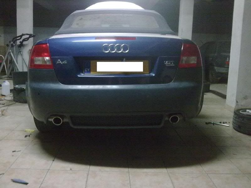

    Well......
    Motor wise I have installed the pistons and rods.....I am still working on the oilpan.....The girdle plate is a major pita.................
    I had to play Picasso with the dremeler on the oil pump(Have to remove a LOT of material) and oil baffle.... funny think is that it does not even list them in the installation instructions... I should be done with the oilpan today and move to the heads...
    I have been busy with wiring too.....I think I have the wiring sorted but I still need to test it on the engine once that is done........
    As for the body I installed the rear bumper and right front fender....

    No sorry. What's the big issue with the hood you have?
  32. #72
    Jun 22 2009
    44077
    Dundalk, MD
    Re: Just another Built post
    Quote Originally Posted by Reich View Post
    it seems like he wants a CF one but no one makes it
  33. #73
    Feb 24 2007
    15896
    Nicosia,Cyprus
    The cabrio models have different A-pillars...There pitch is different. So the fenders and motor hood are different in the cabrio...
    I got a sedan hood so I need a cabrio motor hood

    What kind of power are you hoping for? and more importantly, what rpm do you expect full spoolup at?
    I put some GT2871R's on my 2.7 RS4 engine with 2.4 NA heads ported and polished, with .64 AR I am getting full boost (1.9bar) @ ~5000 rpm, 1 bar @ ~4000 rpm. Reving to 8k and made around ~700 chp. I would have liked spoolup a little quicker so will be keen to see how yours does :)
    Good luck mate :)
    where do you get these 2.4L N/A heads you speak of? WHat are the advantages and dis-advantages?
    Quote Originally Posted by revhards4 View Post
    the 2.4 heads are from europe and they flow way more then 2.8s or rs4 heads. There is some info in satan's child's thread.

    Why would the 2.4 heads outflow a 2.8 head? both are ported....

    Quote Originally Posted by the dog View Post
    the 2.4 and 2.8 use the same size valves but iirc the 2.4s have more material to work so that the flow can be optimized. I'm by no means an expert on this but I remember a post by OZZ or Satan's Child saying the 2.4s will outflow the 2.8 heads. Both of these guys have spent between 5 and 15 thousand dollars on different heads so I would ask them for the info since they are probly the most knowledgeable on the subject around here.
