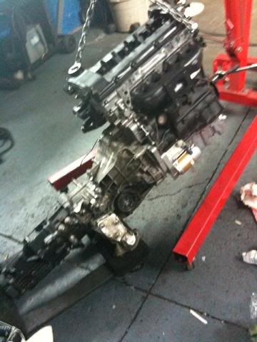

    Whoa a lot of people going this route... I wish i was... ;0)

    Justin- I have been waiting to see some pics of the no name persons build,lol. I cant wait man.

    Very nice parts you have there NYCVR6, Good Luck with the build

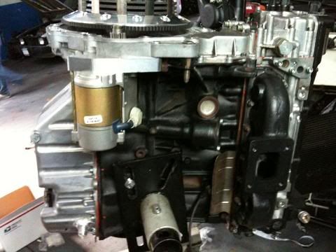

    The bellhousing adapter is an OEM part, correct? If so, why do you need a custom flywheel and starter? Shouldn't there be an OEM starter and flywheel that would work?
    There is an OEM starter and an OEM flywheel.
    OEM Starter motor - $650+ USD
    OEM Flywheel - 35lb dual mass unit and costs about $500 USD
    If we thought it would be cheaper to offer OEM parts,trust me we would have....

    I believe the factory adaptor is meant for the FWD transmissions and the unit used in the Touareg/Q7. It is needed for this application to bolt up the VR6 longitudinally to the 01E transmission in the B5 chassis.

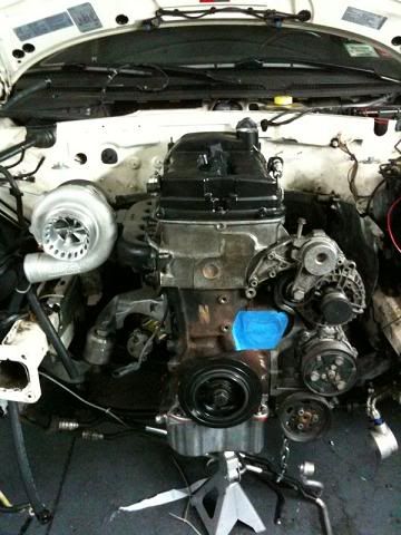

    Quote Originally Posted by NYCVR6 View Post
    Looking good, what turbo r u using

    Quote Originally Posted by antoanS4 View Post
    Thanks
    Precision billet 6765

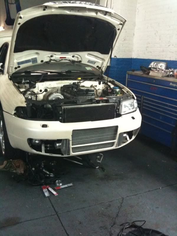

    Your install looks real good! What mods were required for the oil pan?

    Quote Originally Posted by Big Boost View Post
    None
    No mods to the oil pan or to the subframe.

    Active Member Four Rings NYCVR6's Avatar
    11355
    Queens, NYC
    Re: *** OFFICIAL VR6 -12V & 24V FAQ and Info sharing ***
    Good luck to everyone who wants to do this.. I just want to go on the record for saying this... lol
    Swapping out the intercooler, it doesnt fit.. Not the only thing..
    Looks like your making some great progress, keep up the good work, you'll def be rolling around before me..
