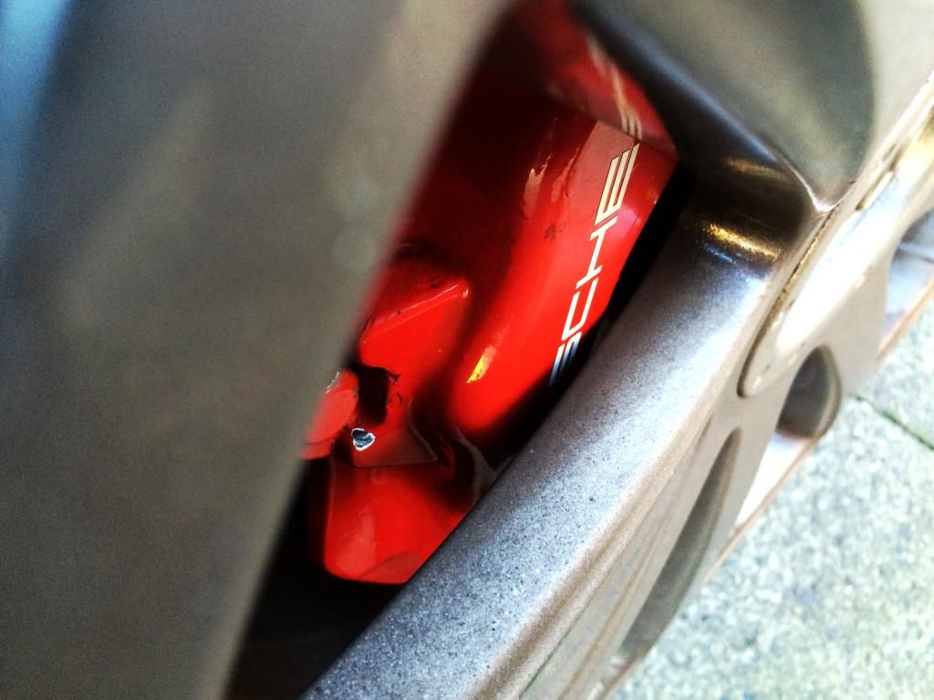

    So I went to track the other day to do some lapping…. get home and wash my car and I notice the brake dust is BAKED into my freshly Powder coated 18Z!!!! Very disappointed. any idea if this can be cleaned off or not and how? figured id post here since this is the most visited Cayenne bbk thread and most are powder coated.
    Soak with simple green. Switch to ceramic pads.

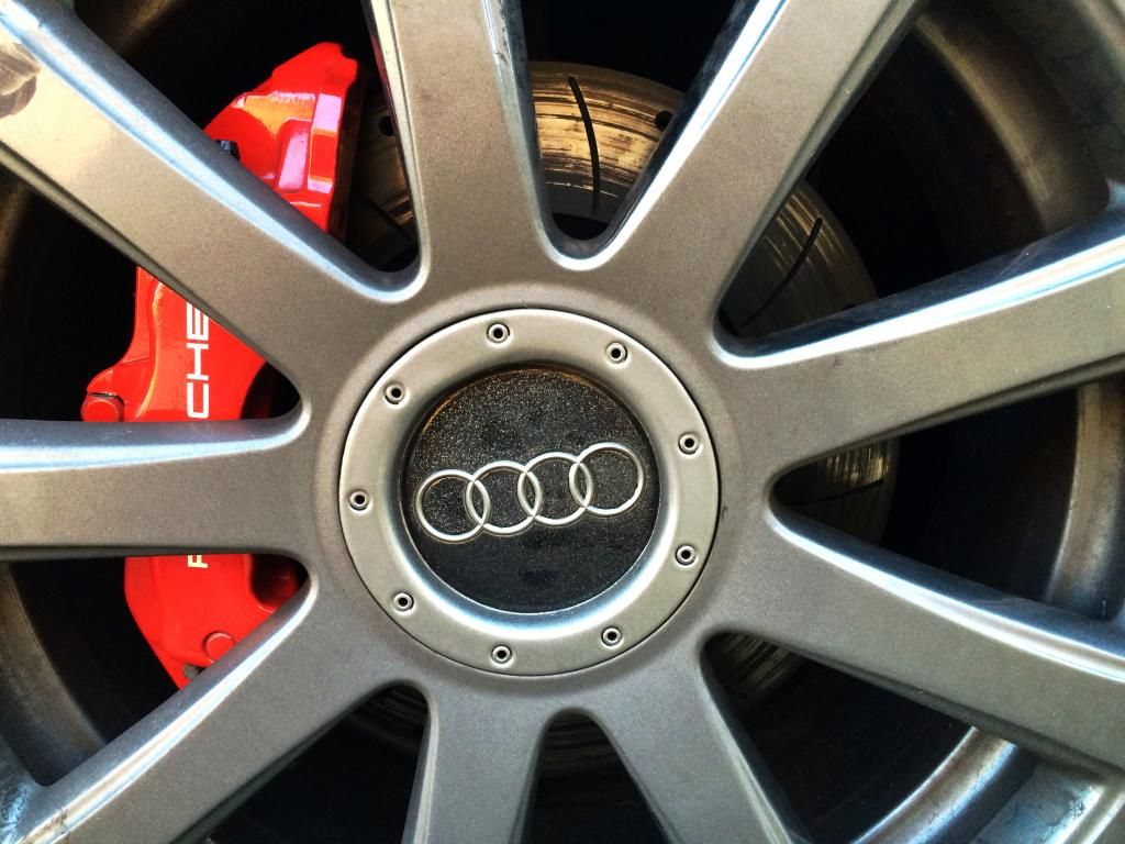

    Ok so this is what I have to deal with. I've tried Sonax and Grime Off to little effect. Any suggestions for a harsher solvent? I'm gonna pull off the wheels and start scrubbing with a tooth brush.
    Anyone experience this before?

    Quote Originally Posted by gmdiluca View Post
    Most powder coating has a softening temp of 80C and a melting temp of 150C. High heat paint for calipers are good for at least 500C even in a rattle can. None of the 18z are powder coated at the factory. Very few OEM calipers have PC. Hard Baked Painted any day over PC. Brembo calipers come painted, not powder coated, from the factory.

    Quote Originally Posted by bobkatkat View Post
    Yep. All high end Brembos are painted. I believe powder coating also traps more heat inside the caliper compared to paint, leading to higher fluid temps.
    Of course, for people who just want a durable finish for street driving, powder coating is a good choice.
    Great advice! but I was trying to say a lot of people rebuilding these callipers are PC them not saying they come PC from the factory.
    Looks like they are gonna have to come off to be painted properly that way I can look good at shows and track her now and then. (wish I knew this earlier)
    Thanks for the help! I'm still open to suggestions for cleanings these things because they aren't coming off to be painted until the winter...
    Most likely the brake dust has fixed itself to the PC. You could try rubbing compound or scratch remover and buff. Maybe hit it with some clear caliper paint after you get it cleaned up to keep it from happening again until you can remove the PC and paint.

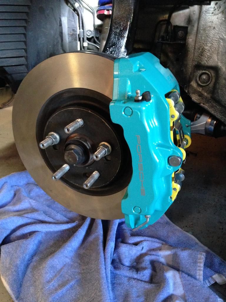

    Can someone take a picture the brake pad sensor plig thats on the car?
