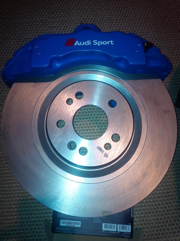

    heres what ill be working with

    So i have a problem. How do i trick the car into thinking the pads are in good condition/ not worn down. The pads i bought DO NOT have the sensors built into them. Now i assume a resistor might solve this? Anyone that can help please do! Cars torn down and need to get it back together b4 subday!
  23. #1143
    Veteran Member Four Rings Timtheguru's Avatar
    Dec 30 2009
    52711
    Quote Originally Posted by canadianA4B7 View Post
    All you need is to connect the two wires together, aka bridge the connection.
    I used the old sensor connectors from a set of worn out pads and twisted the wires together and heat shrunk the connection with weatherproof heatshrink stuff.
