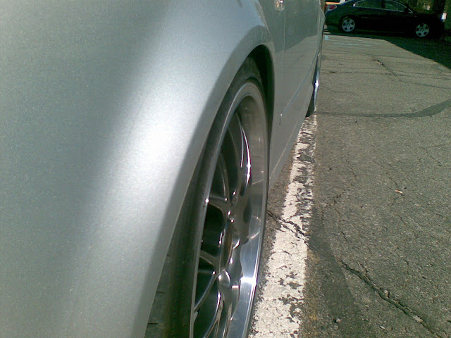

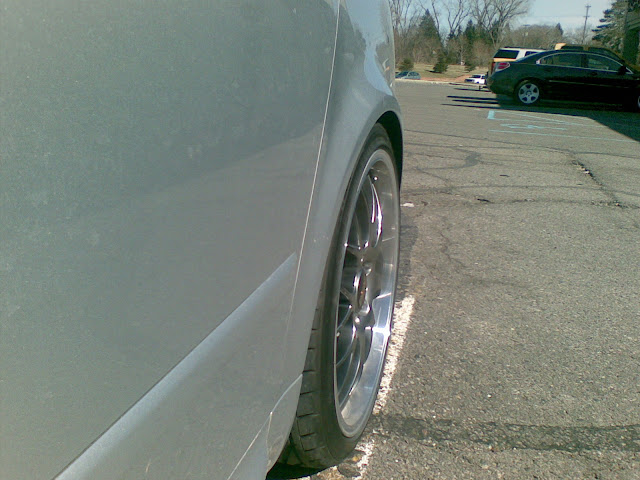

    Here is some pictorial for comparison. Crappy Phone pic of RSGT's.
    Front:
    Rear:

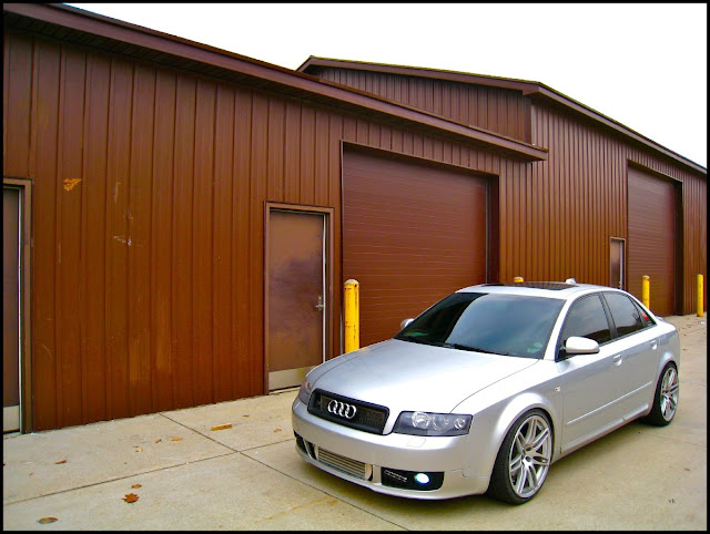

    Pic of RS4's
