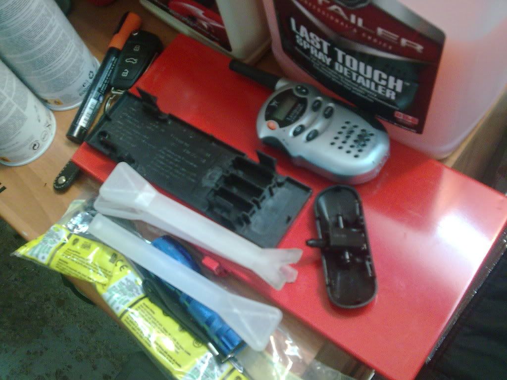

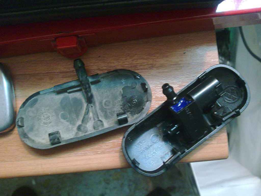

    The heated nozzle I bought
    (#5M0 955 986 C which replaced the #5M0 955 986 9B9)
    And here it is, VS the A4 non-heated one I had from factory...

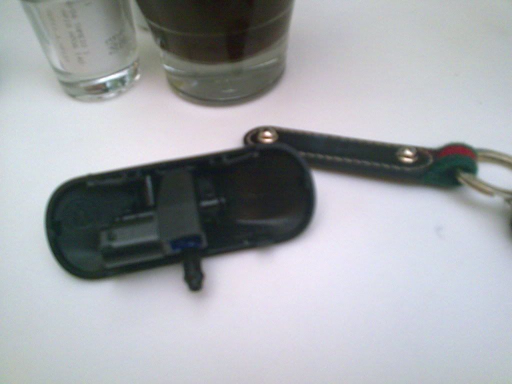

    Quote Originally Posted by redlegs13m View Post
    how do you know if you have heated or not is there an easy way to tell?
    Yeah, take off the nozzle you have on your hood, just one, and see whether it has
    1) Just the pipe for water, so it is not heated
    2) both the pipe for water, and a socket, so it is the heated one.

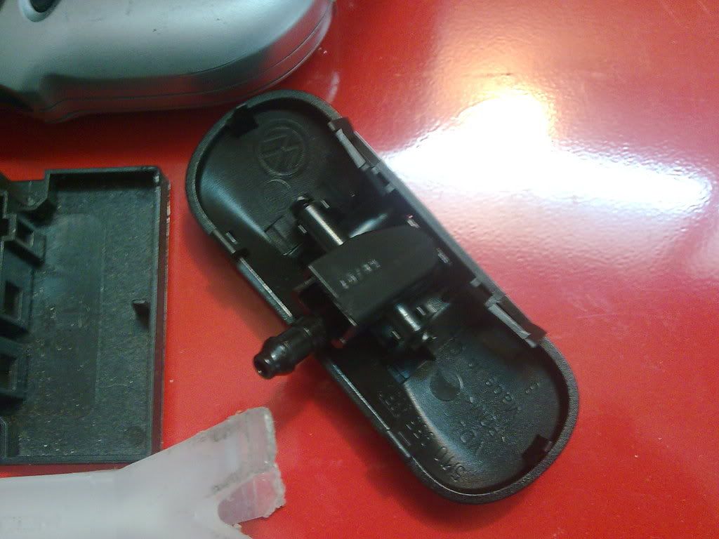

    Chcked the Golf's nozzle part number, the non-heated one:
    It is:
    # 1T0 955 985
  19. #59
    Veteran Member Four Rings Doctor's Avatar
    Jun 02 2008
    29451
    A4 B7 20vt Quattro,Golf MKV GT
    Greece
    Re: Audi A4 'Water Pistol' to VW Passat 'Fan Jet' Conversion....
    Quote Originally Posted by Doctor View Post
    It is:
    # 1T0 955 985
    Which is now replaced with part number
    # 5M0 955 985 C
    and looks like this:
