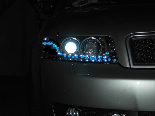

    Re: Rough prototype A5/S5 style LED headlight done
    Quote Originally Posted by golgo13 View Post
    I definitely agree on the stripe of leds to go all the way where the corner light are.
    I'm going to take a look at that tonight. It's a simple move to slide them over as the plastic base isn't attached to the original housing anywhere yet.
    I did it the way it is because I was trying to flow off of the seam of the space between the hood and front fender. Kind of like an extension of that line. But, I can see where sliding it all the way over may work, too. But I think I'd still want to extend the straight line across the bottom over to where it sits now, at least. I'm not sure that stopping it in the middle of the headlight would look right. We'll see.

    I see. This is a pretty ambitious project (In a good way). What were your thoughts on putting both notches facing the middle of the car? What about the notches facing each other? It would look like the four rings emblem. Does the notch have any impact on the beam from the projector?
    How to account for this massive success? Pure luck? Transcendental meditation? Machiavellian manipulation? Aerodynamics? High colonics? We haven't the slightest idea. -P.L. Newman
    Veteran Member Four Rings rxrep's Avatar
    Feb 28 2006
    10607
    has nothing in it but memories.
    Pittsburgh-Philly
    Quote Originally Posted by Hamotee View Post
    Like this?
    That was original design before I even started with the LED. Then, I started figuring that if I ran the LED across the bottom like I'm doing, then I could turn both notches down and it would appear like they never had them. The notch doesn't affect beam because the lens stays stationary. Only the surrounding "notched" trim spins.
    I wouldn't say "ambitious". Shaving the seams on my bumper was ambitious. With plastic fab know-how, this is all pretty easy and can be done quick. I just want to take my time and get it to look as close to what Audi might've done (if they made this for B6) as possible, not just hack away and throw an LED strip in the easiest/fastest way I can. For those who need the car as DD, it would be tough. But mine is in pieces all winter for the engine build anyhow.

    Update. Tried this pattern. It isn't totally straight and level across the bottom, as I was just tossing the idea around. I also made the LED further apart at 3cm (from 2cm on the last pics).
    Knowing that this version was just thrown together when I got home tonight and will be made perfect if I roll with this, which do you all prefer, and why?
    This:
    Or this:

    thats not what i meant though.
    keep it like the firstbut end it where the corner is. It looks great though I want a DIY asap please
    SweetnLou!
    Feb 28 2006
    10607
    Pittsburgh-Philly
    DIY would mean that I take pics while I'm brainstorming, lol. That'll never happen. I can never think to take a pic when my brain is more in to what I'm doing.
    On the LED pattern, do you mean like the first way, but run the strip all the way to the edge closest to center (past the high beam projector)? I like that much better. I'm not sold at all on the latest design taking all the way over the fender line before curving up. It looks strange when the seam of the trunk and fender are over towards center like 3 inches.
    I'm not sure what was meant by "running light" as a reference point, then, as on ecodes, there is only a turn signal. The running light on e-codes would normally be a small bulb in the huge high beam housing, but since that's replaced by a projector housing, the running light wires will be used for the LED's.
    On the "corner light plastic piece", do you mean the clear lens cover?

    maybe if the corner light little plastic piece is removed it would look better

    [IMG][/IMG]
    I know my photo shop skills are beyond amazing but what do you think?
    I know my photoshopping skills are beyond amazing but what do you think?
    That's kind of what I'm trying to avoid. Sometimes the simplest answer is the best. I don't want to get too creative on the design. I'm trying to follow the lines the car itself gives, not just the headlight bulb housings. And I don't want more than one curve, and no more than a 1/4 circle anywhere.
    I've tried a bunch of stuff like your photoshop, but nothing looked natural. It seems like a good idea, then you put it in and fire it up and say "WTF was I thinking"?

    [IMG][/IMG] ITs obviously completely up to you sir but i think this is a hit.

    where you have it right now is the best. Don't touch it.
    That will be absolutely killer when you finally get done with it.

    This is still my favorite:
    But, I want to extend the LED out more towards the center to make the straight across part a little longer. Which will work nicely once I add some more space between the two projector housings.
    It flows out of the hood seam better, and is easier to fabricate and overlay with CF. The design from tonight in the pics above where it goes all the way past the turn signal and curves up won't be easy because I'm using single LED's on the final version, not the flexible strip used in the prototype. As such, I need room behind it all for the LED wiring. That isn't a problem all along the bottom, or behind the "curve up" of my original design from page one. Over past the turn signal, however, that would mean I'd have to build out some plastic, or drill through the headlight lens to have the LED sticking out of the back of that portion of the headlight and in to the space behind the fender. Not fun.
    All youz haters can make your own damn design, lol. I'll come back to it this weekend and see if my thoughts are still the same. Sooner or later I'll stumble on the design that just "works".

    That's the best one so far, I would like to see the LED's all the way towards the center grill.

    Exactly the way you want it, the way it is but extended more towards the grill, will be perfect. Rotate the projectors like you said, and move them to where there is a bit of seperation and less dead space at the inboard side of the housing. I think it's an excellent idea and if executed as you plan, it will look great, and almost OEM+.

    Lee, great work so far. I'm with you and agree the first design looks better and have the LEDs extend all the way towards the center.
    Curious question on high beam projector. Is that also going to be Xenon to make it a dual Xenon setup, or are you still using the halogen bulb? If Xenon, is there any delay when flashing the high beams?
    You always come up with some great ideas and mad skills to pull it off!

    Thanks Paul. I guess the stupid college elective classes in sculpting are paying off with heavy use of modeling clay to form the mold, lol.
    As for the high beam, I'm keeping it halogen. Simply for the reason you'd stated. Xenon takes too long to fire up. I figure if I use some uber-white knock-off H7 halogens, it will be pretty close to matching the xenon lows. Since I ripped out any beam blocking metal inside the high beam projector, it is like a blitzkrieg light now anyhow. It lights up everything.
    After looking inside the projector housing, I can't believe how much of the light output is blocked on the low beam.

    The coolest part is how the cutoff plate is on the bottom of the projector...I am viewing everything upside down right now

    Do u have Bi-xenons? if not what it does is when u flip the high beams on the cut off plate folds down to allow as much light as possible, if u had bi-xenon lows and H7 uber white highs with no cut off plate u'd blind at least 4 people.
    Quote Originally Posted by AudiA4Turbo22 View Post
    Nope. Just regular old Xenon lows and halogen highs with the cut off plate removed from the highs.
    If I even see four people where I live then the state prison must've had a breakout, lol.
    I'm on the edge of civilization, and I rarely use my high beams. When I do, I want the baby Jesus to light up the night sky for me.
    I ran the whole setup tonight. Let's just say I can't get a pic because it just turns out like a flash of white. Low beams are normal since the cut-off plate is still there for those. When the highs come on, especially with the fogs too (my fogs stay on with high beams with the VAG mod), it is pretty blinding.

    Verdict is original pattern with extension towards center, and more separation between the two projector housings with the lens surround trim notch pointed down. Hope to have one done this weekend with the LED strip; I'll prolly have about a 4 week wait for the single 10mm super bright single LED's to arrive (the LED strip only has tiny 3mm LED's).
    Quote Originally Posted by absolutegtr View Post
    Not sure I follow. The low has reflection from camera flash because of the metal cut off plate. It's still in the regular position and will be even when I turn the trim around for the notch to face down. It appears as though it's on in the pic but that's just flash. The high beam, however, has no cut off plate in it anymore at all, so no reflection from the camera flash.

    Separated projector housings some and flipped the low beam lens trim notch to the "down" position. Ghetto pic, but you get the idea. Putting LED backing piece back in tomorrow and may be doing CF overlay on Sunday if all goes well.
