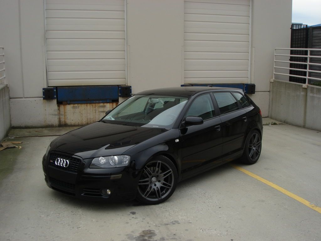

    I have ran coilover setups in lots of cars but on the A3 I thought I would try the Cup Kit Sport because of all the good things I have heard. I am extremely pleased with it in everyway. I am running 19" RS6 wheels (et45) with no rubbing issues at all (I didn't even remove the rear inner fenderwell screws). The kit rides extremely nice and doesn't seem to beat me up as much as my FKs, or BGs that I ran in other vehicles.
    Good luck.
    The pic does not do the ride height justice. It sits very low in person.

    I have the exact same car except I have the 5 spok wheels. Color tint everything is dead on and I like the look. Glad to hear that you did not have any issues at all with rubbing. I'm looking to go no more than 45 offset as well so this is definitely good news. I guess I will be going with the sport cup kit then. That is waht I've wanted to do and that stance is just beautiful. Thanks for the info man.
