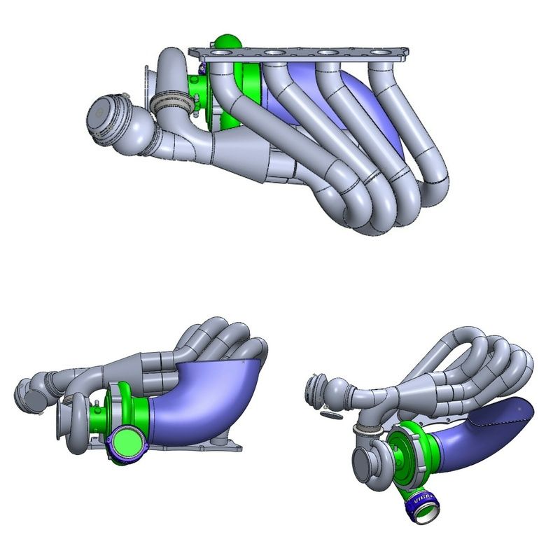

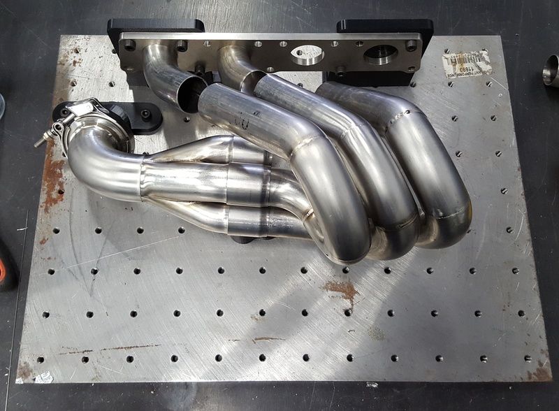

    Since inconel is very expensive I figured I would plan out my manifold before making all the cuts and possibly making mistakes. It's a bottom mount configuration and the intake of the turbo will be carbon, I also tried to move the turbo back as far as possible to get it closer to the center line of the axle. The turbine inlet of the turbo sits two inches above the top of the frame rail.

    Beautiful. What size runners are those?

    2.125" into turbo with 1.625" primaries.

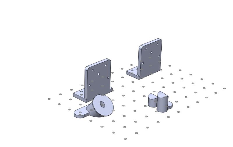

    Jig for the manifold... should be printed by tonight.

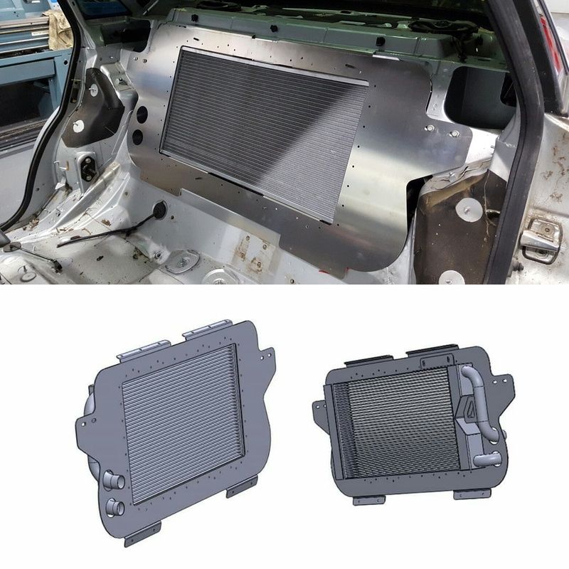

    I finished relocating the rad to the trunk passage. Again the fit turned out pretty good. Now I just have to finish up the tanks and hoses. From the rad I'll run hard lines to the engine with a electric pump somewhere in between.

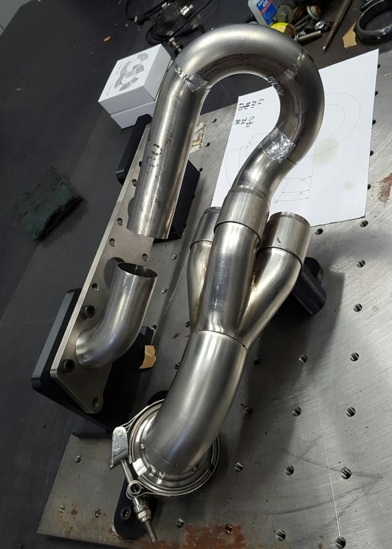

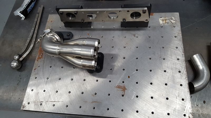

    I got the header started...design will be as shown earlier all in inconel.

    Can't wait to see this manifold. I'll take the stainless prototype one off your hands when you start maming the inconel ones

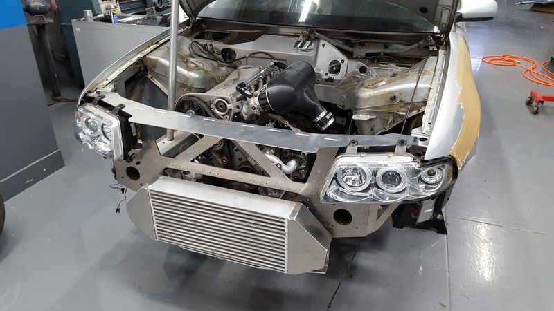

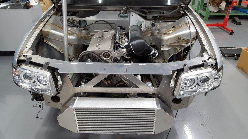

    I dropped the engine in today to get more mock up done. Looks like I may need to put a 1" bubble in the hood... I'm just fine with that, because racecar.

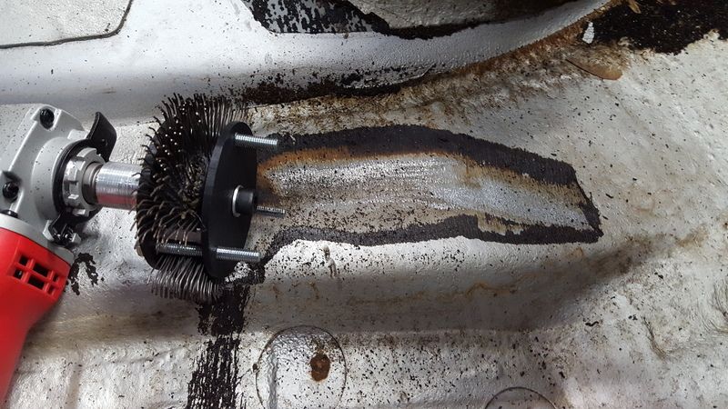

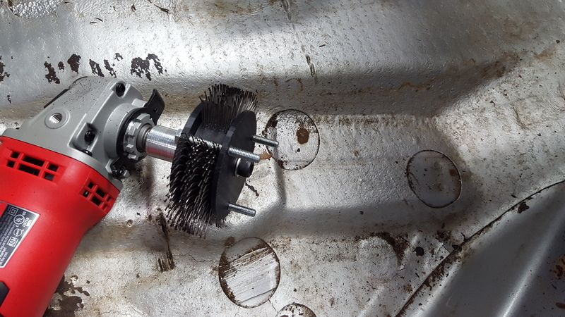

    I haven't posted in a short while... recently I made a holder for a Dent fix brush to take out all the tar and insulation for seat and cage prep. I've never had good luck with dry ice on these cars, this works pretty good. This was done in a few seconds

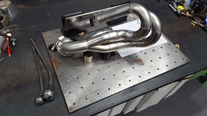

    I also got going a bit further in the turbo header
    For some reason I think this idea is super awesome.
    How do you plan on ducting air in? And what about air discharge?

    ^ I saw him cut out the trunk lid probable for air movement, im guessing he will put some electric fans on there pushing air from inside car through the rad. My guess, interested to find out how he will do it.

    Would a fan be able to move enough air through the radiator to cool efficiently in a location like that?

    Quote Originally Posted by fR3ZNO View Post
    If I can find the video I'll link it, I've seen something similar to this. But I imagine he'll make a duct down from the roof, should have plenty of airflow with the duct and fans pulling.

    Yes air flow will come in through the rear doors.

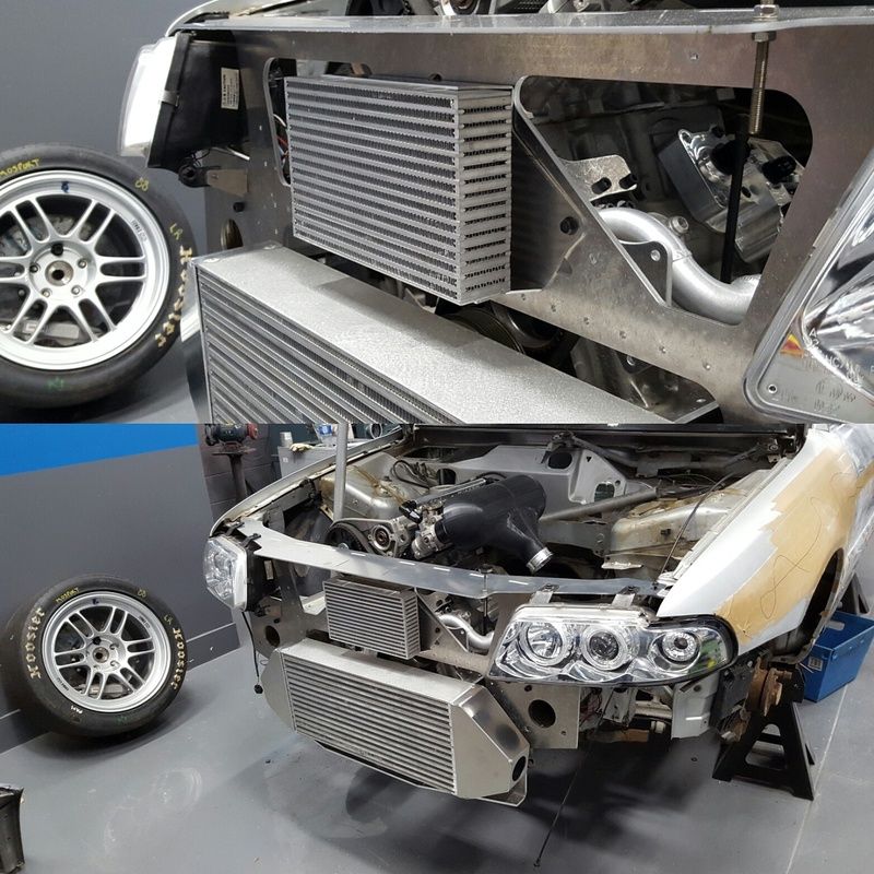

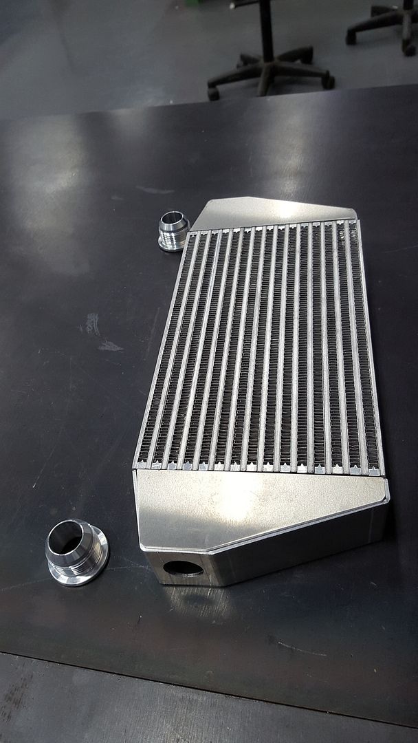

    Its been a while since I posted, I've been occupied shooting a few episodes on Powerblocktv. It was fun. Yesterday I mocked up the oil cooler. It's fitting well.

    Thanks... the manifold is getting slowly completed.

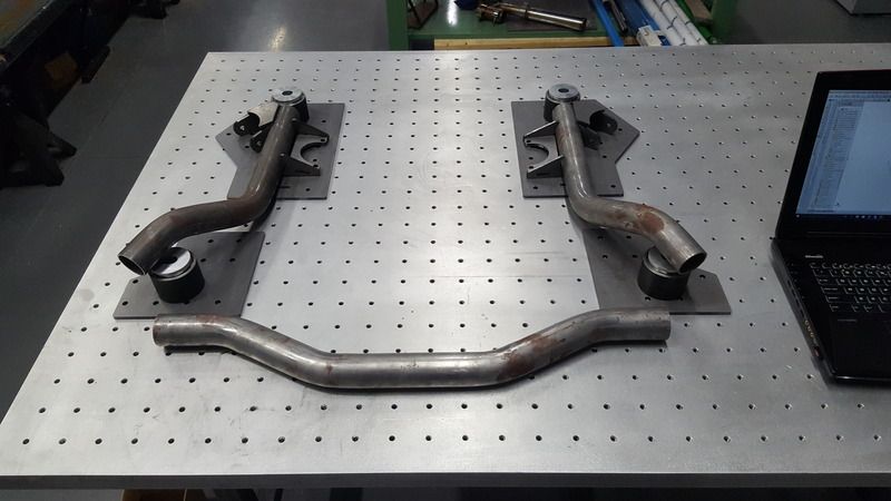

    Maybe some of you have seen the front subframe I designed earlier.

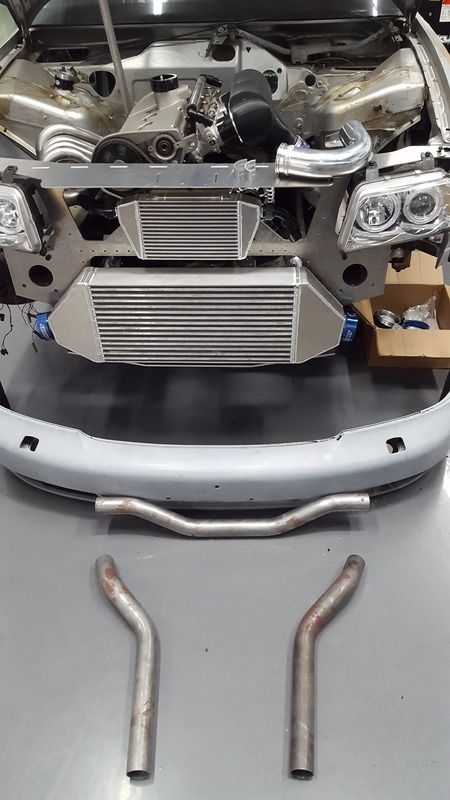

    I finally got the tube order back from bending. I'll get the jig table set up shortly to weld one up.

    I have made a few so far. Here's one in progress.
