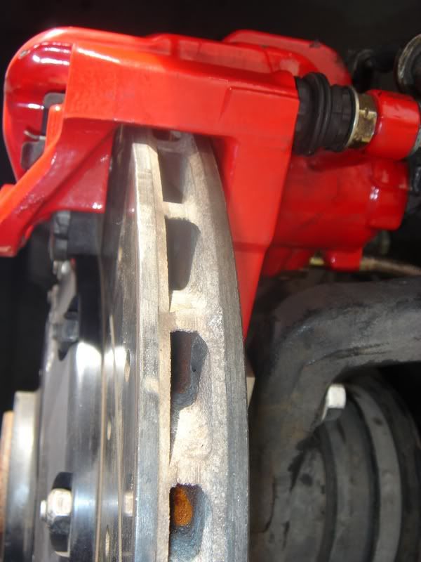

    Here are my 993 tt brakes. I'm now running rs4 wheels. I just recently replaced the rotors and pads and it wasnt cheap!
    A4-Full-race mani, HTA 30R, Built 2.0L, AEB head, 034 IIc, 3658's, ID1000's, JM fabrications, etc...

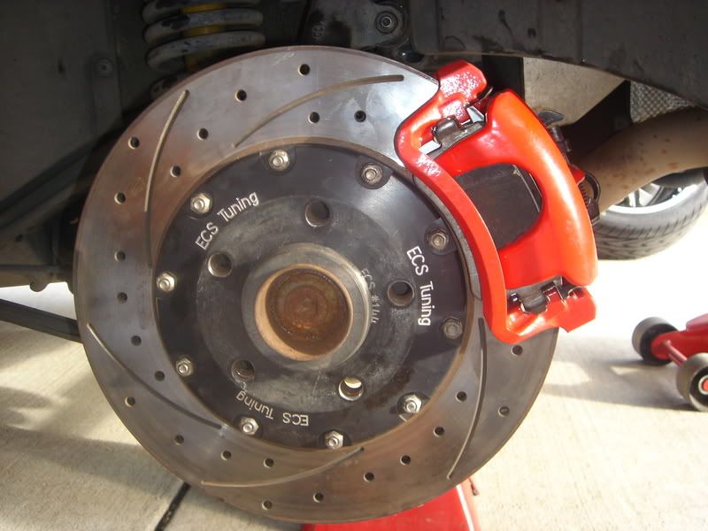

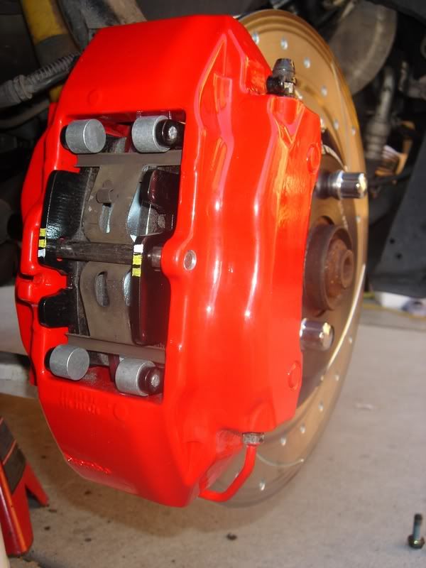

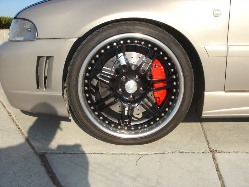

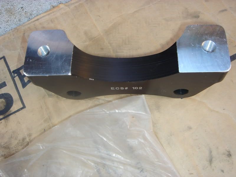

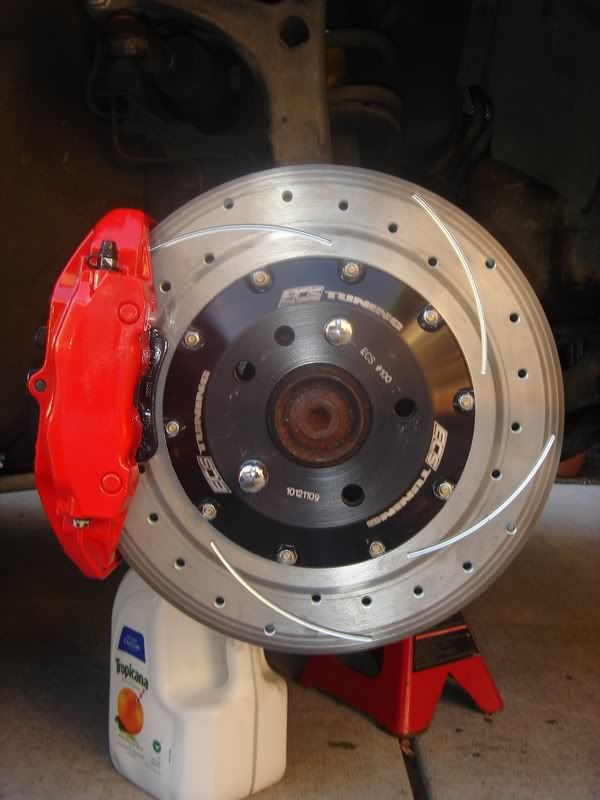

    Fronts: Porsche 911 Calipers & ECS Tuning S2 V2 Rotors w/ custom machined brackets
    Rears: ECS Tuning S4 Rotors & Calipers w/ custom billet adapters
    Installed:
