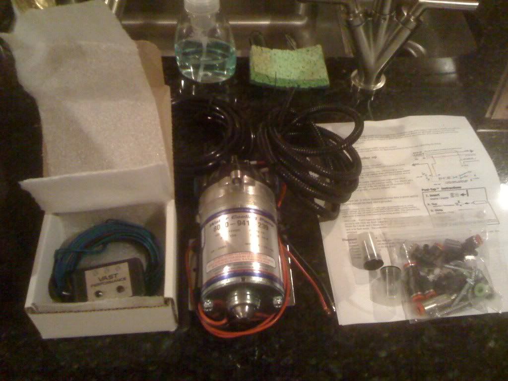

    DO Stage 2 doesn't come with a reservior -- I would think it would be much easier to just use the stock windshield washer tank since it holds about a gallon and already has a low level sensor. You should also get two nozzles.
    Here's VAST's kit (note the controller)
    Here's DO's controller:
    Direct link to their stage 2 kit: http://www.alcohol-injection.com/wat...tage-2-12.html

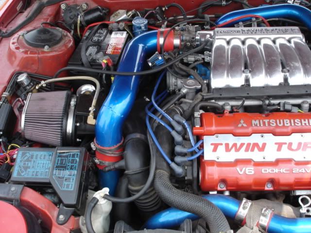

    Note how a 'real' W/M system looks
    This is on my 3000GT:

    How far from the tb should it be?
  19. #59
    Veteran Member Four Rings 1997gtx's Avatar
    Sep 14 2006
    11275
    14 GLI
    Re: how much power REALLY can i expect from a water injection kit?
    You want it pretty much as close to the engine as possible. The picture on my VR4 is about a perfect placement, IMO.
    --Adam
    Which one would you order? And how long would diy installation take? Is there any write ups on how to tune it yourself? (changing the timing and fuel with vag-com)
    *2 Bar Controller [5101]
    for engines with 2 bar map sensor $330.00 Quantity :
    *2.5 Bar Controller [5102]
    for engines with 2.5 bar map sensor $330.00 Quantity :
    *3 Bar Controller [5103]
    for engines with 3 bar map sensor $330.00 Quantity :
    *Voltage Controller [5104]
    0-5 Volt Input, most maff, tbs,egt, other map $330.00 Quantity :

    Quote Originally Posted by 1997gtx View Post
    It all depends upon your car, the nozzle you use, etc...
    For instance, I am running a perfect 50/50 W/M mixture on my 3000GT.
    It runs an 11gph nozzle -- which is huge. "Normal" kits (ie - suitable for the S4) would be in the 5gph or 7gph range.
    I have a Snow Variable controller on my car, which starts a light spray (40%) when i'm at 10psi. When the car is hitting 20+ psi, the nozzle is spraying at 100%.
    I have the kit (as it was made) to use the stock windshield wiper tank. You disconnect the hose that goes to the windshield wiper, and run a hose that pumps to a W/M pump (and computer) and then to a nozzle that taps directly into my intercooler pipe. When the fluid gets low, my lower washer fluid light goes on. Pretty easy.
    Even running around at 20+ psi, the tank lasts just as long as a normal tank of gas.
    I fill it up with a 50/50 mixture from regular windshield washer fluid.
    As a rule of thumb, 50/50 Water/Methanol injection will increase the octane rating of pump gas by 25% during injection.
    So, in theory ... if you're running 93 octane, and throw in a 50/50 mixture, you should see a bump in octane by about 20-23 -- or about 113octane ... (Please note I incorrectly typed 103 above).
    A W/M injection will lower your A/F ratio by at least a half point just to start, so if you are able to really tune the car, the A/F ratios and an adjustable nozzle, the possibilities are limitless.
    You literally could be running equivalent to 113 octane whenever you want.
    Also, please note that you should definately avoid mixtures that contain propylene glycol (anti-freeze). It's sometimes added to washer fluid to lower the temperature rating and is harmful to the engine if injected...so, make sure you check!
    Here are some methanol ratios of commonly available washer fluids per the manufactures MSDS:
    I would stick with Peak -25 degree windshield wiper fluid for the S4 ... At about 35% methanol, it should do the trick nicely for our cars -- it would be about a 17.5% octane boost and put your octane ratiing (with 93 in the tank) to around 109.
    Credits for some of the info goes to the guys on my 3000GT forum.
    Hope this helps.
    Cheers~
    --Adam
