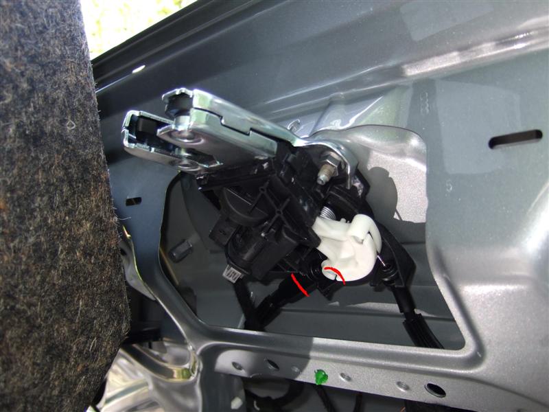

    John,
    I have most of the top part of the trunk carpet off. I am a little stuck on that emergency "trapped in the trunk" handle.
    To get it off completely, do I need to remove the black plastic part of the "RED" line in the photo? As well as the Silver end of the cable in the white plastic piece (also in RED)?
    It looks like that would work but that it would be a big PIA to get the carpetted piece back on (theres not much slack).
    Thanks,
    Rich

    Veteran Member Four Rings John1.8T's Avatar
    Jun 08 2005
    6814
    2005.5 Brilliant Black Audi A4 2.0T Quattro 6spd.
    Waterloo, Iowa
    Re: How do I get the carpet off of the trunk? 2008 A4
    to get the carpet liner off you are going to want to pop the cable off at the emergency handle. You should be able to pull it up and out a bit to see the cable and get at it with some needlesnose pliers.
    Are you planning on taking your trunk latch off? If so, its just 2 or 3 10mm (i think) bolts and the latch slides off the studs. the cables are easier to get off when you can move the latch around a bit.
