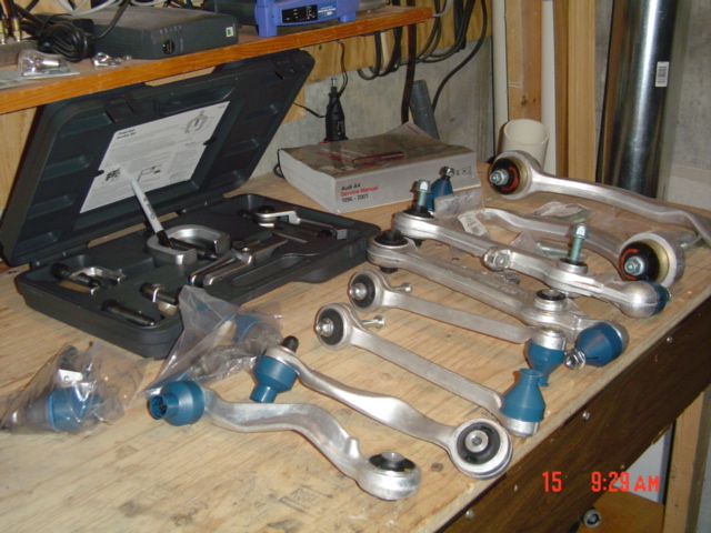

    My control arms are shot so I ordered the ECS kit along with a puller kit from JC Witney. I tried to tackle the job on Staturday but ran into a problem. I started with the driver side top control arm bolt and that thing would not budge at all. I hit it with a punch and used PB Blaster on it with no luck, that bolt must be frozen with all the snow and salt from winter. So without air tools I see no way to get that bolt out, so I stoped right there. So now I'm thinking I need a shop to install the control arms for me, anyone know how much in labor it will cost to do all the control arms on the front end of the car. Or better yet if anyone has a solution for getting that bolt loose, I'd rather do the job myself.

    If you are referring to the bolt that holds the upper arms to the wheel bearing housing, then yes, I know quite well how difficult it can be.
    My driver's side bolt was not moving at all. I had to soak it with PB Blaster and then cut the threaded end off. Then I used my Ingersol Rand air hammer on it for about 10mins straight. It moved very slowly, maybe 1mm per minute, then it suddenly shot out.
    The problem with the bolt was that it was bent in the middle. How it got that way, I'll never know.....
    I see you bought the whole puller set from JC Whitney. The close-pin style puller is the one to use.

    Just called the dealer, they told me about $275 to replace all eight control arms on the front end, with my parts, but they can't get me in for 2 weeks.
    So @ $65/hr I figure it's going to take a little over 4 hrs to do the job, does that seem about right.

    On a lift, yes.
    On your back in the driveway, much longer....
    My control arms took me all day to do them. It was a combo of several pesky bolts that wouldn't come off. PLus, the Bentley manual doesn't tell you that you have to loosen the whole engine cradle to remove the bolt that holds the rear lower control arm to the passenger side of the car. There are fuel lines there and you have to loosen the cradle, otherwise, you could crack the fuel lines...
