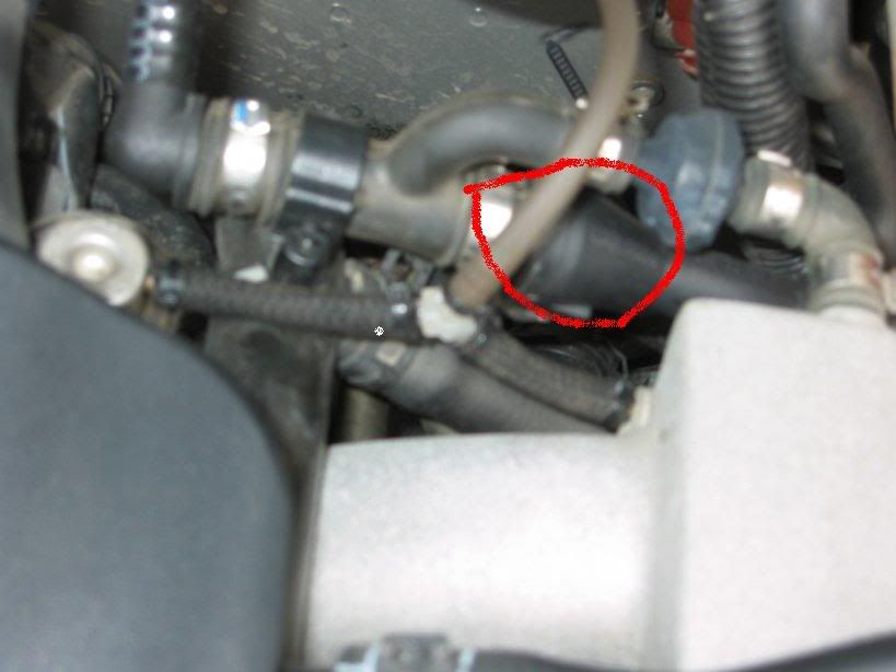

    Got a bit of a problem here.
    I was replacing a hose and this thing popped off.
    What connector is that? When it is not connected it causes the car to sound terrible, and idle like its about to stall out. I cannot get it back together to save my life, any suggestions. TIA

    I'm pretty sure that's the crankcase breather hose/valve. Basically, if it leaks, it's a vaccuum leak, and will cause a rough idle.
    Why can you not get it back together? Is the hose ripped, or is the clamp beat? If it's the clamp, just get a screw hose clamp. If it's the hose, go to the parts department at the dealer. I should be a cheap part.
    BTW - I would not tap that line for your boost gauge,especially if you're just using zip ties. They're prone to leaking, and it's the FPR is a bad place to have a leak since you may run lean.
    And I would replace the crappy braided vac lines. You can get the replacement lines for very cheap from most autoparts stores. It is 5/32 inch , or 3.5mm ID hose.

    Its looks like it is supposed to snap together. but i had trouble getting it to stay. so i put some silicone around it. then tied it with some metal wire. We'll see if it holds. When it is not connected there is a triangular shaped thing inside with a round orange thing, it looks as if its a nozzle of some sort? I think you are right though.
