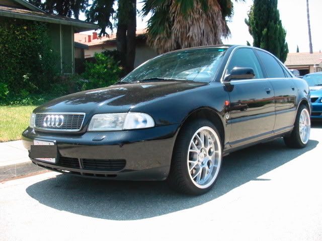

    Veteran Member Four Rings bong2611's Avatar
    133
    2000 A6 AVANT, 2004 MBZ ML350
    Newark, Ca.
    here are a couple pics of my ride before i installed the coil overs.
