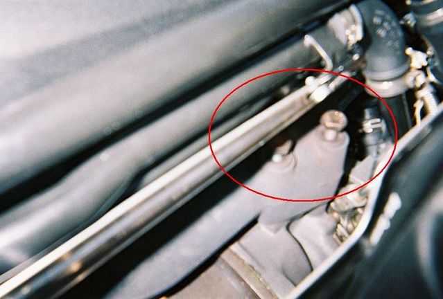

    Veteran Member Four Rings zemun2's Avatar
    Feb 20 2004
    749
    '04 A4 1.8t FWD APR Tuned
    Zemun, Serbia.
    Thumbs down
    Originally posted by imajn34
    I'm going K04 if it's as reliable as K03, if there is such a thing as a reliable turbo. I'd like to be able to drop in the turbo and forget about it in other words. Just like as if I purchased my car with the K03, of course, cooling down the engine and properly warming up the car, oil changes and what not. Would it be safe for me to go SK04 and still continue to have a turbo that's equally as reliable as the K04 and K03?
    This is my SK04, I also made 156 WHP with it.
