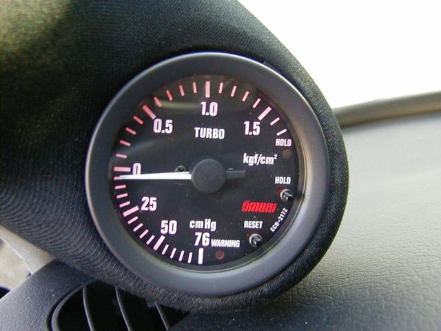

    Answer these and post pics please. We can make a nice gallery of many variations of installs in our cars. Links/where to buy stuff is cool too.
    Brand/model # of gauge:
    Mounting bracket/method:
    Parts needed to install:
    Any notes on install:
    Thanks....im in the market and I'm looking at Defi so hopefully someone will post up some pics :D

    Originally posted by dukez
    Is that CF center trim legit? A complete replacement, or just some stickered on cover? My OEM plastic center is cracked in two spots and i'd like to replace it. That CF center looks nice. Hopefully, whereeevr you gots it from has it for my year.
    Thanks
    It's real CF, but it's stick over...I bought it on ebay, but didn't install the whole kit. Didn't like how it would stick over the other panels. Just the center panel looked good. I'm going to try to make a CF replacement soon. I'll let you know how it turns out.
