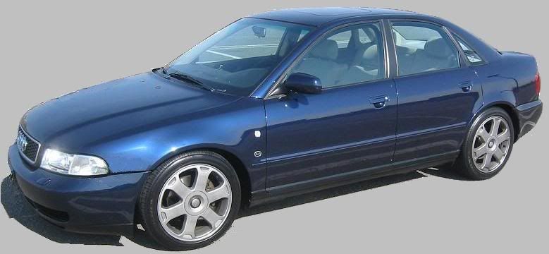

    Veteran Member Four Rings DRA4's Avatar
    Feb 12 2004
    358
    B5 S4
    Well i have Apex race springs with Bilstein sport shocks, and i have S4 rims, look at the pic for the outcome.

    Feb 13 2004
    400
    <> Posts: 9913
    Here's a pic of mine. I have Neuspeed race with the Neuspeed Bilsteins.
    If you want to tuck your wheels, then you'll need coilovers. And you'll need a camber kit, otherwise you'll never get close to an acceptable alignment to save your tires.
