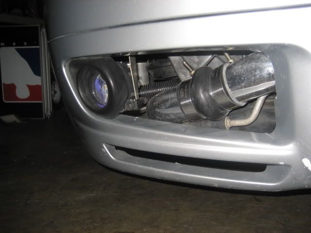

    How did you mount the fog lights and what does the SAI pump look like when mounted right?

    You can u still mount the fog lights with FMIC installed?
    never seen that done before.

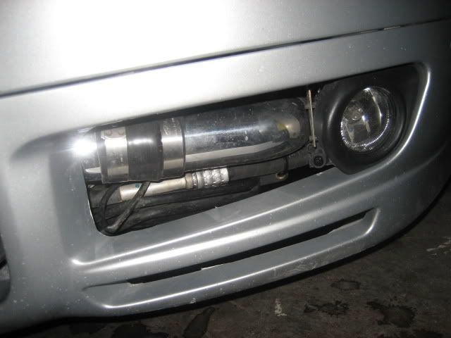

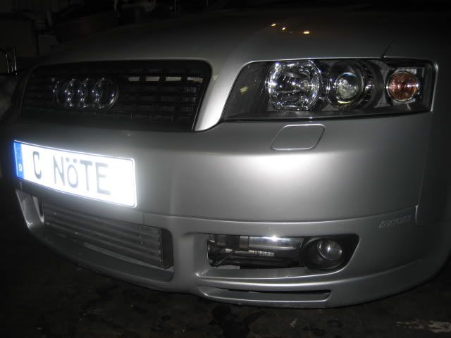

    Quote Originally Posted by favianjanitra View Post
    Yup. My fogs are still mounted with my ER Comp

    Re: ER Comp Guys...
    Still have mine, stock bumper too!
    What bumper are you using, if you are using the OEM bumper like mine you will have some issues most likely w/ the driver side fog but no cutting needed

    Re: ER Comp Guys...
    Oh yeah, as for the smog, thats a bish, just try to get it back in there sitting at the same position as before, otherwise you'll hear the pump turn on and off during startup.

    Re: ER Comp Guys...
    Haha I meant horns !

    Re: ER Comp Guys...
    Horns weren't a problem either. Just use the brackets that are included with the kit. You might have to move them around a little bit but the will fit.

    Re: ER Comp Guys...
    i thought all the OEM stuff was supposed to fit in place like normal... maybe take a little work but thats supposed to be a big deal with ER, and part of why their stuff is so high priced... everything fits!

    Re: ER Comp Guys...
    Everything does fit, who said anything doesnt fit? Horns go back in the original place but are now held in place w/ the long flat gray brackets, the smog pump is a pain but it does fit w/ the bracket included by ER, and the fogs fit, you just have to adjust the intercooler hoses till they fit, then come back and tighten down the driver side piping.
