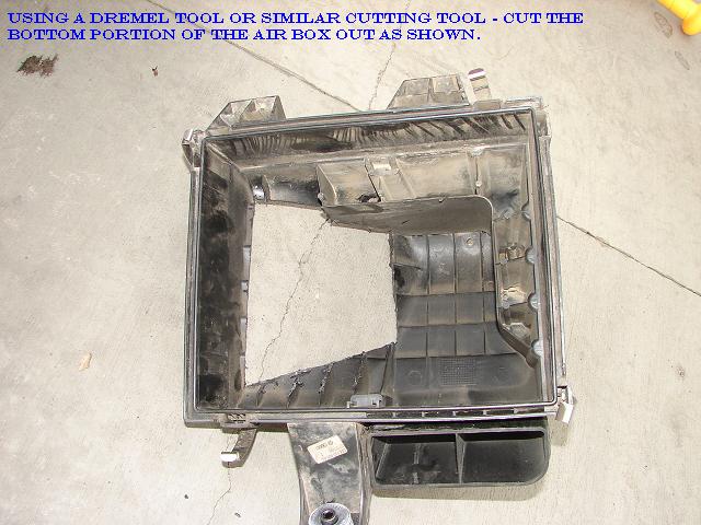

(If there is technical difficulties with the images here are the directions - With the lower part of the air box out of the car you can see were the fender well lining is at. If you place the box back into the car you will notice how the fender well and air box meet perfectly at the contour of the fender. This is were you will cut your air box. Use a dremel tool or similar to modify it like below. (Wear safety Glasses while cutting the air box section)

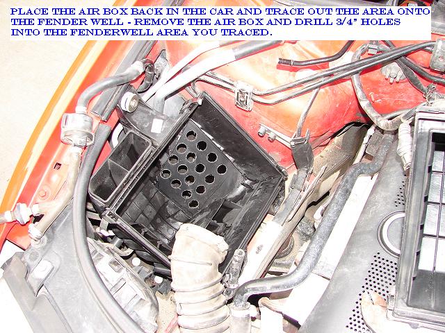

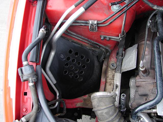

Now after you have cut out the section of your lower air box, fit it up into the car and use a marker to trace out the area onto the fender well. Then i chose to use a 3/4" Bit to drill holes. Take the box back out of the car and now drill a bunch of holes into the fender well inside the area you traced.
Now fit up your lower air box into the car and you should have something similar to the image below
