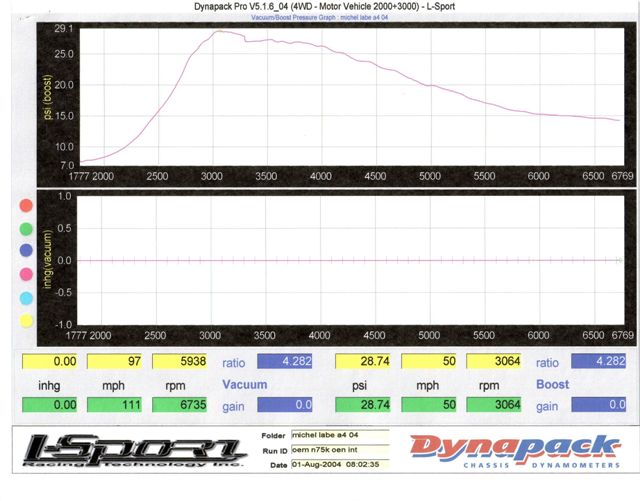

    Finally here are some of those dyno plots...
    Many thanks to Horchaus in Montreal and also to Luc and Claude at L-Sport.
    Conditions under which these runs were made: 94 Octane, no water misters, outside air temperature in the low to mid 80F.
    This was the first run of the day. After the car was warmed up we did one pull to make sure everything was OK. This also had the effect to warm up the car further to get more real world numbers.
    In this run the car was equipped with the standard OEM N 75 valve for a 2004 car. Furthermore the stock OEM rubber turbo inlet pipe was used. Temperature inside the dyno room was
    87.6 F.
    Now for the boost plot, peak boost was 23.09 psi.
    Next was a pull done with the N 75-K valve but we left the stock OEM rubber turbo inlet pipe on the car. Now the temperature had risen to 91.1 F.
    Now for the boost plot, peak boost was 28.74 psi.
    [IMG] [/IMG]
    Finally we proceeded to change the stock OEM rubber turbo inlet pipe by the newly modified custom stainless steel turbo inlet pipe.
    Again on this pull the N 75-K valve was retained. Now before I go on to the graphs, we had a technical brain fart from the computer running the dyno. As we tried to do the pull which was followed by several others, the machine's rear mechanisism would not allow the car to accelerate normally. So the computer was shut down twice and rebooted. Needless to say the car and especially the air intake (I/Cs) got really hot and heat soaked. So we feel these numbers could have been higher. I intend to go back soon and do a more normal run with these same components on the car to get a better feel for their numbers. BTW, the temperature inside the dyno room had now climbed to 99.5 F and we saw intake air temperatures in excess of 70 C during the run!
    Now for the boost plot, peak boost was 29.12 psi.
    In conclusion which may not be easily seen on these graphs is that the custom pipe will give you more torque, Hp and boost sooner in you RPM range. In other words the engine response time is faster and better. The N75-K valve is definitely more aggressive and will take the MTM Stage 3, 1.35 bar chip (20 psi) up to 29.90 psi (seen on one run) and stabilise it between 25 psi at 3300 RPM down to 15 psi around 6000 RPM. I'm not sure if I want to keep this valve on the car and risk burning up the K04. I will talk to MTM in Germany and get an opinion from them. I decide at this time to keep it on the car while we do a shake down of the inlet pipe for a couple of weeks. Maybe the software and N 75-K valve have to adapt to each other. In the mean time I will take it easy, unless I race the car again... in two weeks.

    very very nice. Its nice to see how hard you worked to get us all this data. It is very much appreciated!

    Those are nice numbers but 29 psi might be a bit too much for K04

    wow 29 psi. awesome numbers. can the K04 handle that much?
    this is excellent information, thanks again jet for sharing.

    Yes it might be. I'll see what MTM says. But talking to Luc at L-Sport, he seems to say it is just peaking and coming back down below 25 psi and that may be well be in the safe zone.

    29psi? Can you say bye bye k04? Good numbers nonetheless, although I would like to see a smoother power curve. Thanks for sharing with us.

    Very impressive indeed the second dyno is my favorite as it’s the smoothest in my opinion based on the power delivery and the boost behavior. The last run with the inlet pipe modified is the highest as far as max HP & TQ are concerned but by no means an improvement in the power deliver IMHO. The car seems to be running healthy and making good power you have a well balanced vehicle as long as you don’t expect it to make this power consistently at those boost levels. I would recommend running the car back to back for 3-4 runs to see exactly how much would be lost so you have a better idea of what the car is capable of constantly if you have already done so great please share.
    Also are these numbers at the hub of the actual wheel of the car? If at the hub how much do you feel would be lost to the actual wheel on a dyno with rollers?

    VERY nice numbers. Now I would like to see what the SK04 and E05 (both which "should" have more potential than the K04) can make with some good tuning. Good job man!

    Although those plots may look nice, without a A/F curve you don't really know what is going on with the car.
    AFR and EGTs may as well sky rocketed and that may lead to some SERIOUS engine damage (what happend to my friend's, MTM Stage 3 equipped, brand new Audi TT).
    So just to be safe, I would recommend dynoing the car on a LOAD dyno and getting the vital AFR and EGT readings.
    BTW - any pics of that inlet pipe ?

    whats the air fuel look like when the boost spike hits?
    1.8ts seem to go real lean when the boost first hits...

    Thanks David,
    Believe me we did a lot of back to back runs and the Hp and Torque levels are very similar +/- 5 Hp/torque at the most when heat soaked.
    The last run which consisted of the custom inlet pipe and N 75-K valve was by far the run under the worst conditions and we ran out of time to let the car cool down to where I think it would have been in a more normal temperature range, so I see this run as not really been a good run. I will go back to do a run with the same components under better conditions. We must have had at least 5 aborted runs before we got that one run in. The dyno room's temperature of 101 F says it all. Only after opening the doors did we get it down to 99.5F before that last run. The two I/Cs were heavily heat soaked with intake temperature above 70 C in that run as seen on the VAG-COM.
    The custom inlet pipe as proven to be well worth the effort. I have all the digital data printed out at home. It shows that the pipe with and without the N 75-K valve provides better, smoother and faster engine acceleration. Boost, torque and HP come in ealier in the runs. It also shows that with less boost it produces more Hp and torque. As an example (fictious) let say that with the stock pipe at 3000 RPM I get 15.0 psi, 150 Hp and 200 ft/lbs of torque under the same conditions with the custom pipe these same figures would be produced perhaps at 200 RPM lower or at 2800 RPM.
    As for the dyno types it seems everyone as their opinions and I'm not an expert so it would not be fair for me to engage in that debate.
    I did log all the runs on the VAG-COM but could not retrieve the info last night and I hope they are still in the computer somewhere. In the next few day, I will try to access them.
    Mike

    Like I just said above to David on the dyno thing, everyone as their opinions. The HUB dyno can put more load on the car than you think. When we had those 5 aborted runs, the dyno's computer was having brain farts. It was putting so much force (torque) on the rear wheels that the car was being actually braked by the dyno. It as a lot more torque available to it then your car will ever have.
    On your AFR and EGT readings, I did log with a VAG-COM the lambda values, the timing and I believe the MAF (mg/sec) but I forgot to get an EGT log. Hopefully I will be able to retrieve those logs. What I recall seeing on the Lambda scale leads me to believe if anything the car was running on the rich side with all figures in the negative range. On the MAF side it went all the way up into the 180s. On the timing, I'm sure under these conditions (heat) it was been pulled back. I saw the scale between 5 to 10 with a few moments at 12 and even above 15 but settled right back down between 7 and 10 IIRC. Hope I can get access to those log file somehow.
    The torque you are talking about in nowhere near the forces that are generated by a LOAD dyno. Load dynos use special electrical engines for braking (those are HUGE) - not only relay on the sole mass of the rollers as inertial dynos do.
    I hope that MTM is right this time and you will not be a part of the horror stories that a friend of mine went through with his MTM equipped Audi TT.
    IMO the B6 ECU's are more idiot proof to strat with, since they relay on lambda readings all the way from part throttle up to the WOT.

    Jet Jockey and I have both taken extensive data logs on lambda and g/s. I, myself logged all my dyno pulls plus the entire 4 hour trip to the shop reaching at several points during the trip 140mph speeds at over 6000rpms (this was in the middle of the state in alligator alley). Lambda readings were always between -5 and +5 with most readings between 0 and 3. This represents some awesome readings that many other tuners have been surprised by. cheers! Mike

    Thanks David,
    Mike
