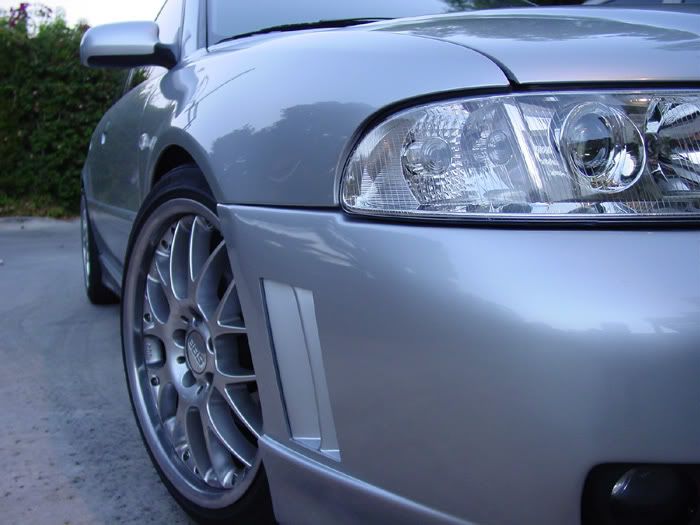

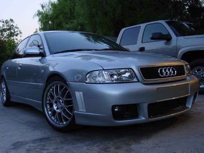

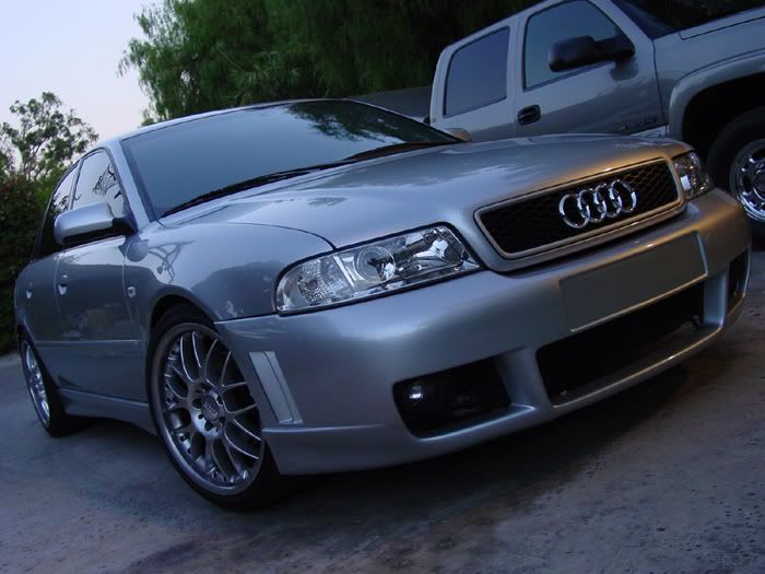

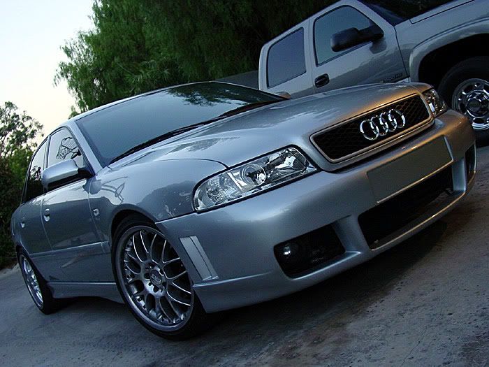

    Intrax ARS coilovers... the rear didnt drop as low as i wanted, so im deciding whether or not to buy new rear springs to drop it lower in the back. from ground to fender in the front i am 25.25" and the rear is 25.5". here are the pics...
    front wheel gap..
    rear wheel gap...
    thats it. only problem now is deciding if i should buy new rear springs to drop it more or not.. i dont really want to spend any more money, so its gonna be a hard decision.

    I have the same coilovers. I cut the rear springs so that I could lower the rear more. The front springs are progressive while the rear springs are linear, so cutting a coil doesn't affect the spring rate. If you get new rear springs from Intrax, they'll just be shorter anyway. I had my car at 24" front and rear, I raised it to 24.5" front, 25" rear yesterday.

    your car looks A G G R E S S I V E! I wouldn't want that thing behind me on the road. Nice clean car!

    not makin fun.. you have the same gap as i do with those coilovers.. i think my 18s close the gap some though, cause im 25.5 in the rear and 25.25 in the front. its 1.5 fingers in the front and about 2 in the rear.

    Really that's all it dropped? I would have thought alot more, but it still looks good.

    it would have dropped it more on any other car but nicks car is bigfoot. hehe just messin nick looks good man long time coming.

    finaly lowered now nick....... nicely done and trust me when i say your car does not need to be lowered more in the rear, i keep raising mine up because of rubbing issues with passengers. also if you like the rear bumper on your car i suggest you leave it ALONE. it will scrape everything

    the bad thing is, you can't really go too low with those wheels unless you roll the fronts. in which case, you better have tight suspension up front. i had koni/intrax on my b5 with those wheels and i would rub going into corners and i had a little over 2 finger gap up front. i think my setup was too soft for aggressive driving.

    yea, i know what you mean. i already had my front fenders trimmed, so hopefully i wont be rubbing.
    nismosx- yea, i was thinkin the same thing, the rear is really low as it is, i'd probably lose it if i went lower. i gotta think about it, i kinda like the height its at now.

    Looks good. Better to have the rear a bit higher
