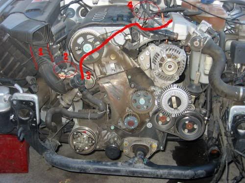

    i just chnged my BPV last week, but i guess i need to check all the hoses. anyone wanna do a quick PS of an engine pic to show me which hoses to be lookin for? i'm kinda a newb to workin on the engine myself

    It sounds like you hit limp mode. Usually if you shut off the car for a bit, then restart, it will often go away.
    Here's a crappy pic, but here's the basics to check for suspected leaks.
    1. Hose from air filter.
    2. N75 valve (has to small vac lines coming out of it).
    3. BPV line. Runs up to the intake manifold. Also check the two larger diameter hoses connecting to the BPV.
    4. FPR line.
    NOTE: This is for my '97. Later models have the BPV in a lower spot, which would be in the lower left corner in the pic.
