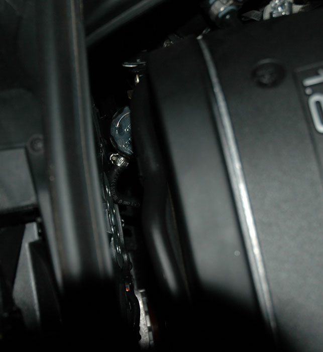

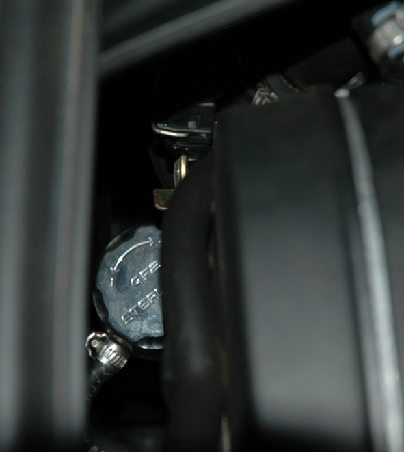

    OK, I just went outside to take some pics. I dont have much light till tomorrow so just deal with these.
    They were taken at the top of the engine bay with the front of the car to the left. With that information, you can make out the orientation of the bov.
    Looking at your diagram again and then my pictures, I think the main reason Im not having problems is because I have the STEALTH hybrid. The extra adjustability helps me get the woosh, not get cel's, and not loose any power. That might explain a lot here.

    check out what GFB has been sayin...
    email 1:
    "Hi Eric,
    That is an unusual problem. The reverse orientation is correct, as you
    have
    noticed in the OEM position it does not blow off. Are you losing boost
    pressure when accelerating? Have you tried plugging off the trumpet
    with the
    black screw-in plug supplied? Have you tried adjusting the spring
    pre-load?
    If the answer to either of these questions is no, I would suggest
    trying
    them both. Tighten the vacuum nipple on the top until it stops, see if
    that
    fixes it. Let me know how it goes."
    email 2:
    "Hi Eric,
    By adjusting the spring pre-load I meant tightening the adjustment. If the
    valve is too tight, you'll hear significant fluttering, like when it is
    installed the OEM way. You may still hear a little at low RPM, but that is
    not uncommon. The adjustment is not there to compensate for different boost,
    it is there to accommodate different car characteristics. If yours runs
    better with it tight, then that's the way to do it.
    I'm not sure if the CVT places any other demands on the diverter that are
    not found in auto/manual models, but there is one other thing to try if the
    spring adjustment does not cure the problem. The vacuum hose that goes to
    the top of the valve, is usually connected to a complex solenoid/reservoir
    set-up, which the ECU controls. The ECU therefore has the power to open the
    diverter under load, which is not what you want. SEAT owners in Europe
    sometimes find this occurring, and the best fix is to block the factory
    vacuum hose where it would connect to the diverter, then run a single vacuum
    hose from the manifold to the Hybrid. This will prevent any chance of ECU
    intervention, and keep the boost where it is supposed to be."
    what you guys think?

    have you tried installing opposite of the Dv with the adjustment at it's tightest?
    I miss my wagon...
    Veteran Member Four Rings fongaroos's Avatar
    Feb 12 2004
    303
    cali
    im gonna try installing it REVERSED OF OEM with the spring tension at the highest... see what happens.
    we did it once... but i remember there still being some loss of performance... and the CEL was still there.
    the CEL only went away when i turned it to the REGULAR OEM ORIENTATION... (vac line pointed towards passengers side)

    im trying to work it out so that i can tune it RIGHT! but ultimately if i cant get it to work right... then im just gonna end up selling the valve and getting a forge again...
    but like i said... if i can get it to work thatll be great cuz the sound is just so irresistable...

    anyone know anything about this? is it true that the ECU controls the vac line? i always thought that the DV was activated by a purely physical mechanism... not an electrical solenoid...
    to my understanding... when you let off the throttle the pressure in the intake manifold drops and this in turn creates vacuum in the DV and affects the DV in 2 ways. 1) it allows the charged air to PUSH the piston up and thus vent to atmosphere or get rerouted into the intake tract, and also 2) the vacuum pressure in the vac line actually SUCKS or PULLS the piston up to release the pressure...
    is this correct?
