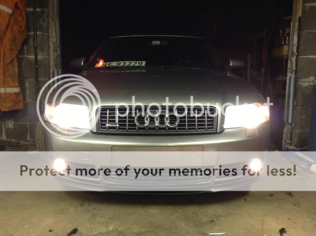

    Some final pictures of my B6 before it is sold this weekend and delivered to its new owner. I chopped up an S4 lower and mounted it into the stock lower grille frame by drilling holse and just zip-tying it together.
